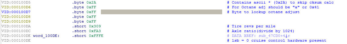

This is what I believe is in the VID block:

Thanks for the reply.rmrmd1956 wrote:This is what I believe is in the VID block:
How did you determine the octane adj?
My ecu bin has that set but every other bin file i've looked at doesn't?
Ive tried changing the bits you said for 0x000100DE ;100DF. Most I've looked at have FF 00 for that.
I tried FF 01 and FF FE like your example and neither enabled cruise.
I'm wondering what 0x000100D9 is for? I noticed it is different amongst bin files. I've seen 6F on BA's, C8 on my BF ecu?
I did notice the checksum error DTC after I was fiddling with the VID block with hex workshop.
Next I need to figure out how to manually calculate the new checksum.
