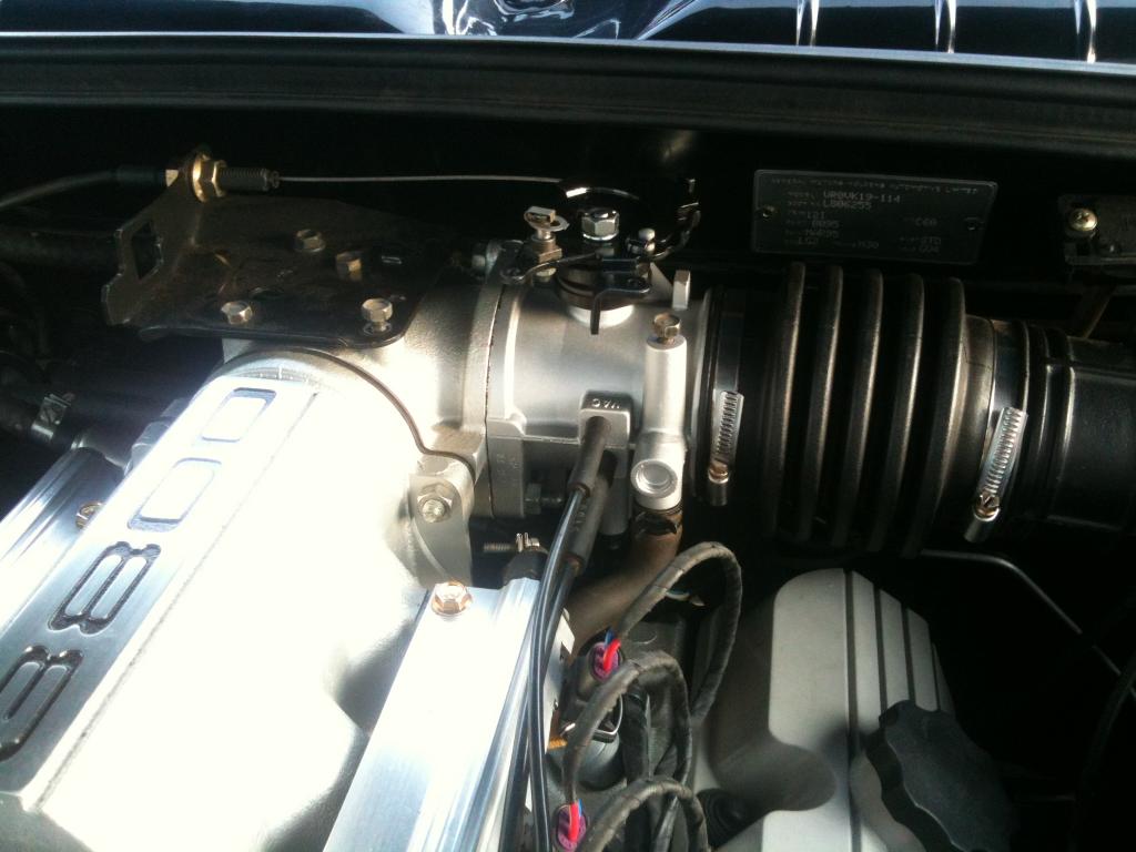

Have fitted the larger TB, just need to modify a cruise control bracket to clearnt he actuator. The way the v8 one is case means I cant fit a v6 actuator on it.
just a minor inconvenience really.
The results showed that there was a slight improvement in air flow but majority restriction still exists so its certainly the air intake. Should get my mace CAI soon to fix that.
Few more logs playing with the ignition as delco suggested I still found the timing less than what I set, I see I forgot to clear the 98ºC row in the spark advance vs coolant term (subtraction term)
Kinda stupid to have the timing retarded when thats the normal operating temps
Anyway, got what I wanted there and it does go better. best time now is 8.58 sec 0-100.
oh yeah and bigger TB has helps heaps with drivability.

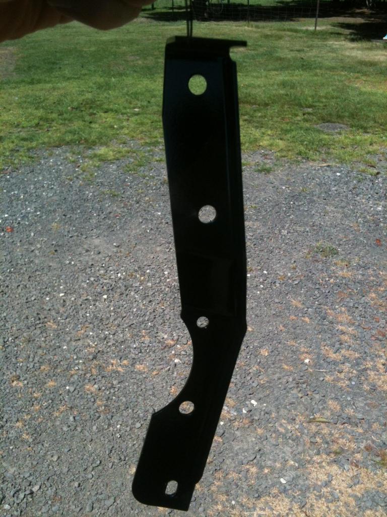

nice and clean looking.
here is the modded bracket anyway.
I ground that by hand, looks like it was machined on a mill.
painted, waiting til tomorrow for the paint to harden.
