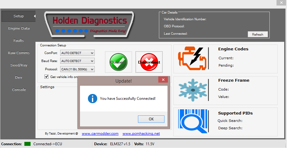

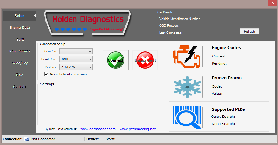

Bit of a redesign for the main screen. Appeals alot more to me.
Can get a quick brief overview of the car status on initial startup (once its all implemented :thumbup: )
Still got a bit of room for extra settings, not sure what to fit in there. Was thinking maybe just a simple user choice for "basic", "amateur" and "professional" settings. So things like header changes (automatic now), CAN error formatting, pid lists?
Am also looking to remove the "Dev" tab, as Im spending more time modifying the code for each use rather than a "one size fits all" solution. Eh.. dunnoo.. the alternative is to apply a simply plugin system so all settings can be modified systematically and user customizable.
Will definitely keep the seed/key searcher. Will greatly appreciate anyone/everyone testing when I get the next version out.
cool interface!
the 'holden diagnostic" logo at the top does my eyes in though lol. red and blue together are really hard to focus the eyes.
yeah screen looking good :)

vlad01 wrote:cool interface!
Yeah agreed, Ill try another color :thumbup:

logo is still using red writing.. but much darker. Is there still conflicts? Can dull the blue if that might help.
I tried orange.. and felt that I had burnt holes into my eyes staring at that. All black was..plain and dull. A mellow green was ok, but Im preferring the red
On successful connection with elm, it will automatically (by default) grab some basic information including VIN, current protocol, last logged in. And then will do a quick fault code scan, freeze frame scan and PID search.
The PID search is still only pseudo code.. Im yet to full test out my theory. But GM docos explain that a DPID that is loaded up wit PIDS that requires a return frame greater then the allowed 7bytes will result in an error. Soooo Im counting on this to determine valid PIDS for CAN protocol. VPW is piss easy to determine this.
Will also have to add some sort of progressbar at the bottom to show setup progress.. as all of the above actions will take a little time (mainly just the PID search)
