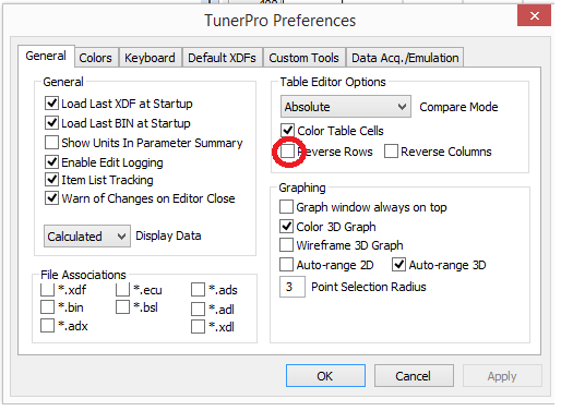

Post by Jayme »
tunerpro reverse rows.png (16.14 KiB) Viewed 3098 times
heff0018
Posts: 1045
Re: 265 Hemi to efi
Post by heff0018 »
Thanks very much

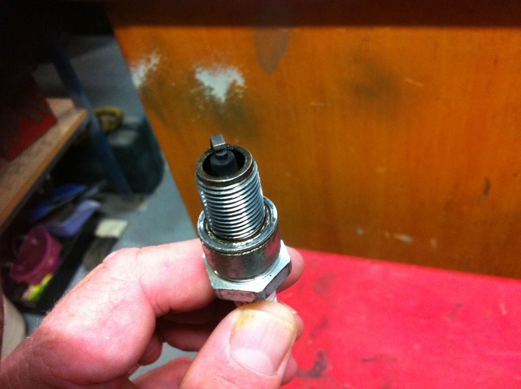

wideband looks to be working well. How's it sound and smell now compared to earlier on?
Post some pics of the plug ends.

Thanks Dylan. sounds good, not smelling of over richness and plugs are fine. Might be different under load though.
I am currently putting the fuel tank back in place, including all the filler tube panels that were cut and shut by the previous owner. Undoing a lot of the former owners crap work has been a bit of a mission.
I will post some pics of the plugs soon. Cheers

Heres a pic of a plug, they are all the same as this
