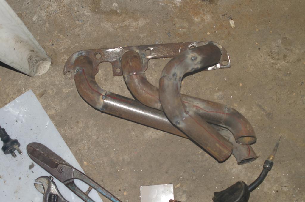

teaser pic .does it fit in a commodore? no idea and i dont give a rats arse looks cool LOL
Posts: 5630
Re: DELCOS NEW RIDE

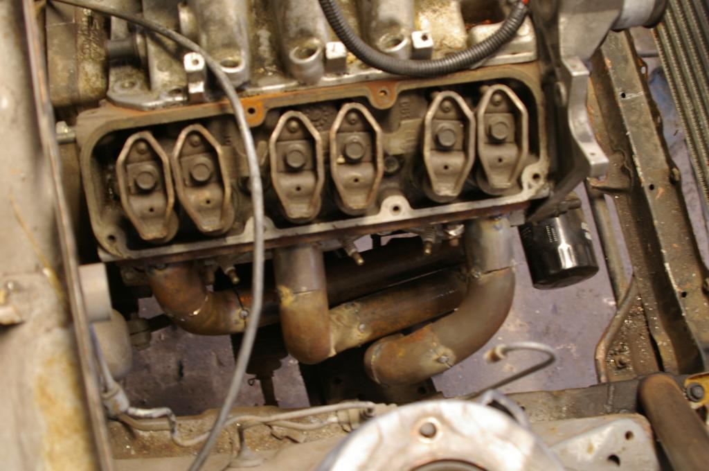

doesnt look as nice as i wanted but it will do
Re: DELCOS NEW RIDE
so i assume thats going into a collector and then over the other side of the motor under the front ?
and yeah i reckon it wont fit the commodore chassis rails :P
Re: DELCOS NEW RIDE
nup, no way that will fit a commodore.

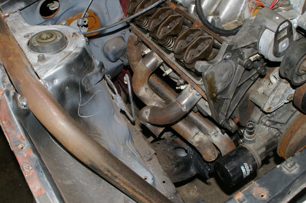

Posts: 3676
Re: DELCOS NEW RIDE
Looks like you need a remote oil filter so you have lots of room for the merge pipe for the collectors.
Re: DELCOS NEW RIDE
i'd merge it where the front pipe ends and then have one pipe going behind the oil pump!
Posts: 5630
Re: DELCOS NEW RIDE

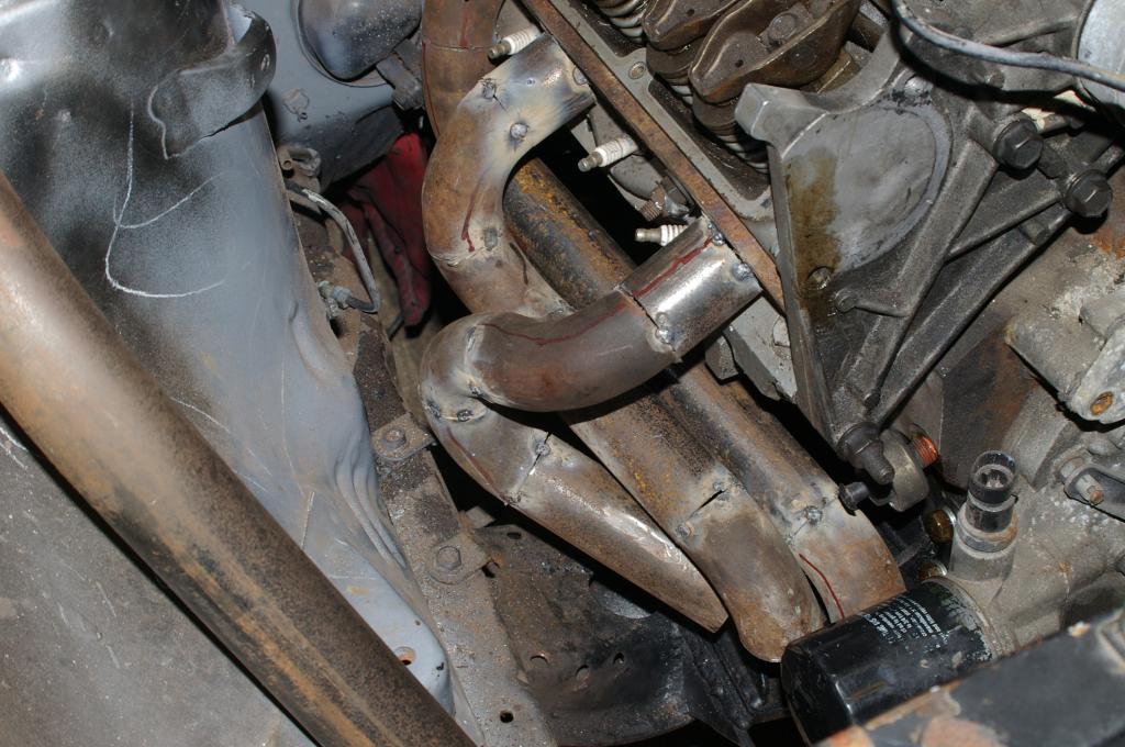

im trying to get each pipe to 38"s long and want pretty short secondarys into the turbo so it has to go down and under the balancer as 3 pipes with the collector just on the other side of the balancer. by the time all 3 pipes are horizontal after going under the oil filter adaptor they will be exactly the same length ready to add on 3 straight lengths to my collector

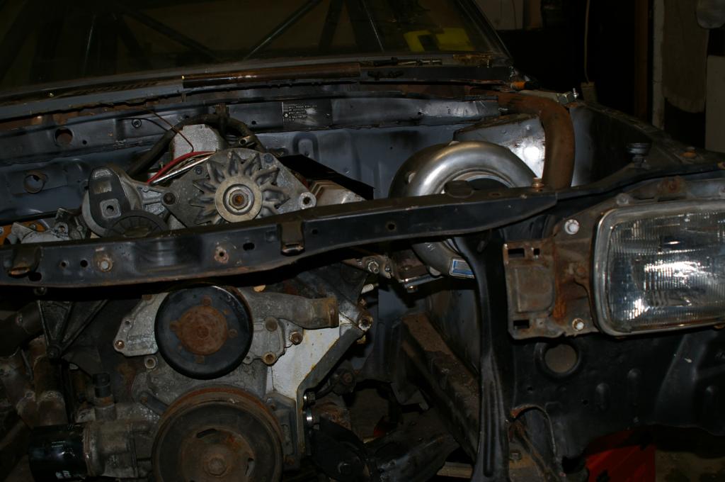

more pics wasnt happy with angle of front pipe so it got changed a bit

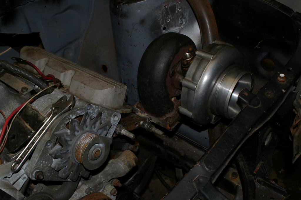

turbo and flange on a bracket so i can build upto it
