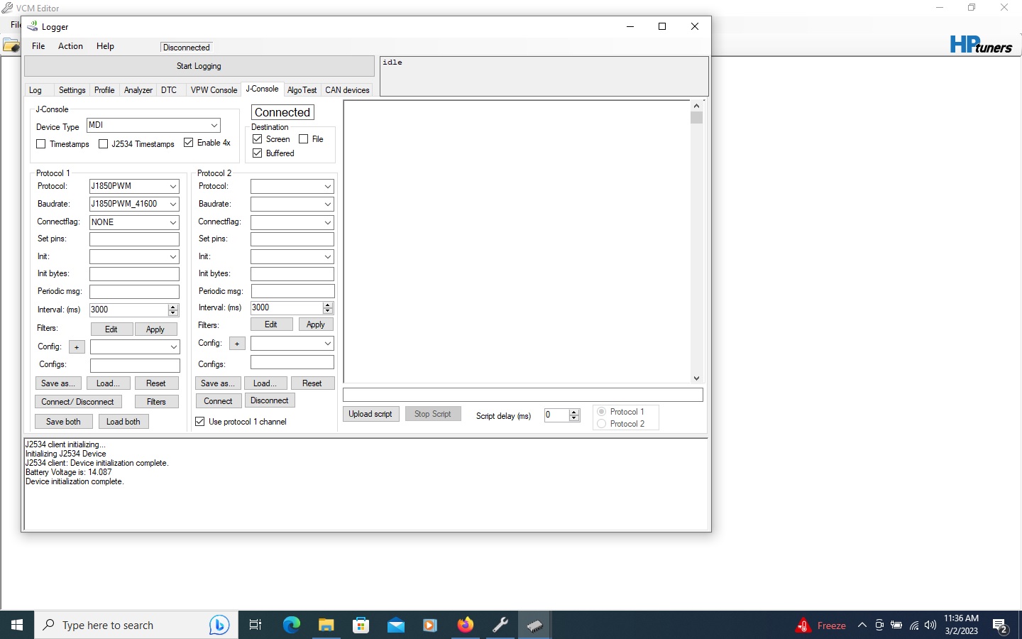

In-Tech wrote:kur4o, Is there a particular environment better than another. I have winXP, 7, and 10. The win10 is used for gm SPS when I have to. Does the MDI need a particular version of the "wrapper"? I am up to date on the win10 'puter, not sure what I would have to do on the others. Sorry for boring questions. Your software looks way cool. Thanks for the screenshots :) Mine is an original MDI(not a clone) and not an MDI2.
It will work with anything from xp to win11, any wrapper. Also from drop down list of device you can select any tool you have installed on that PC.
Usually when a tool is selected it will list all available protocols that are supported in the dropdown menu of protocol.
