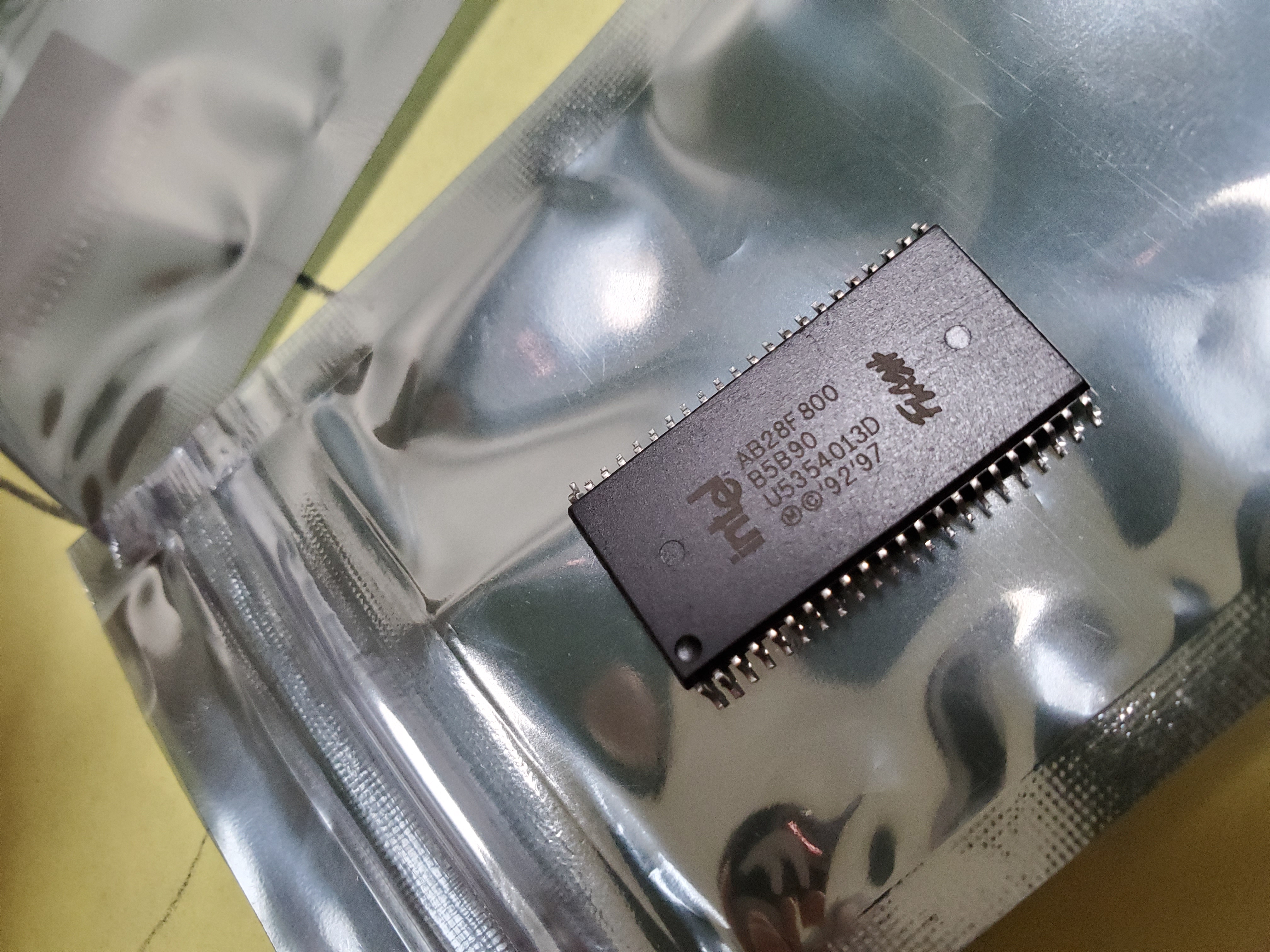

Post by I420tom »
Anybody have a use for these two spare intel ab28f800 flash chips I have? Should be a direct replacement for the p59 intel
