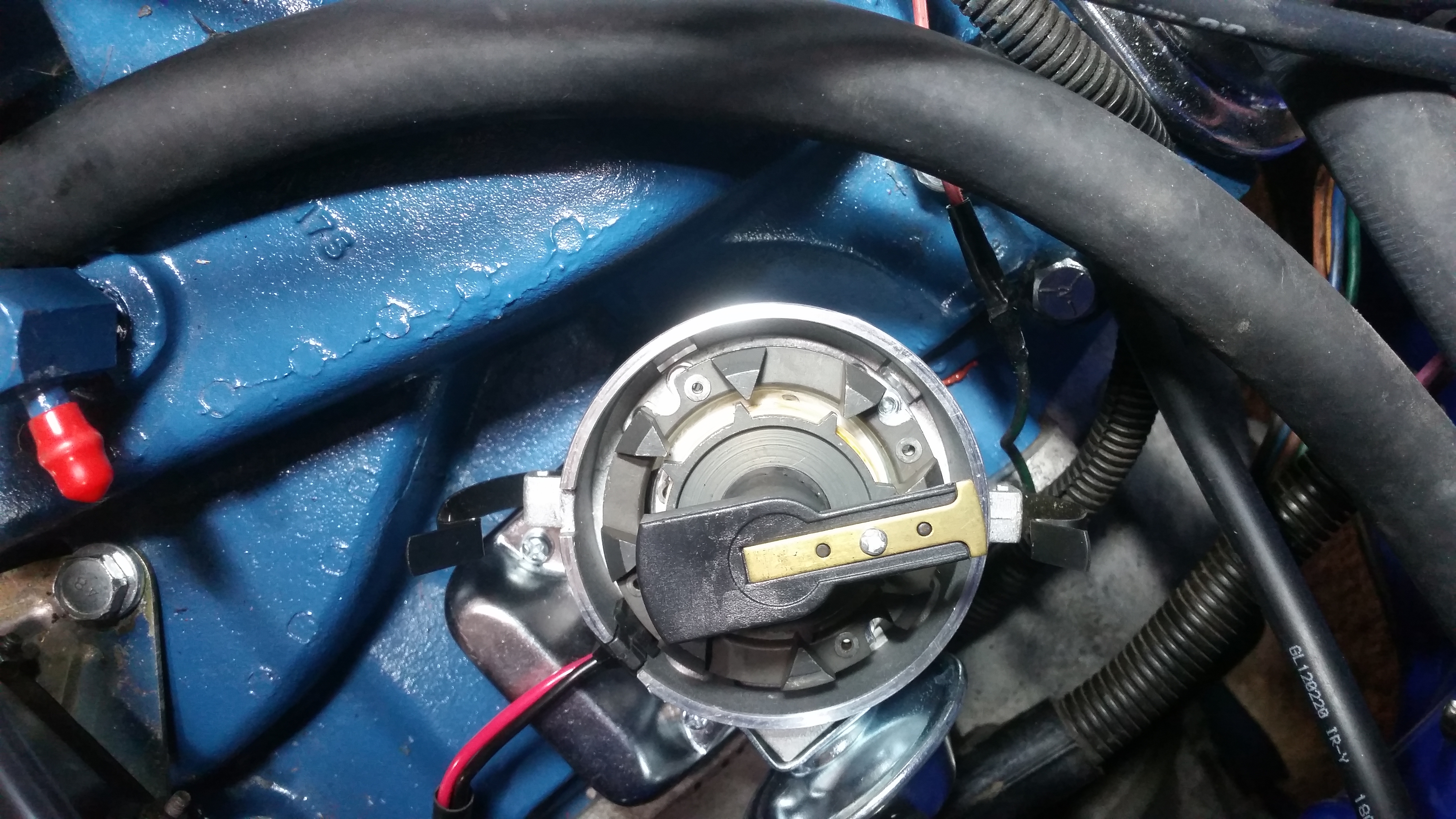

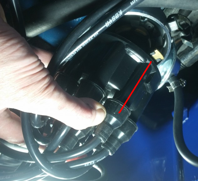

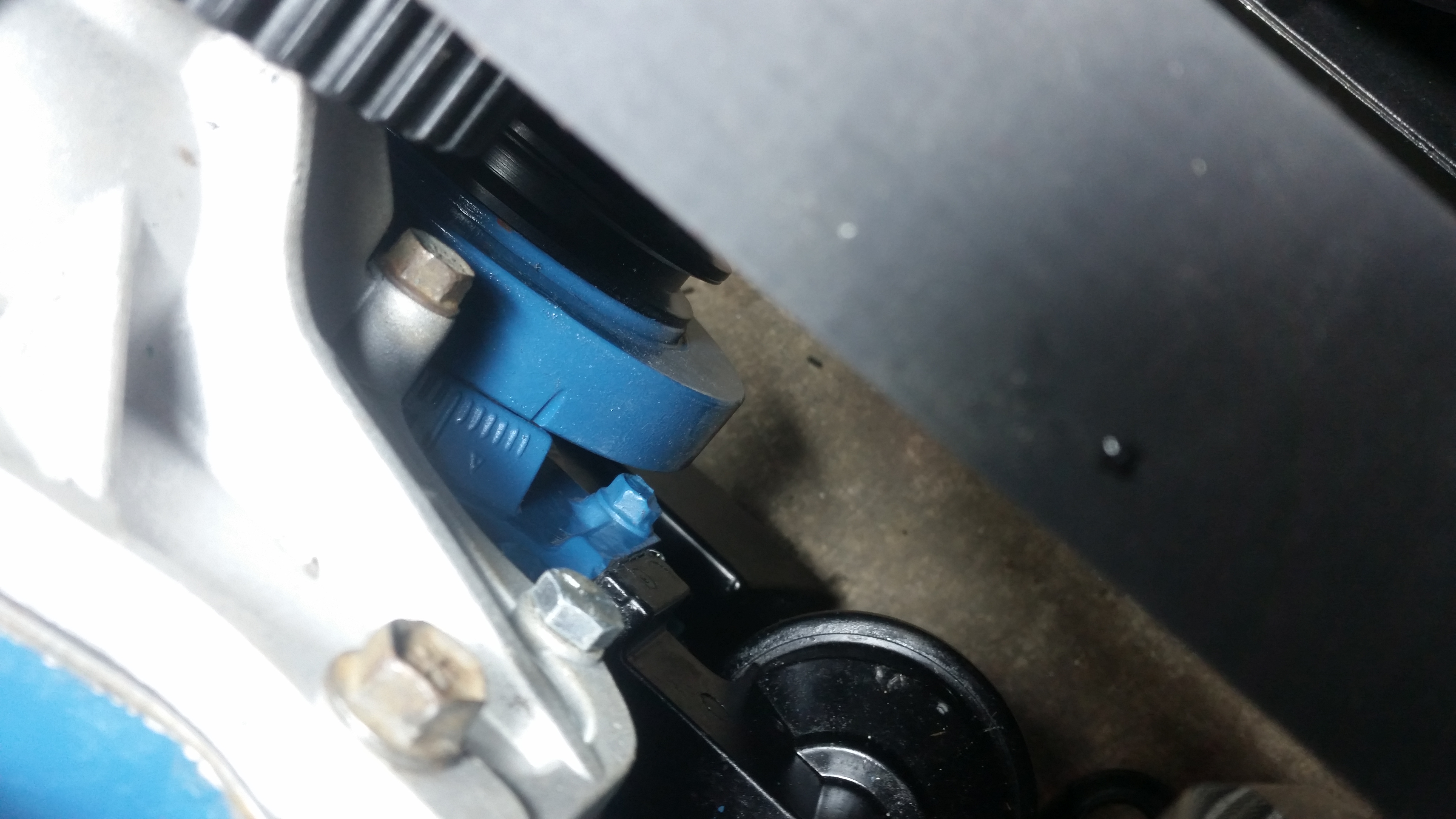

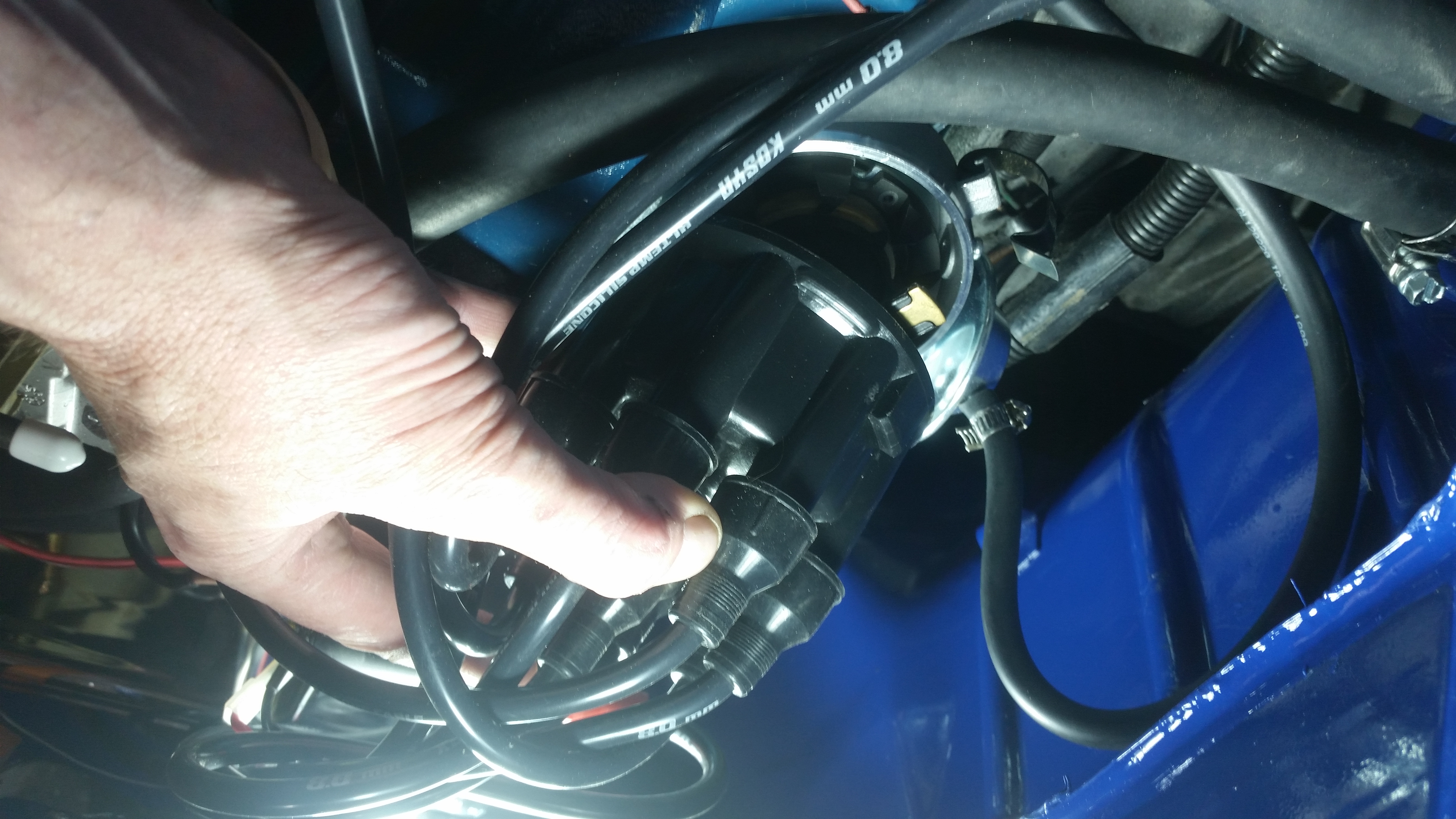

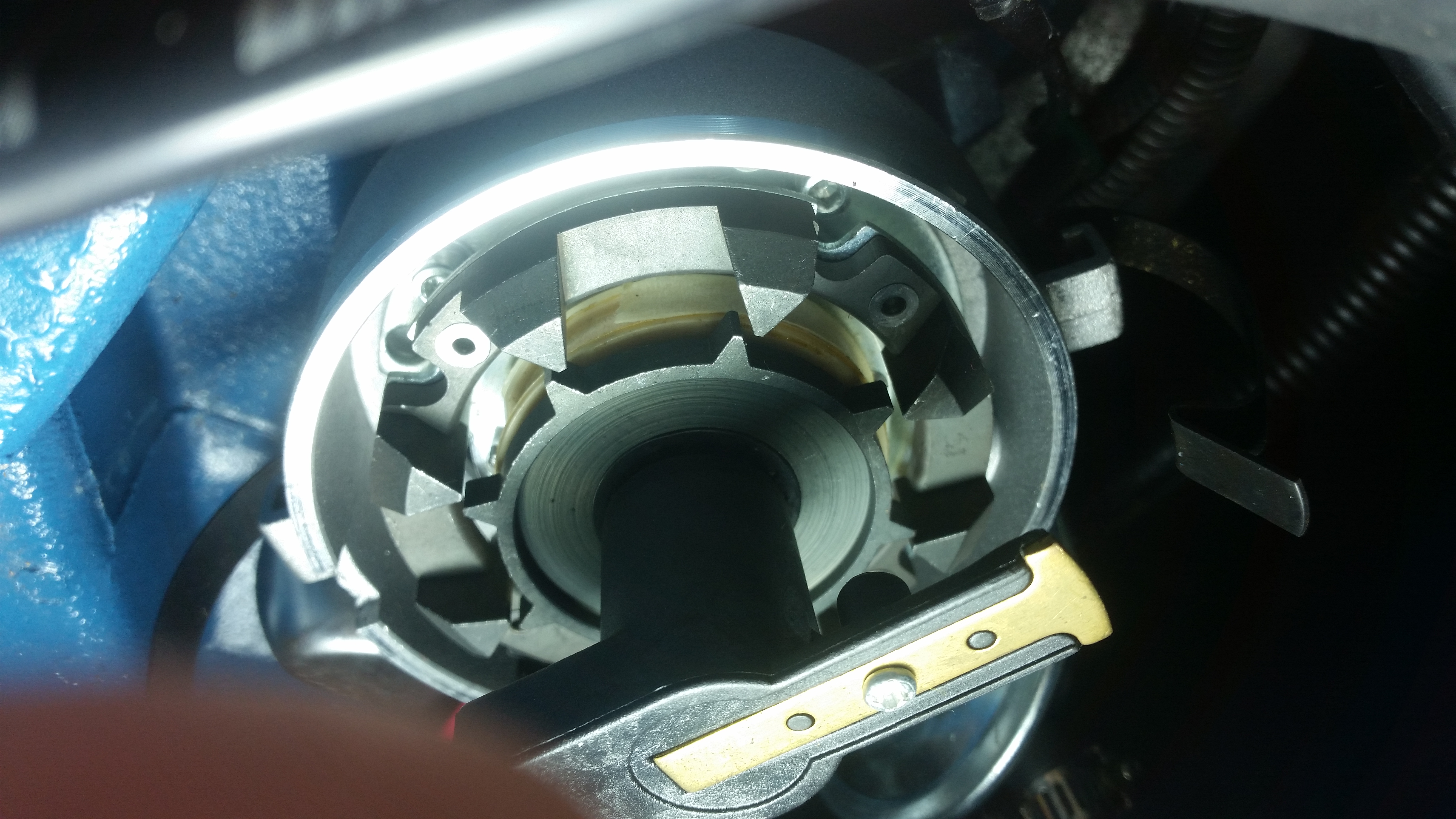

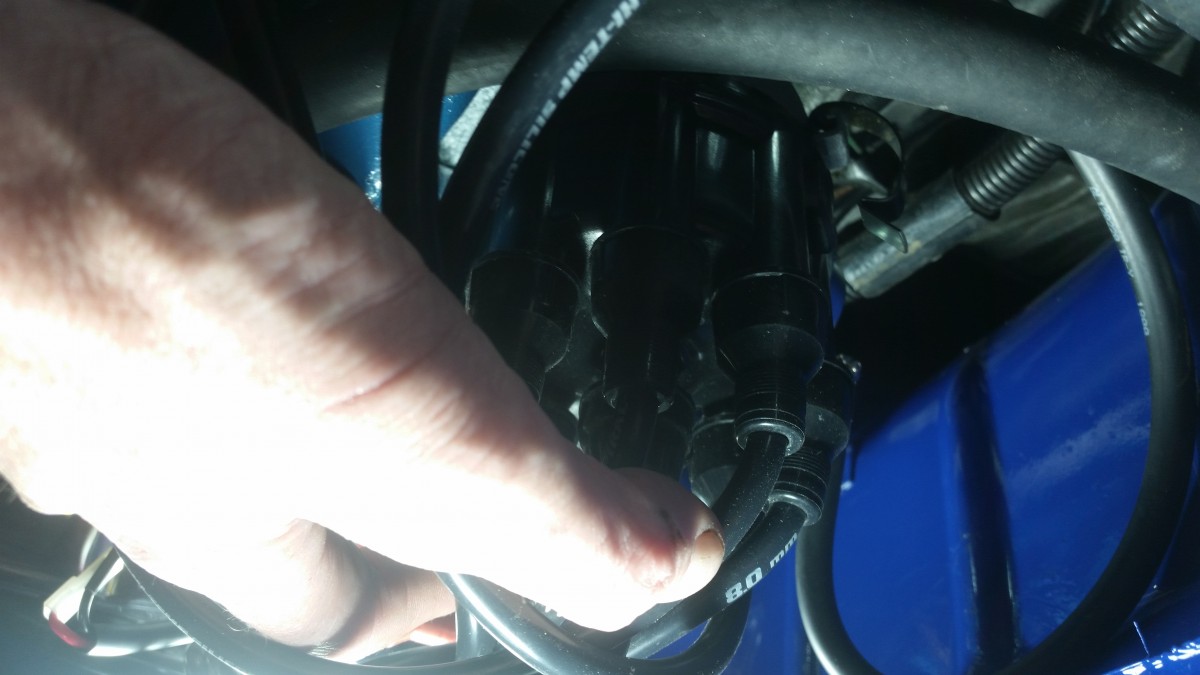

Checked everything before moving or changing :thumbup: everything looks ok to me :? might have to turn dizzy a little or did I get number 1 wrong on the dizzy :hmm: Some pictures
Harmonic position
piston top dead for sure
Dizzy position
The cap my thumb is on number one in the pictures

Fug! I'm not on zero degrees :lol: am I :?:

It would be my recommendation to paint the notch in the balancer white ... Or some light reflective type color, I use Silver Sharpies, fingernail polish also works well.
I do not know the hairy details of the Holden 253 (or any Holden), I do not know what the base timing should be, I do not know the cylinder layout, I do not know the firing order, I do not know the distributor rotation, I do not know the timing mark increments.
However, if the timing pointer marks are at 2 degree increment, then it looks like the crank is at 12 degrees BTDC ... Is 12 degrees BTDC the base timing ??
(As set by timing light at idle with vacuum advanced disconnected and the vacuum leak plugged)
The angles of the images make it hard to see accurately, it could easily be a tooth or so off and not noticeable, however If you are sure it is on #1 compression stroke, and #1 is the one marked in red in the below image, then you don't appear to be to far off, it should be close enough to run ... However the timing will be off and needs to be set with a timing light.
How and when do you plan on setting the timing accurately ??
Or have you already fired it up ??

Guy's Went digging around the shed and found my timing light, I think all I need to workout is the right timing marks on the timing case :hmm: once I work this out and time with the light should be good.

Turns out the "quipt4it" way works perfectly, so turns out he was exactly right! and everything he said was right and made sense to me so turns out he is a Fucking LEGEND :thumbup: 8-) . What I did wrong :shh: I was a plug over one the distributor all the leads so firing was way out and firing order issue :lol: she runs now!

Gampy wrote:
And how did you finally figure out it was wired wrong ??
That video of the Guy doing this timing on the HQ 253! he should have shown where no.1 was on the distributor cap. I had to freeze the video to see, then realized in my picture with my thumb marking no.1 on distributor cap was different to his. Where the dizzy cap clips on to the Dizzy the little lump, his was left mine was right to that. They didn't mark the cap I had indicating position no.1 that's where it all went wrong! :thumbup:
