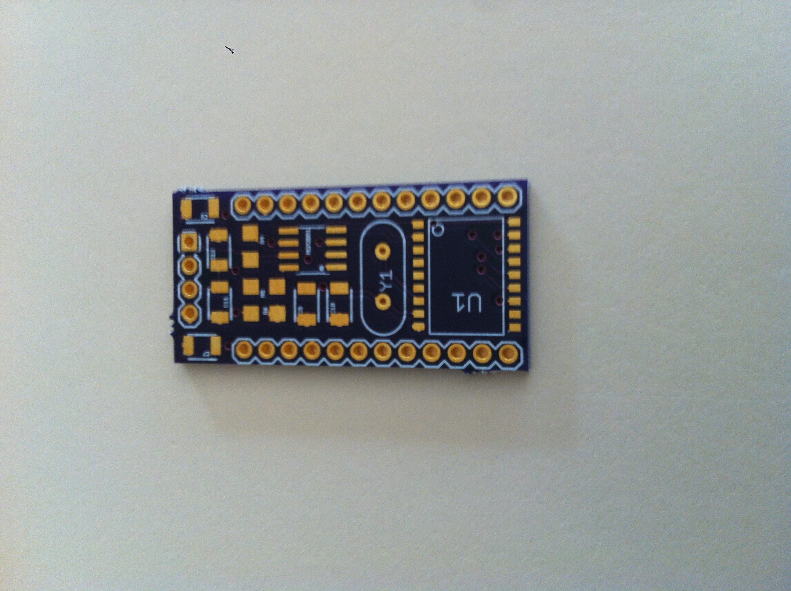

Postman pat rocked up today with a lovely present... heres the CAN prototype. Fits perfect on an arduino pro mini. If all goes well, should be able to completely eliminate the need for 3 ELM cables and no more buffer full!! :thumbup: This should be more applicable/appropriate for when logging VE stuff.. Since I know things tend to go pretty quick there!

pcb looks good :)

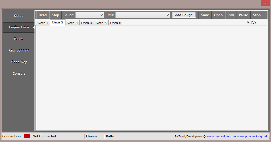

A bit more clean..
Im thinking just have a bunch of tabs that can have different gauges added to them. Ill also make it so the gauges created remain on next startup. And different protocols/cars can have different setups.
Not quite sure how Ill add in this data recorder.. will have to find a format thats easy to use, But itll be a bit difficult to replay.. as if the user doesnt have all the gauges used previously, then some of the data will not be displayed. I guess a simple textbox can be programmically created for each parameter which doesnt have a gauge developed.
