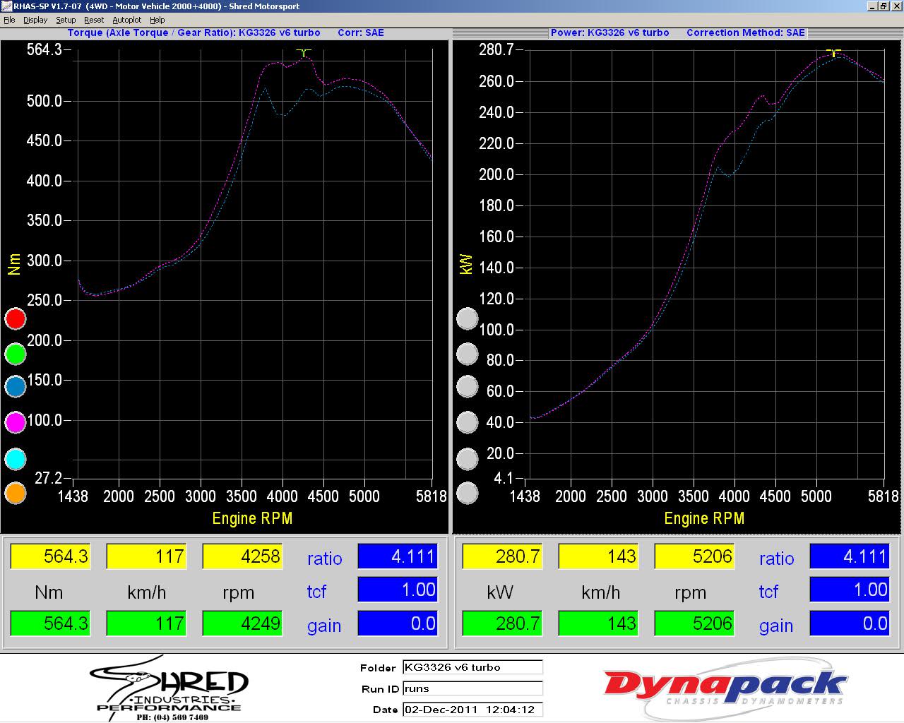

well i did 327hp at the wheels in the gemini and that equates to approx 450 at the flywheel, so i'd say your looking at easy 500hp!

heres the dyno sheet from ages ago its in this thread somewhere allready.can see a dip where the knock sensor went off they had it loaded up pretty hard and ive got the sensor on to a pretty high rpm where the engine gets noisy .its gained a heap of power since then

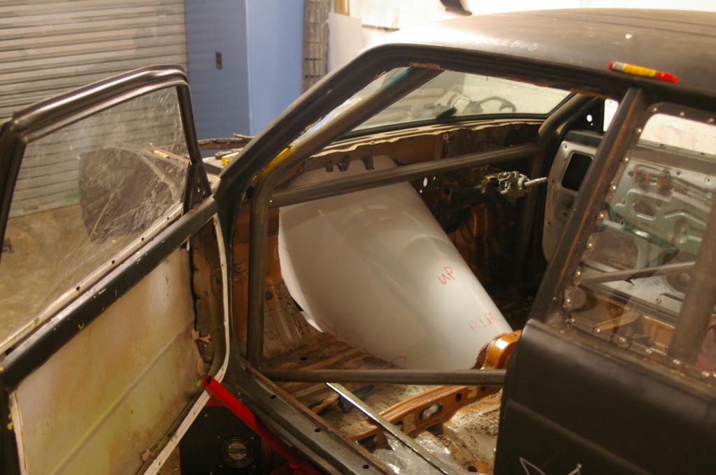

tunnel template time :P
Re: DELCOS NEW RIDE
That's a steep tunnel!!

Re: DELCOS NEW RIDE
was trying to cheat LOL.its more conventinal now as when veiwed from the front it was like a giant funnell of air leading under the rear of the car
