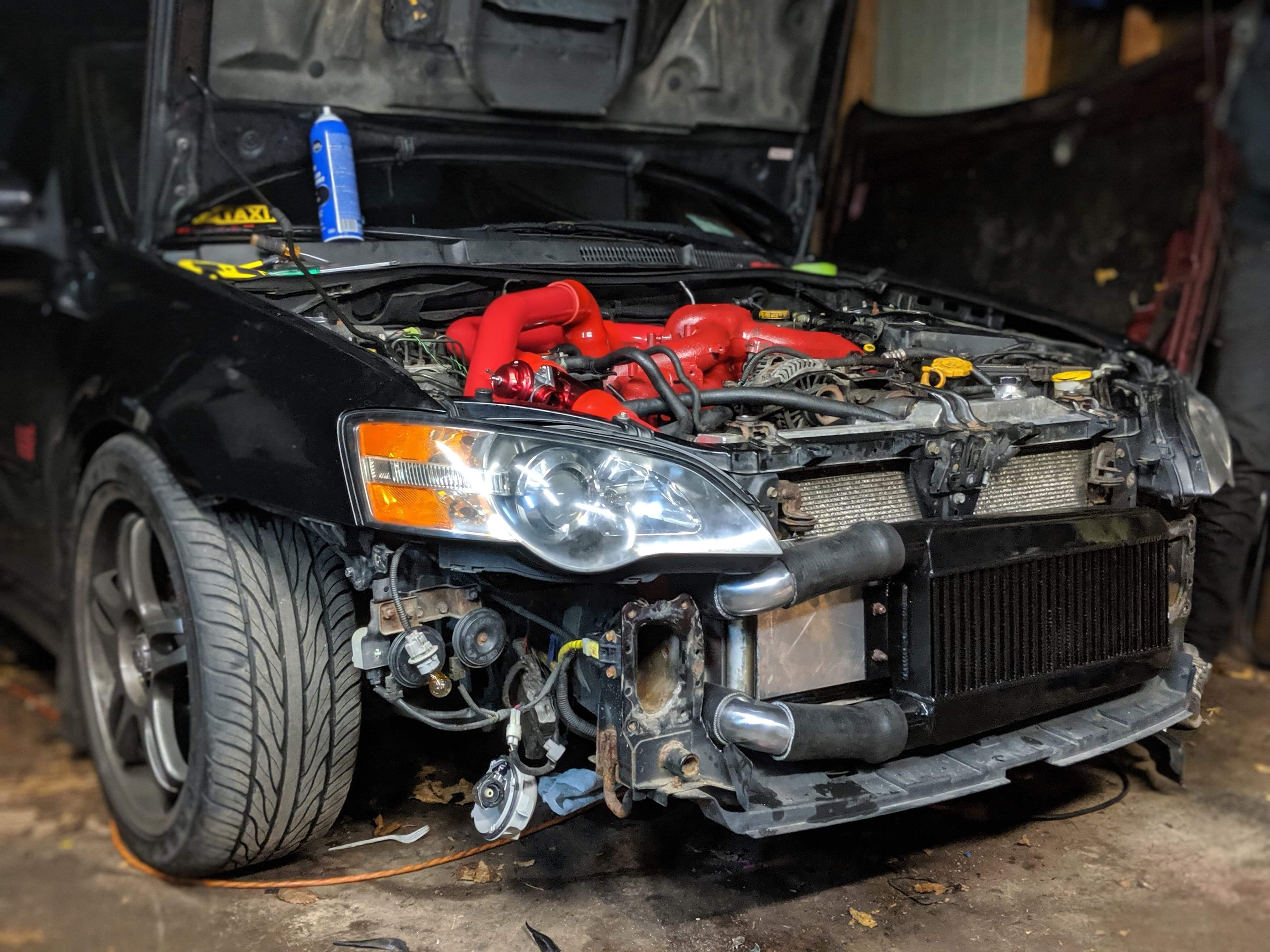

Again thanks for all your input dude. I actually used your sd patch for my buddies 05 lgt a few weeks ago

Right on! My Subaru is still my daily driver, in fact I drove it to get dinner tonight. :)
