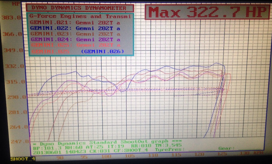

so dyno yesterday.
where do i start......
third gear is fucked hehe ... always wondered about that as the last time i used third was my 11.77 pass at Sydney and it didn't seem to change hard as it should and seemed to hold high revs to the finish line, like it was slipping .... anyways so we dynoed in second gear cause i mainly wanted to test stuff and didn't care if the numbers were off, glenn reckons you get more HP in 1:1 gear so who knows.
so fuel system is likely too small, managed to get the fuelling to .84 lambda i think it was, and got a best of 327hp at the wheels (not displayed in this graph though), its still a long way off the commanded AFR of .74 on full boost but its safe enough to not kill anything...
plus side, 6 x LS2 coils worked perfectly and the rising rate regulator stopped it leaning out just before 6000rpm, flat AFR on the dyno but fuel pressure was only 40psi when it should have been 60-65 or so.
also for some reason we were unable to load it at full throttle on the dyno so glenn was having to hold it at about 60% tps then as he let it go he nailed the throttle, so i dunno how much that effected things, and im not sure if that's what caused the initial dip in the hp readings or not, but theres definitely a lot more to do on this one!
plan is to fit second fuel pump and larger lines to the rail and re-test ... also going to run it with less boost for the time being to keep it safe ...
i have another freshly rebuilt trimatic i am going to put in before WSID in two weeks too, so hopefully that will help a bit!
