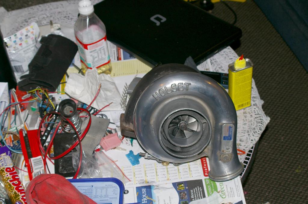

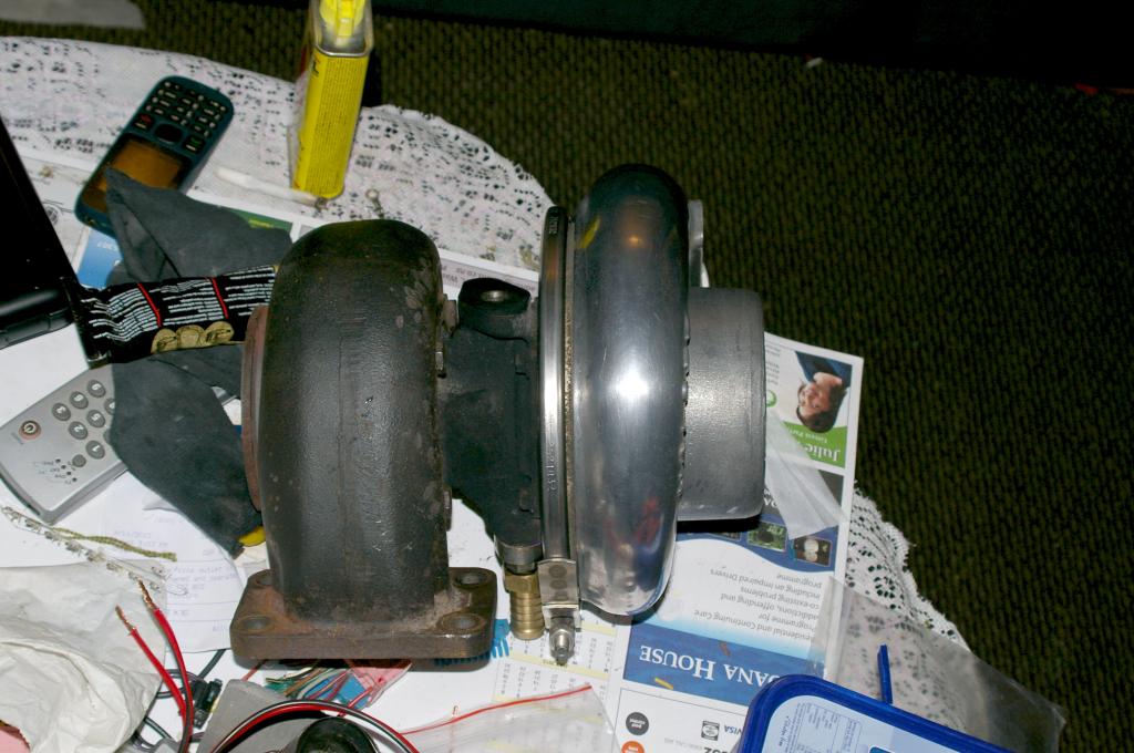

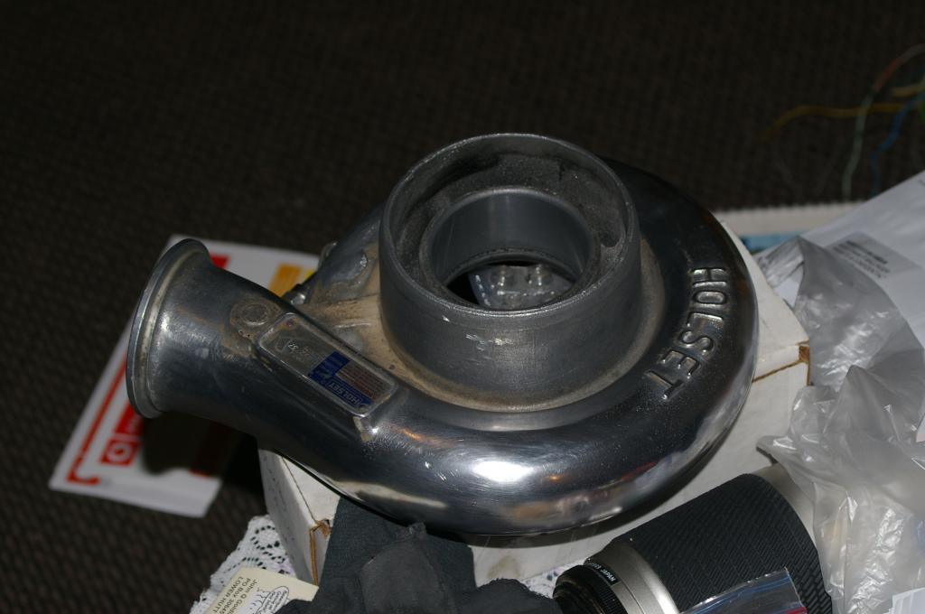

the final creation 0.82 rear off my china T70 with holset H1E core and compressor housing.same size wheels front and rear as the china T70 but more blades and differing blade angles should hopefully spool earlier and be capable of 650-700hp.bolting it on tomorrow for a test run if the rain goes away.

preliminary testing done.its on and running but its not stopped raining in 3-4 days and is shit out there so no driving it yet.BUT its definately flowing a lot more air.it fair dumps the air out the BOV when you give it a rev now.load it up on the convertor in the shed and its making 4-5psi at 3200rpm
winnnnning normally 0 boost at round 4000 before it breaks traction.this thing is going to be animal now. and the sound OMG it sounds like a jet when it starts spooling and does the biggest dose when you lift off as the BOV cant vent enough air now .wooooooosssstttutututututututututututut woooooosssssssss tutuututututututut LOL.driving it raining or not tomorrow LOL

but none to compare but it definatly flows more down low was at 16:1 coming on boost LOL ve table has now had major rework. just need a little more work as it hits boost slight bit of knock retard as it hits as we never normally run in that part of the tune.but a plus side the cooler is big enough manifold temp at 40 degrees even while not moving
.couldnt do any more tuning or turn the boost up as we keep popping the clamp off the turbo.mods to be done during the week.definately an allright turbo for free feels strong at just 10psi cant wait for 14psi.youll see in the log where the pipe blows off.injector duty cycle 60ish seems the alternator may not like rpm much either gets down to 12v on boost LOL.log and adx below
