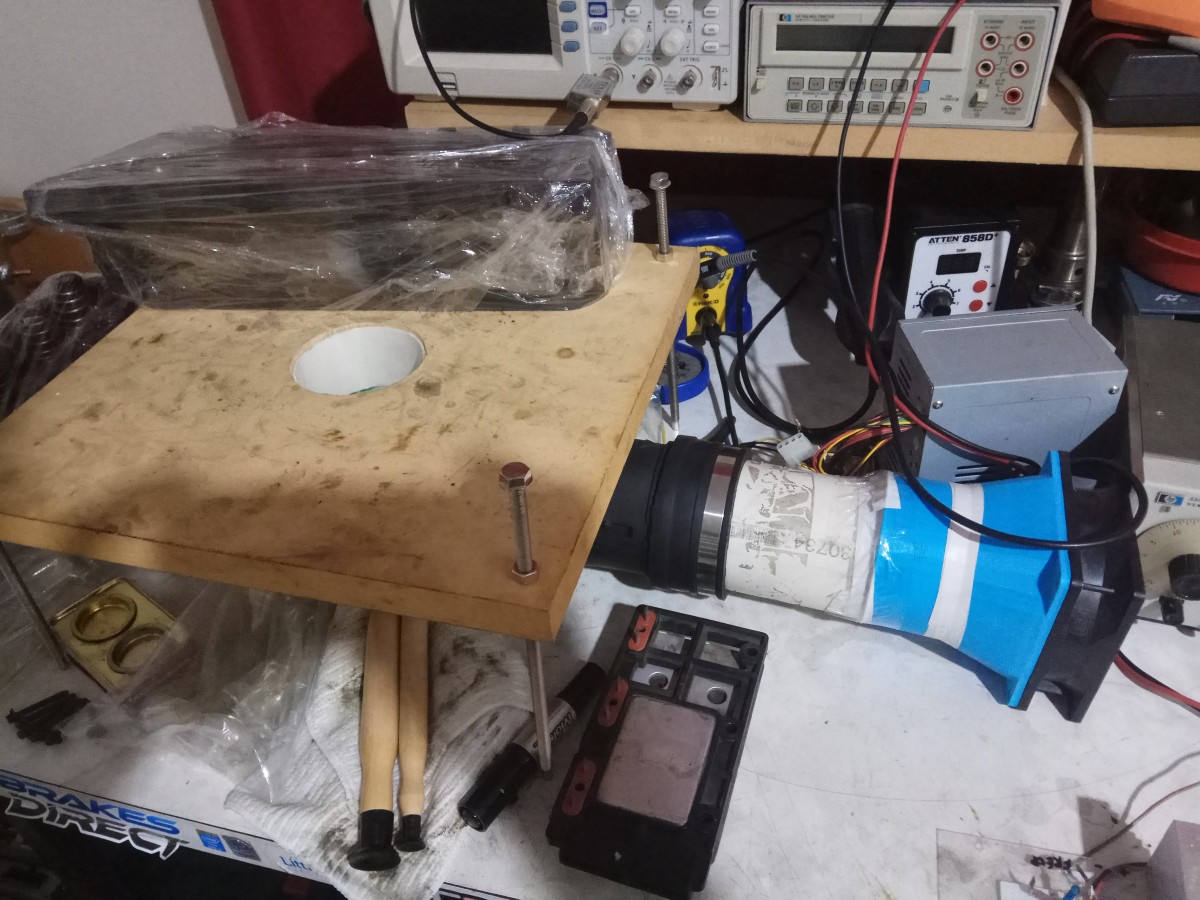

- Posts: 4853
Re: The1's Daily
Nothing special few downpipe bits the maf and 3D printed an adapter, sit the head on with a rubber seal and setup the vales and get a reading

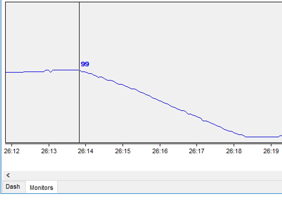

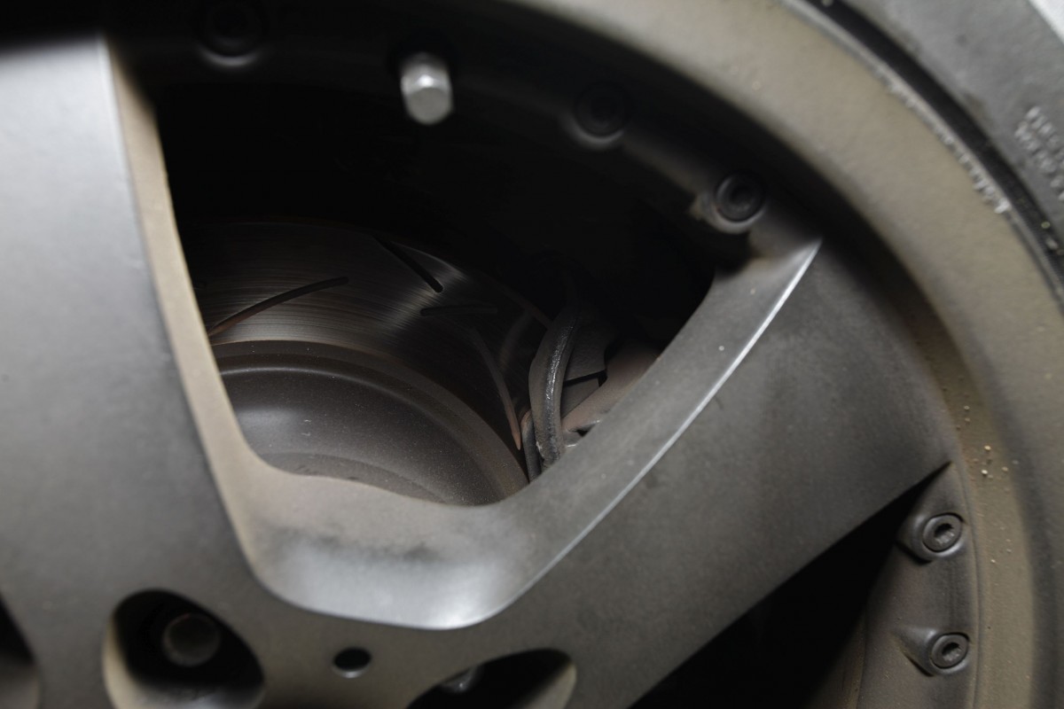

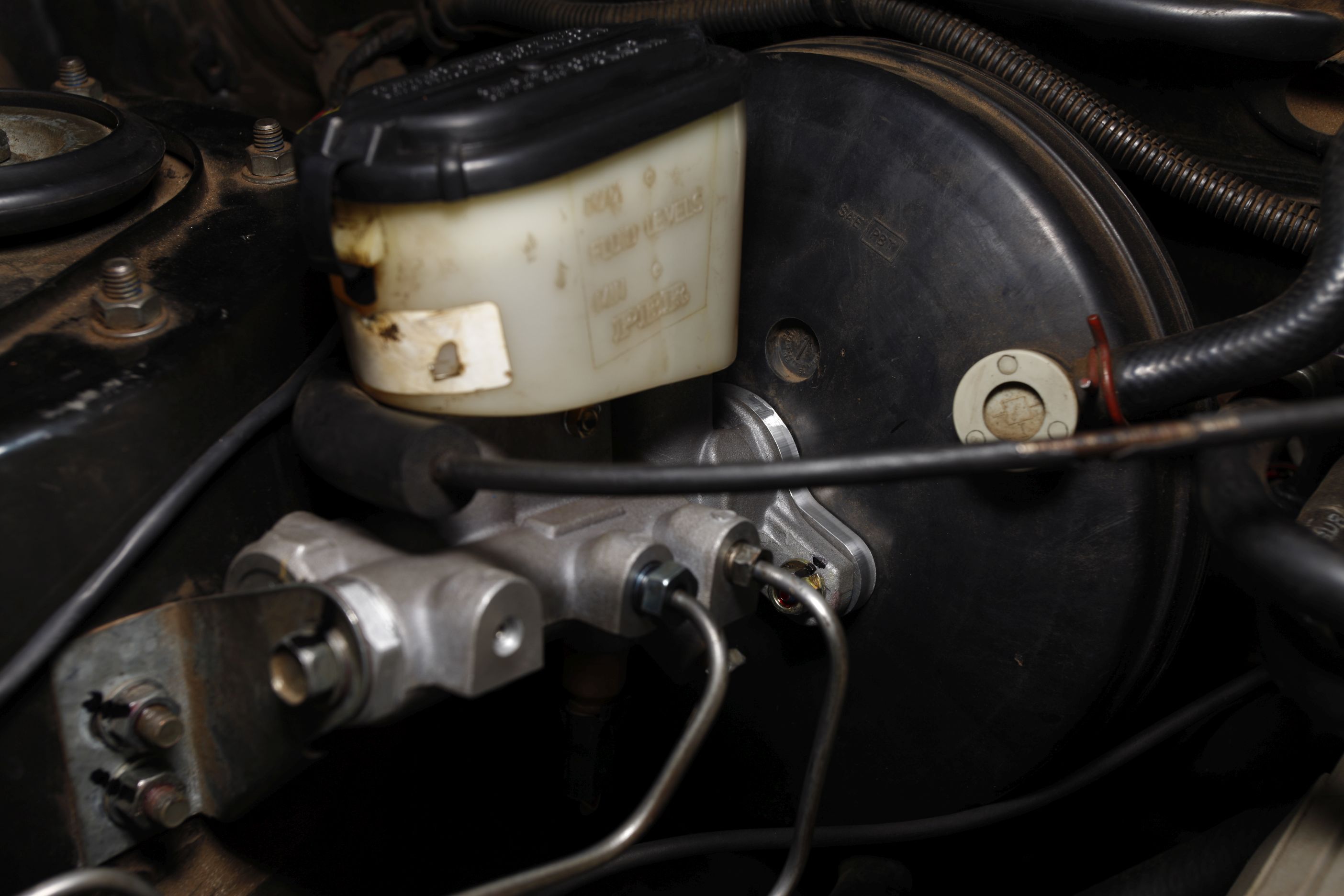

Did a couple of things to the VS,
Fitted up slotted rotors DBA4000 series slotted and QFM HPX pads which made quite a bit of difference, the pads do need one or two normal brake uses to warm up from cold but good after that very good. I also bought a Larger VY Master Cylinder and put onto the VS Booster, i bought an adapter spacer plate so i dont have to change the booster and modify things. It made a big difference as well. I got the spacer from here
https://www.racebrakessydney.com.au/pro ... der-spacer
The booster fits up fine, the bolts are just long enough so have put locktight on as well jik. You can use the VY Container on the top but it reduces the volume by a heap cause of the angle difference on the VY, they swap right over without a problem. So i did a tunerpro log but to test braking speed, down to about 4.1seconds 100-0, now i just need my 0-100 that quick lol

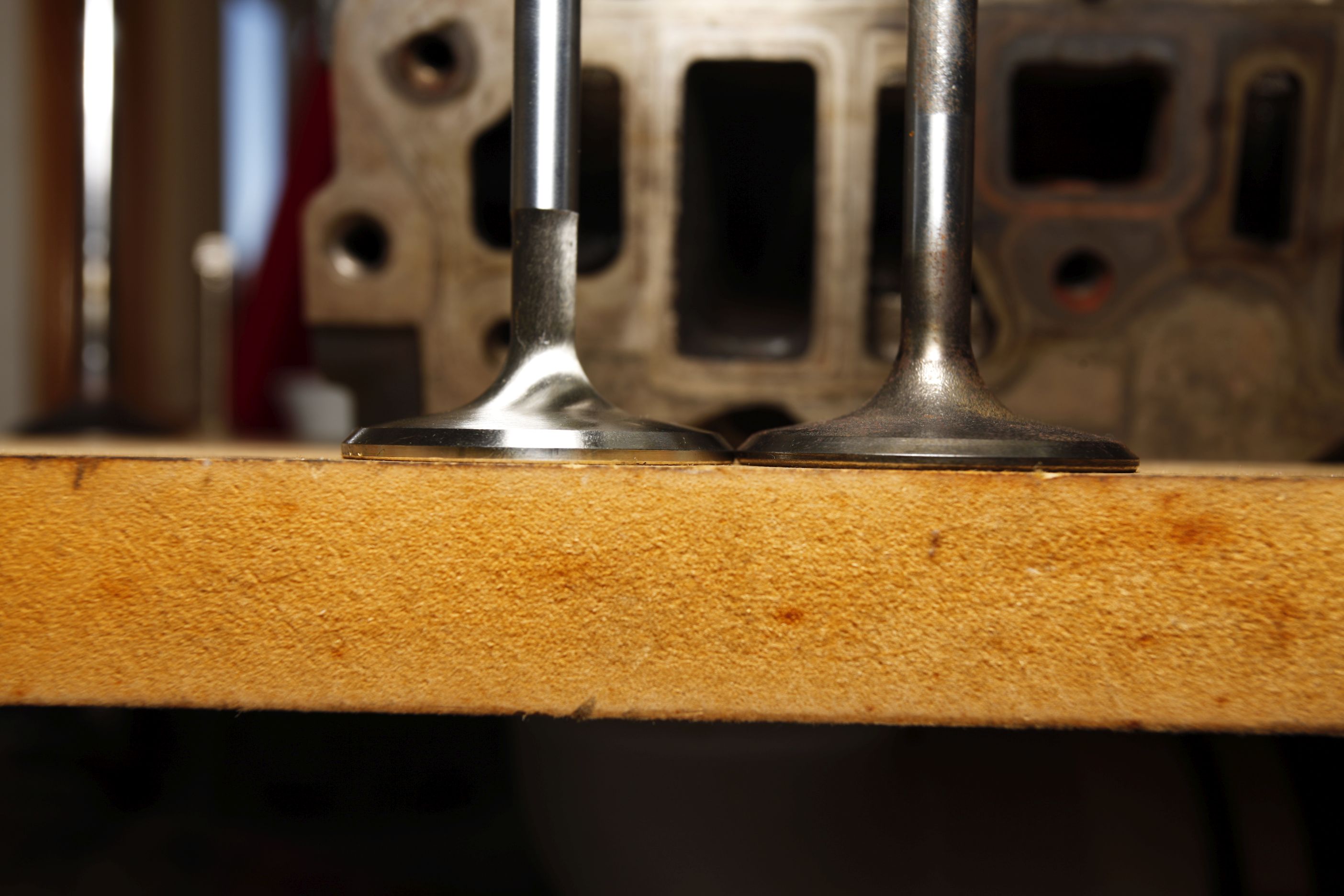

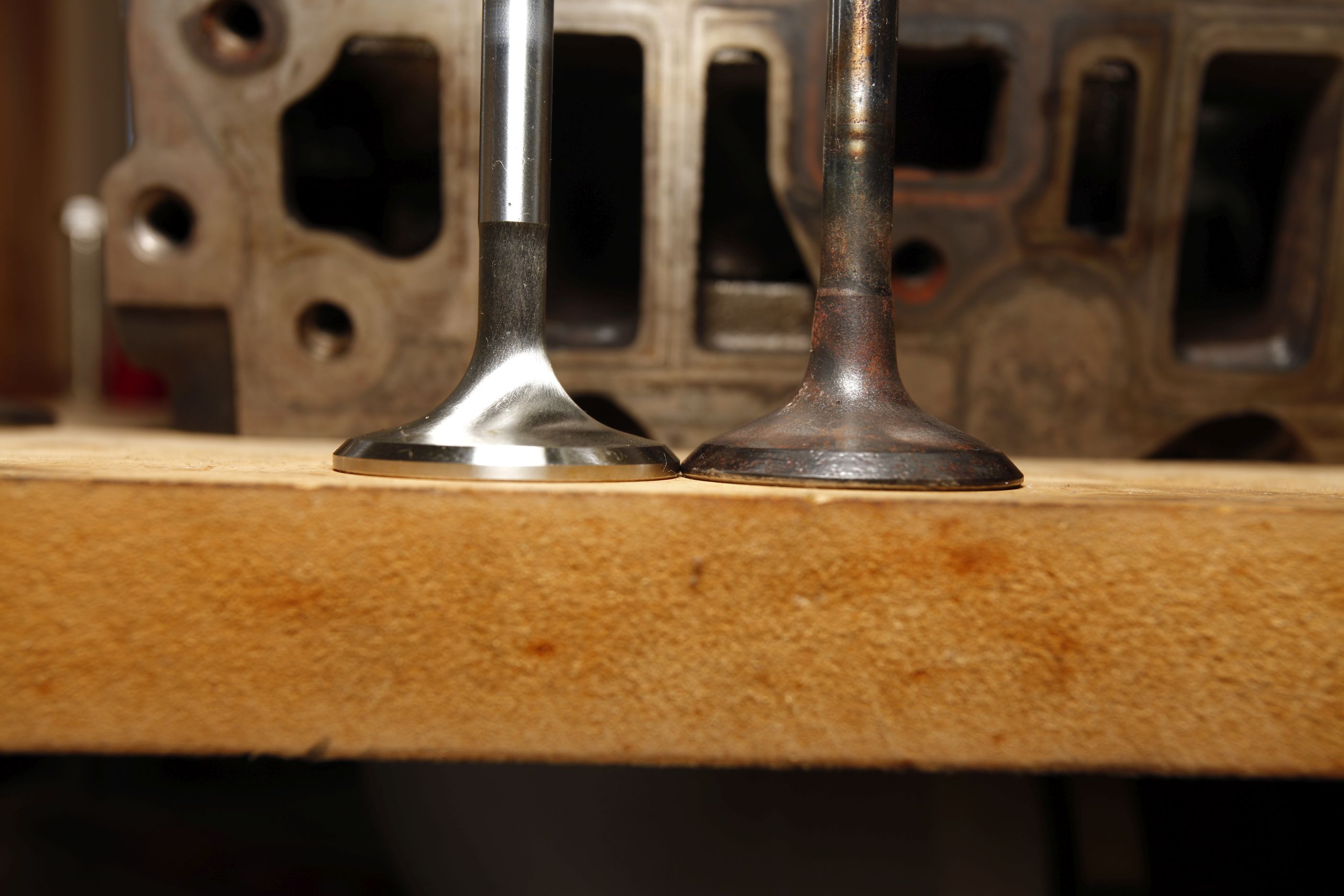

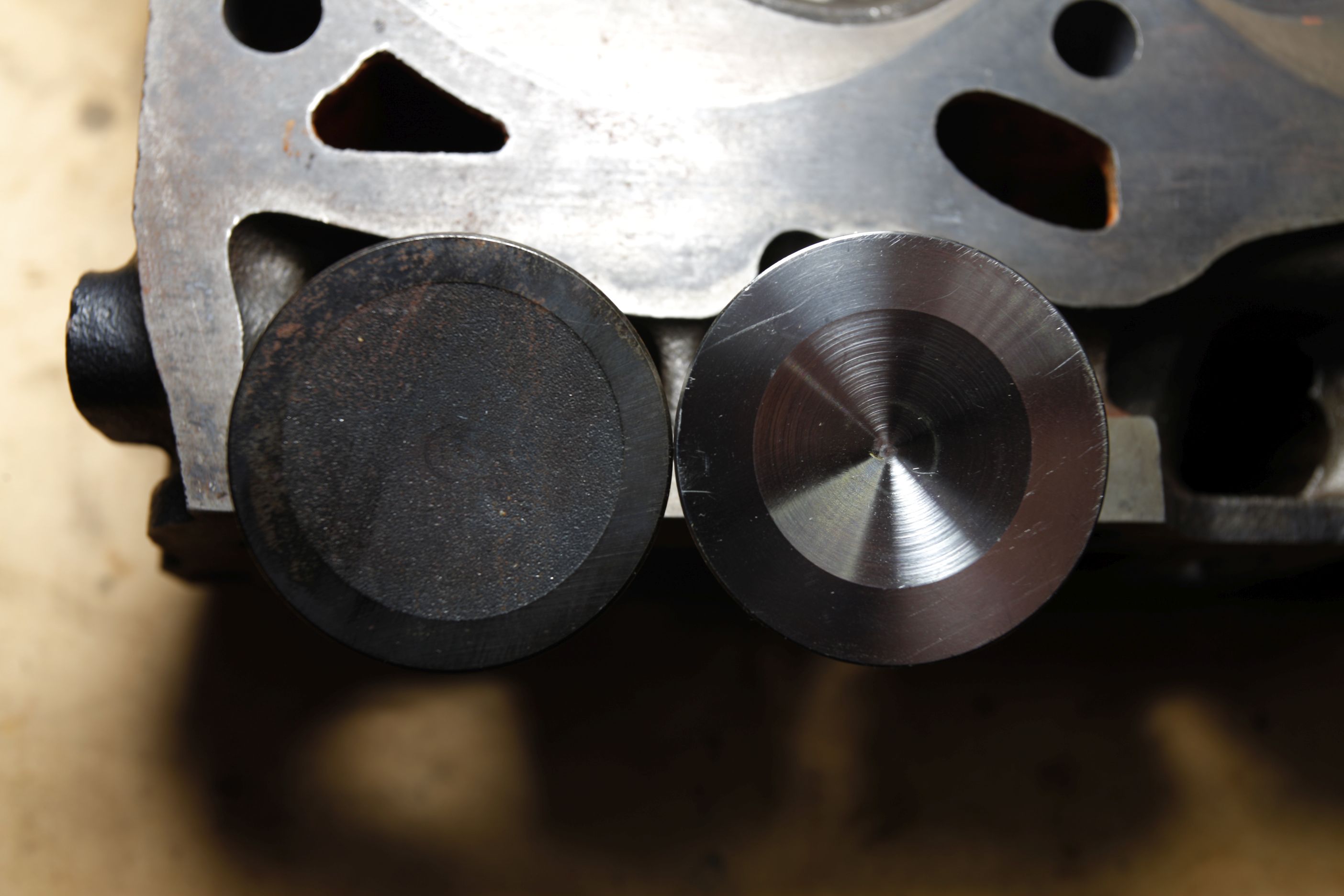

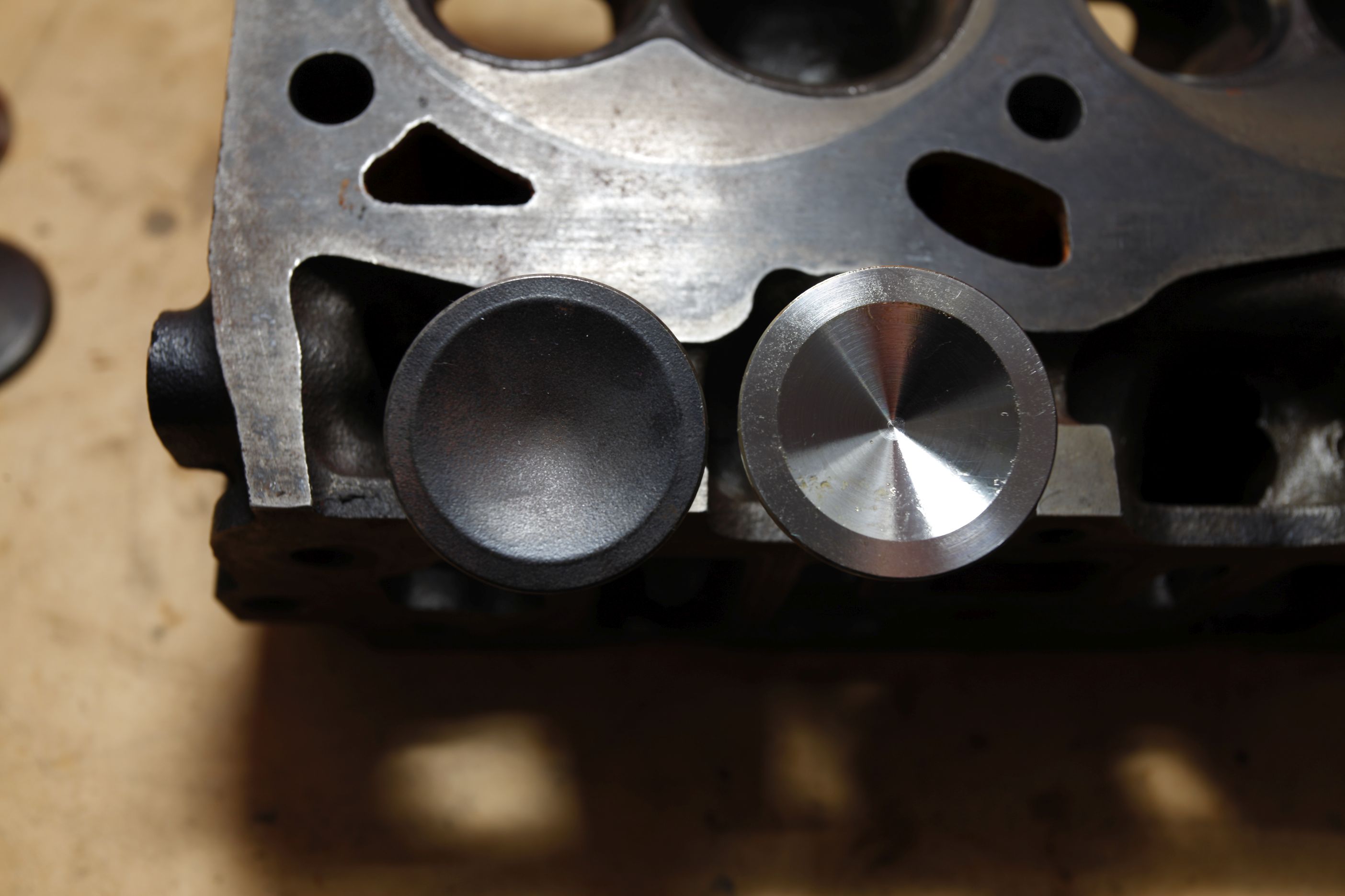

Also here's some pics of the ZZP valves vs Stock L67, mainly the exhaust valve they made it more like the intake valve with the height, the dishs are different as well, otherwise identical. Perhaps it helps with the exhaust side heat issue and valve pitting?
Intake Exhaust Exhaust Intake
