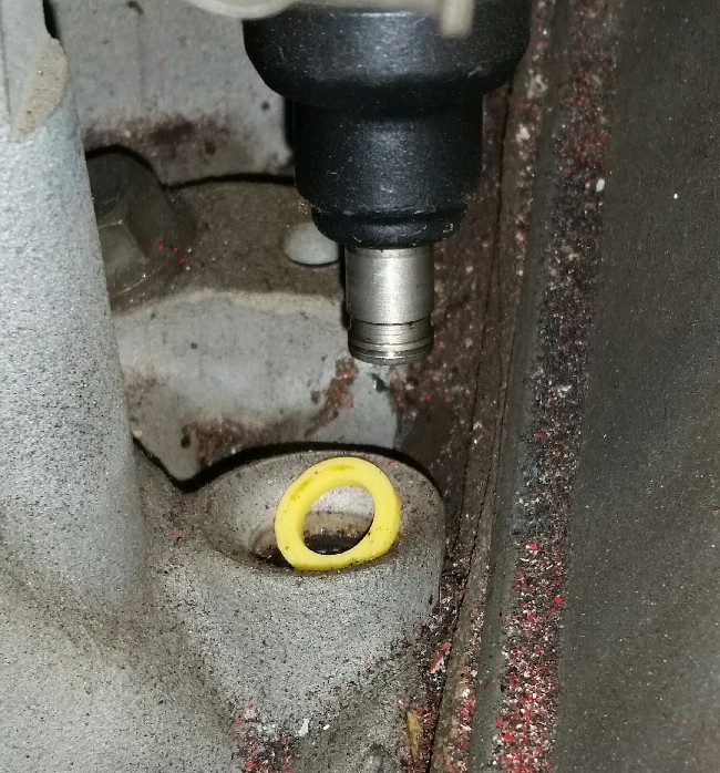

whilst having said ale i was wondering why there was so much fuel smell in the shed and found injectors leaking from the top seal into the fuel rail, and it was nearly all of them, so i pulled the fuel rail out and this happened on 4 of them.

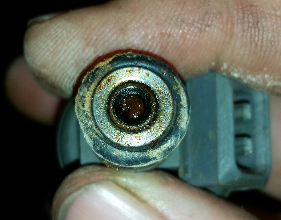

I then pulled all the injectors out and found out why they were leaking

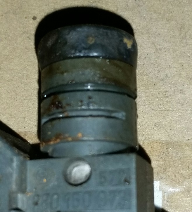

its not really a good photo but the top seal is half eaten away
i then spotted the reason it wasn't running real well ...... the cavity inside the rail was also full of gunk!
some of the filters were full to the top with crap, others not so much......

Do you think this is ethanol eating components ?
Re: CF Bedford Van
in this case i can safely say since i put the VS commodore fuel tank in the bedford all its had in it was 98 octane fuel, so it shouldn't be, but who knows really!
oldn64
- Posts: 256
- Joined: Mon May 28, 2018 7:05 am
Re: CF Bedford Van
Judging by the last photo I would say not ethanol issue. it might have just been that time. I would be replacing your fuel filter as well.....Holden202T wrote:in this case i can safely say since i put the VS commodore fuel tank in the Bedford all its had in it was 98 octane fuel, so it shouldn't be, but who knows really!
That sediment is not looking too nice. Did the tank get cleaned before being installed?
