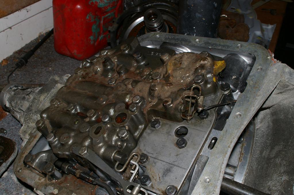

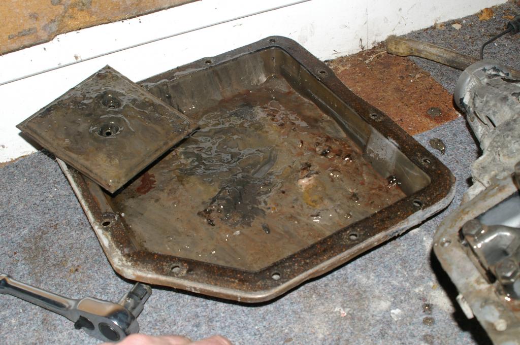

so last night i opened a can of worms LOL thought it was about time to rip the T350 down and check case condition before getting a crack welded in the bellhousing.omg its um full of clutch material and mud LOL its sat a number of years and has a rust hole or 2 in the pan LOL.also the clutches have seen some heat ill let the pics do the talking aye hehe.

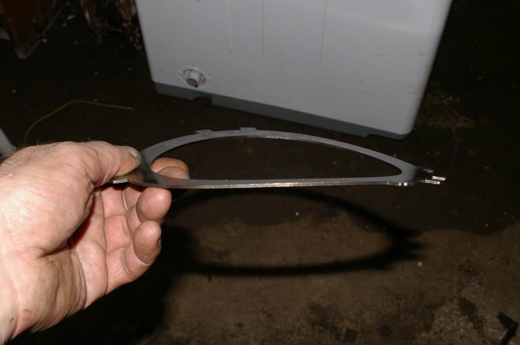

mud gloreous mud LOL 1 clutch steel out of the first set of clutchs not good
- IMGP6730_zps13f0f6e6.jpg (109.62 KiB) Viewed 2823 times
- Posts: 8124
Re: DELCOS NEW RIDE
looks fooked!
Re: DELCOS NEW RIDE
umm I don't think that's a clutch steel, I believe that's a wave plate and is supposed to be like that its for cushioning clutch apply!
I also believe the steel between clutch plates will have fingers all the way around them if its anything like the trimatic.
that one looks a lot like a reverse clutch, was it on the outside of the clutch drums against the case ?
