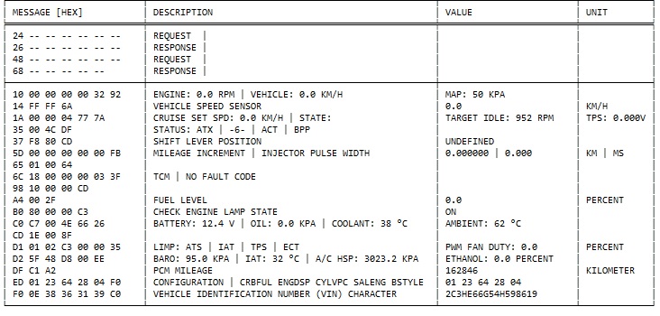

acln99
Posts: 27
Joined: Fri Feb 22, 2019 3:32 am
cars: Dodge Ram
Location: Ontario, Canada
Post by acln99 »
Have already done a lot of the PCI investigation for PCM at least. Remember have a CCD / PCI translator.
What we need now is NGC3 ( or NGC4 ) seed algorithm so we can finally write EEprom to disable SKIM / chg VIN . Already know where but can't get to "How".
After that maybe de-cipher flash but this isn't really needed as HPT does this for NGC3/4 . We know a lot about SBEC3 flash but not everything. Not sure if NGC has config options in Flash like SBEC does.
This pic was with engine OFF so no RPM, temps etc ....
