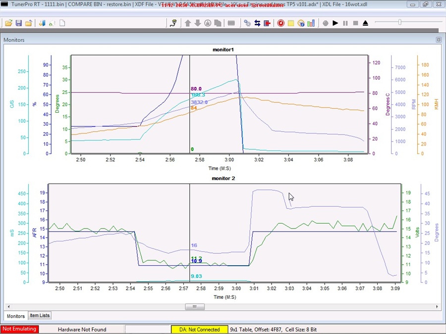

had some success with the car today maged to get fuel somewhere close to where it should be so had a play with timing. went from a max of 13 degrees adv to build quickly from 14 upto 16 in the midrange and back down to 13 by max revs, with no dramas with knock. what a difference just 3d makes to the midrange pulls a fair bit harder def feel it and it sounds much more urgent wants to rev out harder. so i wonder how much more i can get into it before it knocks. am i playing with fire running this much timing?? it definately loves it.
only seeing 8 psi in the manifold so its moving a fair bit of air. but its going hardest it has with this cam yet on a hot day ....think i might try 15-17-15 later.
maybe this combo just needs more timing, or maybe im just fukn silly :D
ScreenHunter_02 Nov. 12 20.50.jpg (158.16 KiB) Viewed 5292 times
AWESOME vl ill be going right over the updates tonight got all night getting ready for night shift, so off to bp i go for my ultimate fix. :thumbup:

ok something caught my eye straight away there vl400 or anyone else whos not guessing, torque manage> MAX AIRFLOW VS RPM. dont like the sound of that.
does this in some way restrict the air allowed past the throttle body at selected rpms, thus restricting my ability to go sideways?
im looking to elimate all torque management hate that stuff. be-gone with the smooth gearchanges bring on the snappers.
