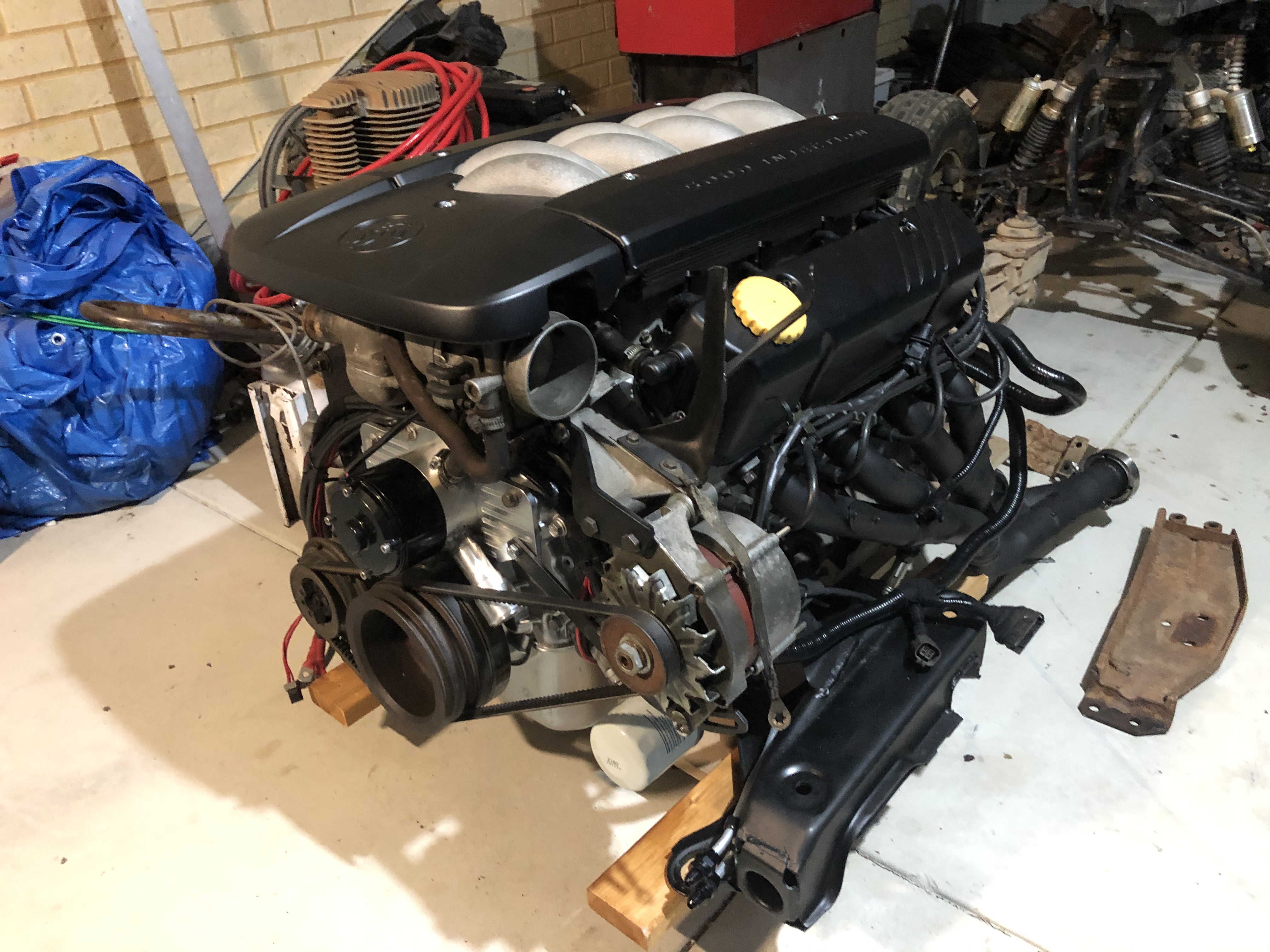

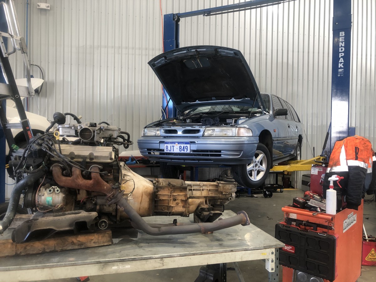

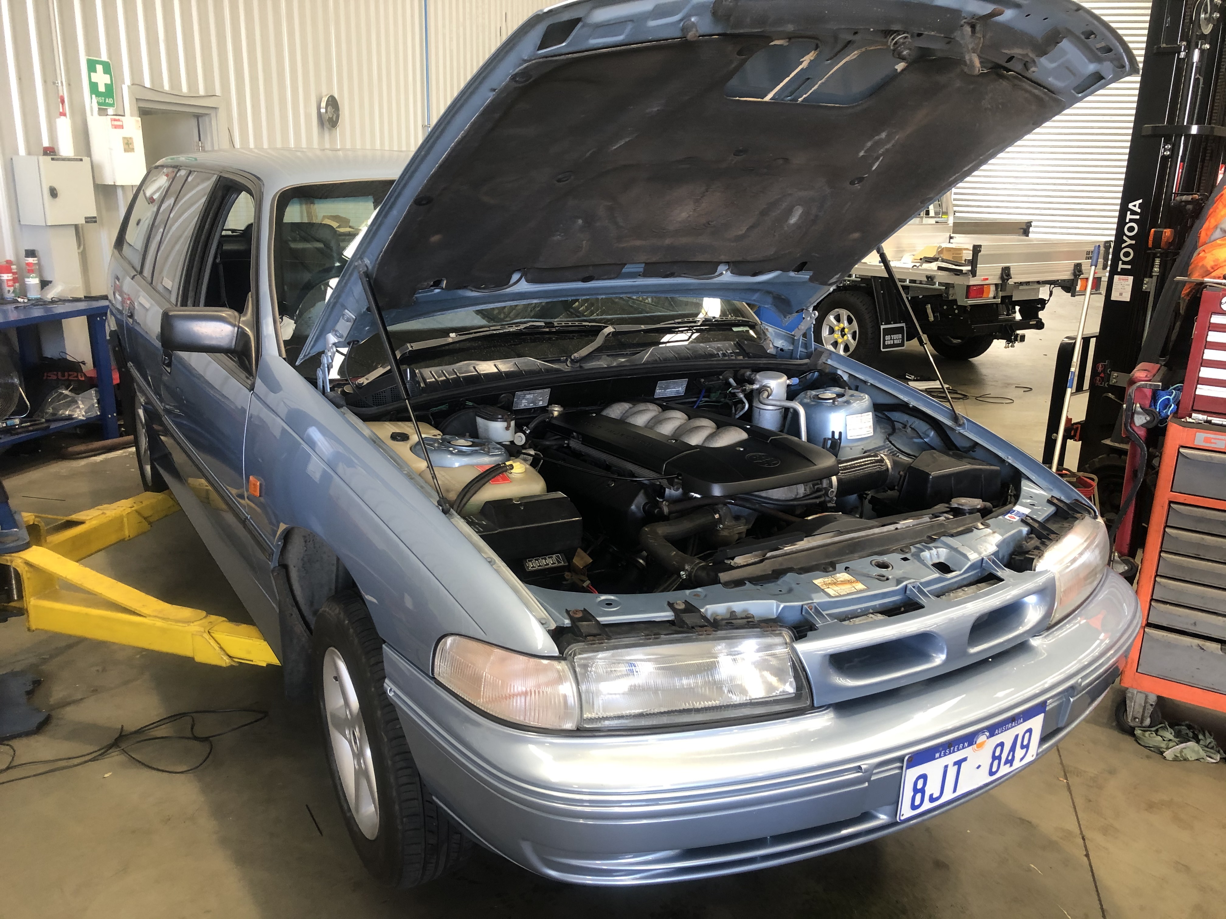

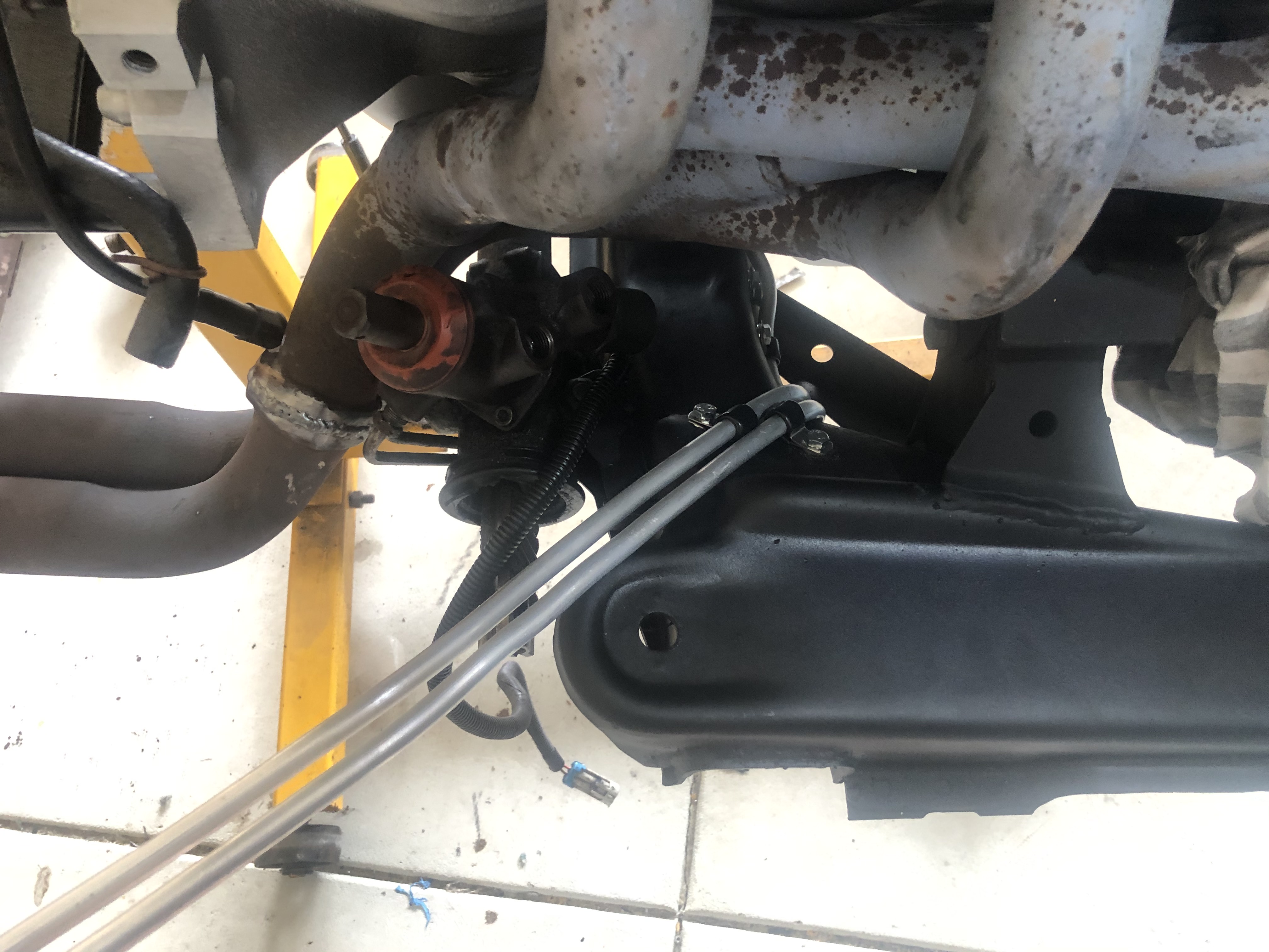

been a while since ive made and update but finally finished building the rebuild and fitting it all nothing special with the engine internally just new rings bearings and gaskets and just ran the hone down her to knock off the glazing but and had to go to the larger chamber vn heads instead of the vt/vs s3 heads as mine needed a bit more work got to find time to finish the port job. only other things i had done was astra power steering and the electric water pump and was all running fine untill last week i noticed the voltage was starting to die a bit the alternator wasnt keeping up so decided to fit the vs s3 alternator to it and now the voltage is ok charging at 13.6v under full load everything running but when i fitted the new alternator the solid state relay controlling the water pump shat the bed and shorted through so its always on so replaced that and it did it again this morning on the way to work its rate at 100amp @ 30 on load side and 28m amp @ 4-30v
the water pump is only 15amp max draw so i dont know whats going on there any ideas? but when its all running it keeps nice and cool temps drop from 92c to 86-87 easy with the BF thermo fan cooling it and temps can even get down to 82c while cruising along easy. im wondering if i should go back to using a thermostat and just use a mechanical relay and just set it on just below thermostat but would really like continue with controlling the pump speed with the flex output on the 808. as for the power steering i works really well just have to wait 5-10 secs after startup and the pump fires up no issues feels a little bit heavier on the steering but nothing to complain about in my opinion. only other issue im having at the moment it trying to sort out the hunting issue at while hot
