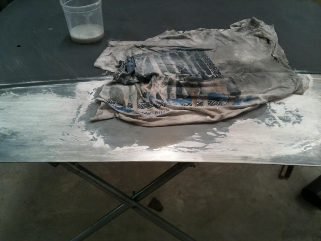

had some wierd problem with the primer on the bonnets. apprears either there was crows feet that we couldn't see or the sun damaged paint swells then shrinks from the primer making it all cows feet looking.
So I started to sand it all off but I couldn't get far as it clogged the paper straight away, then I got an idea.
I used thinners to dissolve all the paint off and I knew it wouldn't touch the EPD coating. well pics show the results.
and final result. Its like a NOS bonnet just about :lol: back on track, might use this method on the new boot lids since its a burgundy colour and has crows feet too.

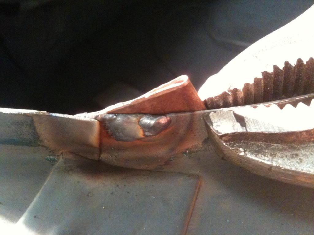

mig or tig with silicon bronze (CuSi) wire :thumbup:

charlay86 wrote:mig or tig with silicon bronze (CuSi) wire :thumbup:
thats a great idea. thanks

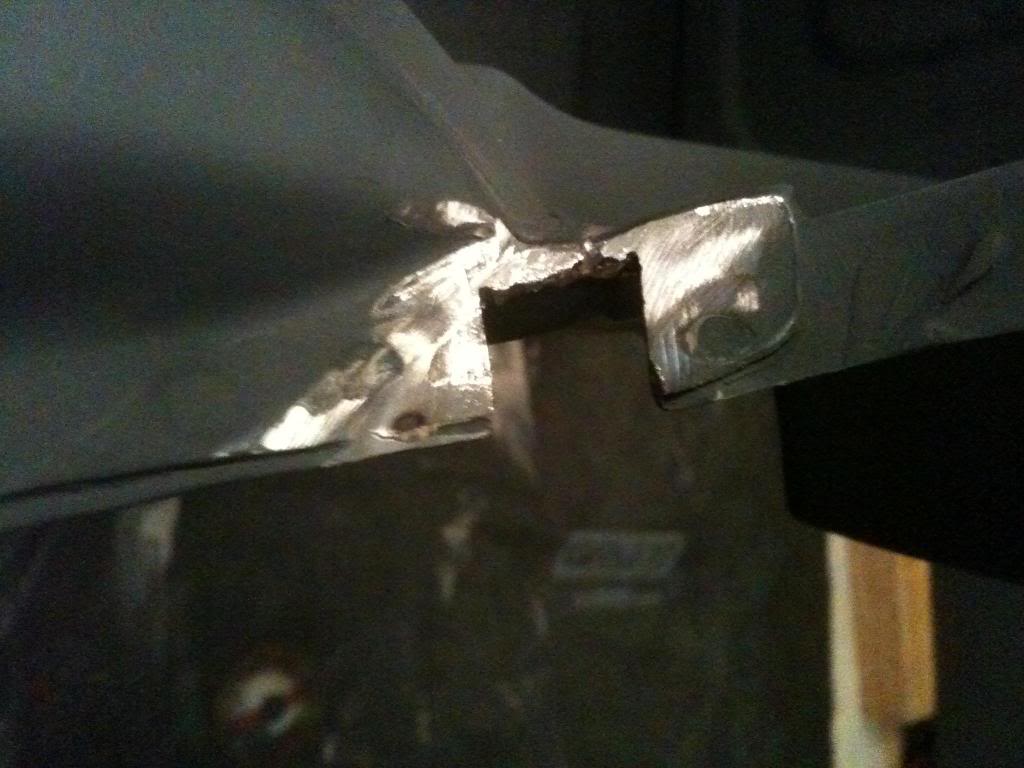

Re: Vlad's VP executive (full restro)
well, I put the mig aside as I sucked at t or it sucked?
I had the opportunity to use the auto mask and shield gas and setup my old tig I bought 3 or 4 years ago but never used it. It was actually not working when I bought it but since i am in the electronics field I repaired many faults with it but didn't know if I was successful or not til now.
worked perfect!
So I started to put some of my tig knowledge I learned off the net to practice.
pics will explain it better.

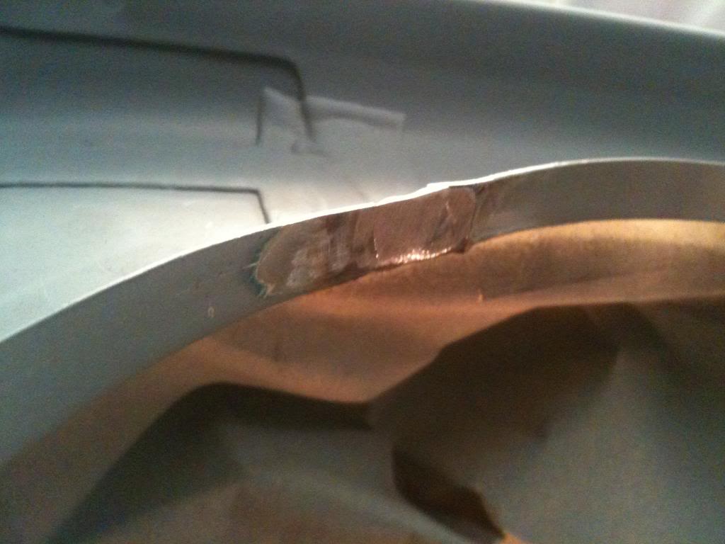

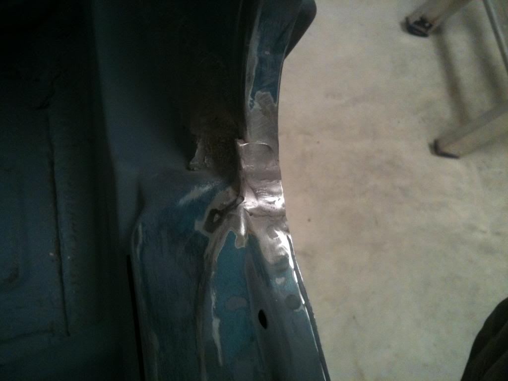

other side.
:thumbup:

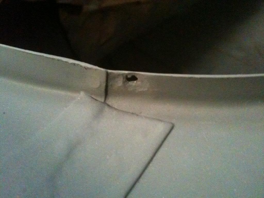

Then the bottom one. Cut out the swiss cheese.
Also got the bonnet all primed after removing all the old paint. Also managed to push the little dent out but made it a little ripply in the process but overall it will only require high build primer to flatten it instead of bog now. You can only do so much when the dent is on a non accessible part of the frame. I used a large nail bent like a banana to get inside and push the dent up to a workable flatness via the bonnet latch screw hole.
