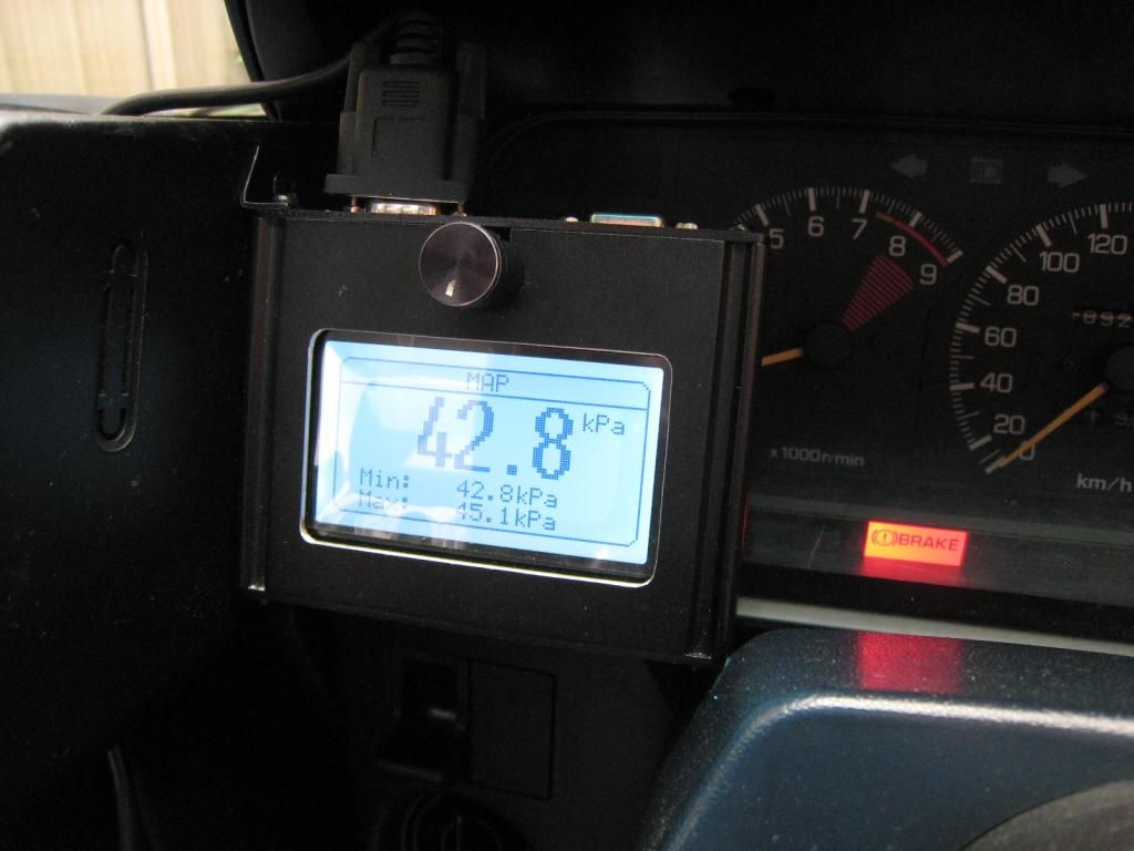

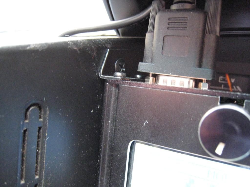

Re: FS: ALDL Logger V2
Has anyone mounted their logger inside the car?
I did with Logger V1 which I since sold to my brother and he uses the same mount.... was just a bit of flat bar off the back of the unit and screwed to the dash panel in my race car, so wasn't exactly pretty but worked!
I haven't tried to mount the V2 in the car yet, but I have VL400's ignition module in the same type of box which is mounted, so it wouldn't be hard, I just use it in too many places at the moment to mount it!
- Posts: 445
- Location: Sydney
Mounting method
nice work Dick. Pretty fancy boost gauge you have there
