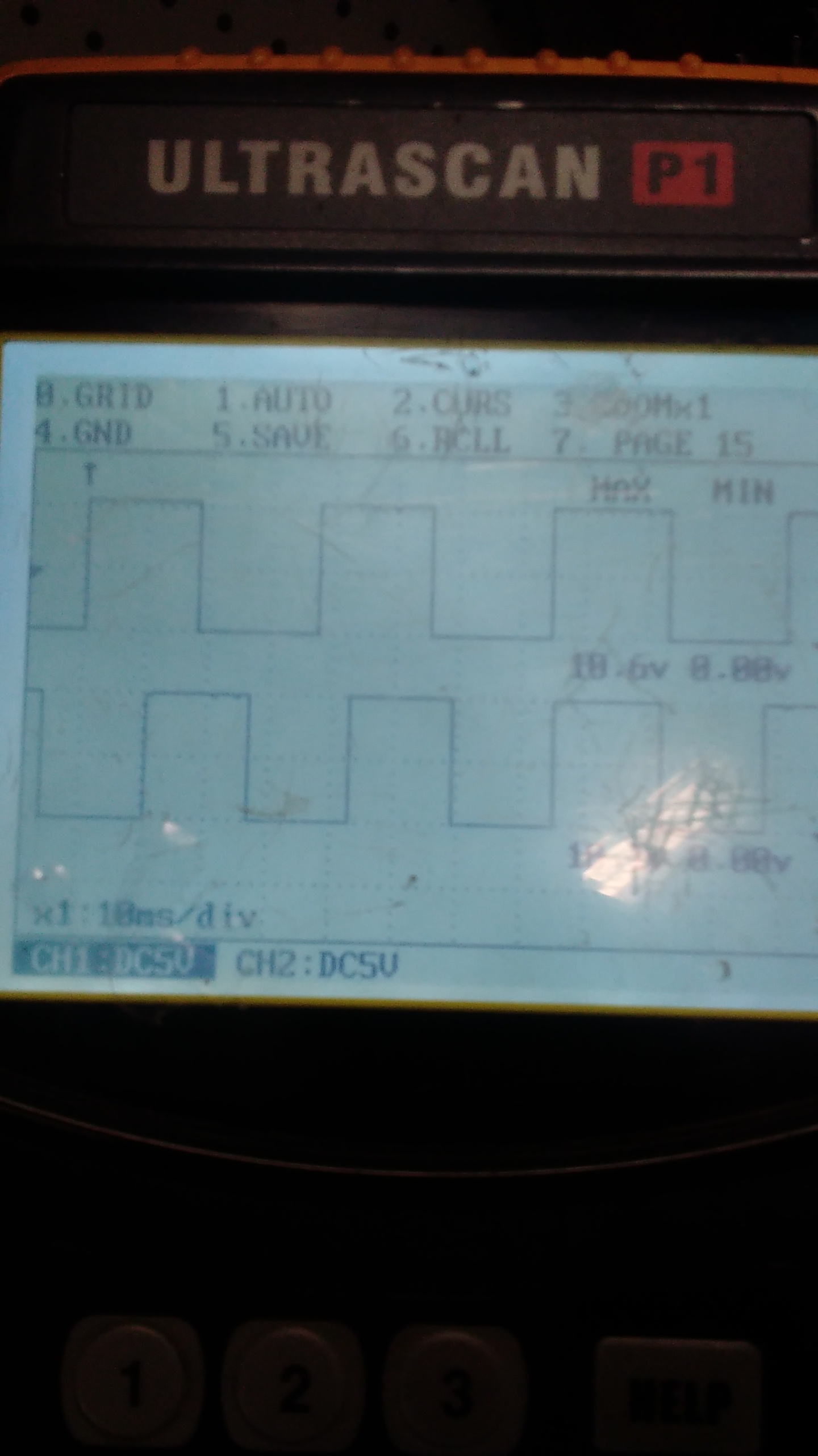

Ever Get the new Jaycar unit to work? I Been doing some testing on the bench, I have one of the old Build yourself one and that works no problems.
I can hook the new Jaycar one up to a pulse generator i made at tafe to check speedos, and it works - not the smoothest but it will change the output ok.
If i hook it up to a commodore T5 speed sensor and spin it up with a drill - wont flash!! Checked the two signals with a scope and they look the same, Stuffed around for ages tried resistors etc nothing!! Thinking the new unit is just shit!!

Heres a screenshot from the scope Top one is the commodore speed signal, bottom one is from a pulse generator. Only works with the Bottom one?
