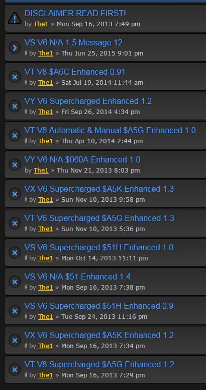

Dylan wrote:Im on my phone but go to the enhanced thread and just click on vx v6 na or however it's worded.
Then windows does it's download prompts.
Had another look, Cant seem to find VX v6 NA. They have VT,VX supercharged and VY, But no VX NA.

vx_commodore
Posts: 53
Joined: Sun Jul 05, 2015 10:38 am
cars: Vx commodore V6 Auto.
Re: Can anyone help out a newby with ECU logging/hacking?
Post by vx_commodore »
Oh, Sorry i must have looking in the wrong place.
Ok all downloaded.
