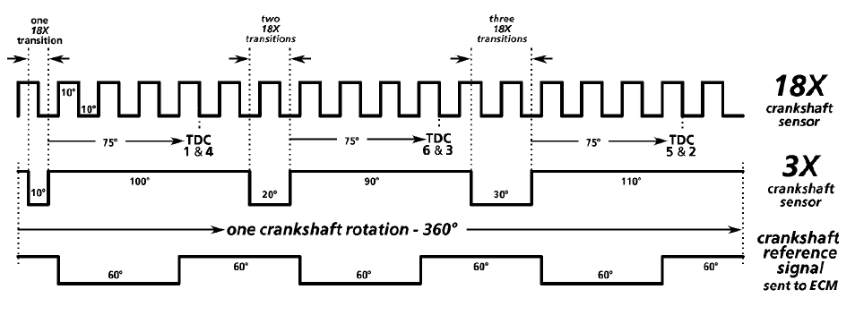

Are you doing the 3x/18x v6 trigger?
if so it needs to look like the image attached.

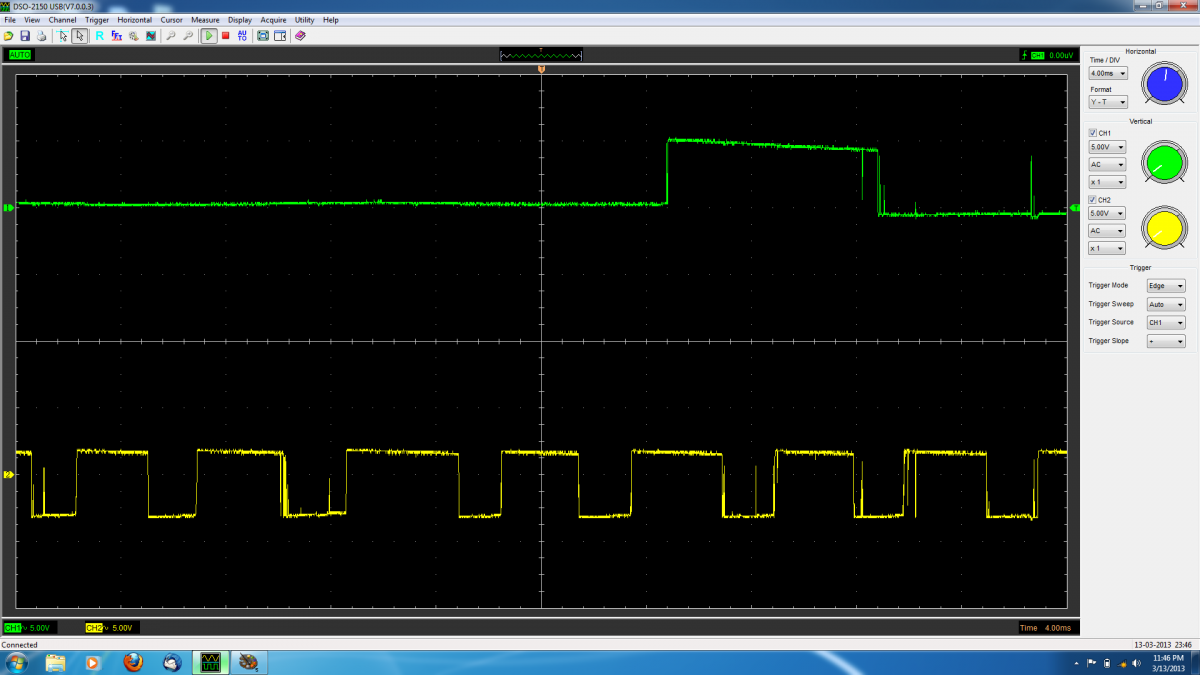

OK So after looking all over the net for someone else that has had success with the nissan cas i have had no luck. I swaped the 18x back to the outer ring and rejigged the 3x starting point. I seem to have less garbage spikes like this .Picture below showing (red circle) how the Pulse width of the 18x is altering with a constant speed .This changes throughout the sample.....

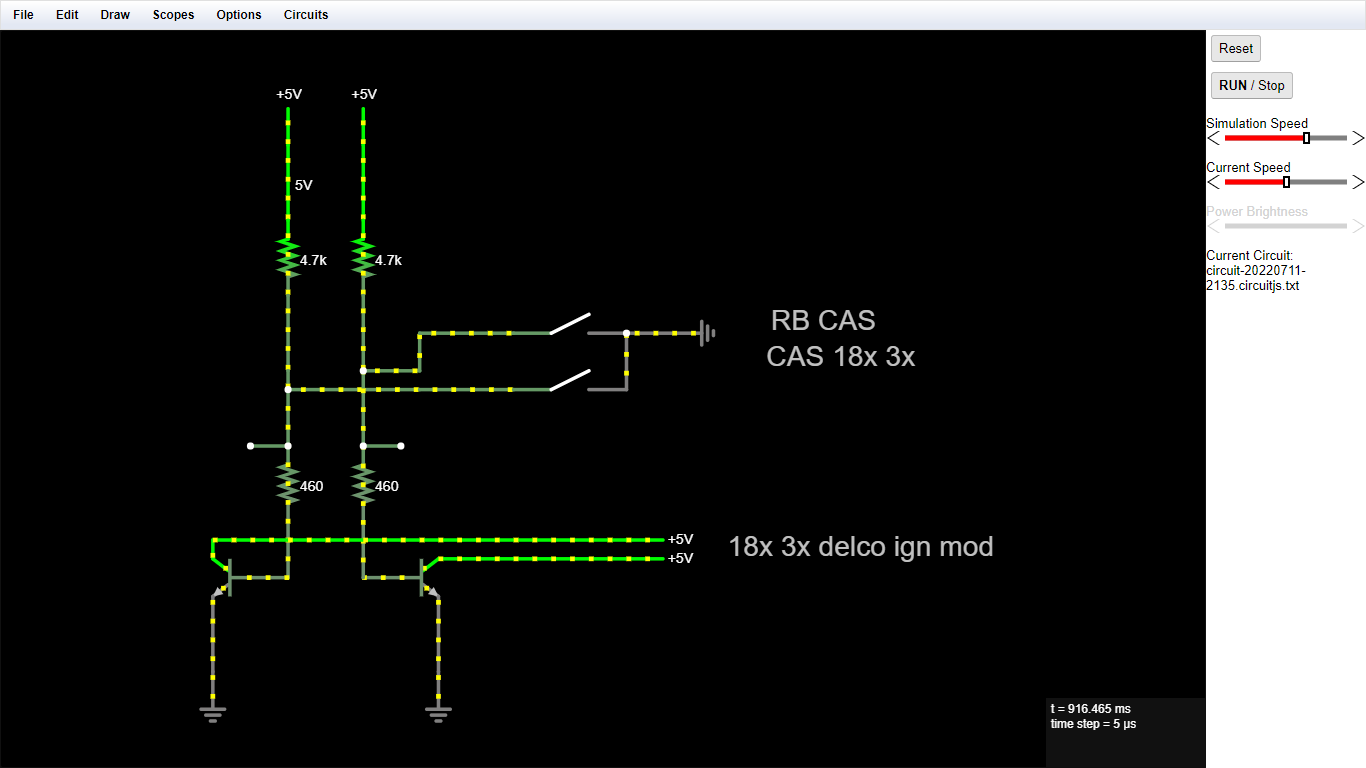

The circuit i have used to join the RB CAS and the delco ignition module seems to work but i am not 100% if my problems are in my circuit or elsewhere.....
There is no point me playing around with the 3x signal if the 18x is not stable.
I am not giving up yet .... Any help would be appreciate...

Ive been back to my notes to see if I can find anything useful, all I have is this of one of the failing modules. It looks like the noise is higher frequency than you are seeing, maybe I am just that burnt from this system. Stock car, VL400 prototype module, stock pattern.
