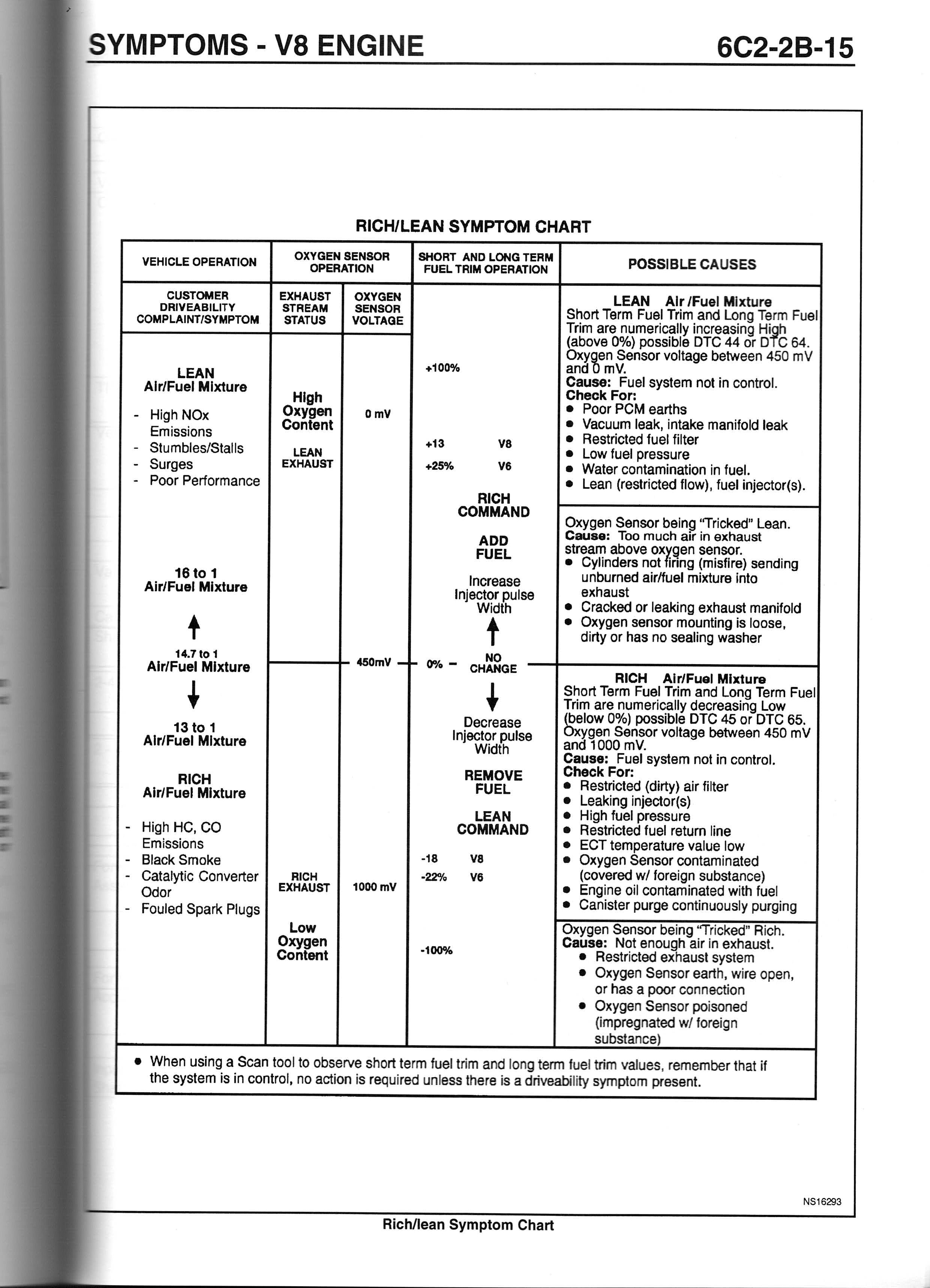

Here's a scan from the VT engine manual with some things to check.
Make sure the engine earths are all correctly located (clean and tight).
Make sure there are no vacuum leaks (in the intake and exhaust system).
Make sure the PCM is correctly earthed (this includes the wiring loom earths in the engine bay).
Make sure the O2 sensors are fitted correctly.
Make sure the fuel system is clean.
Make sure coil, spark plugs, and leads, are in good working order.
Make sure wiring loom is fitted correctly and connections are clean and secure.
