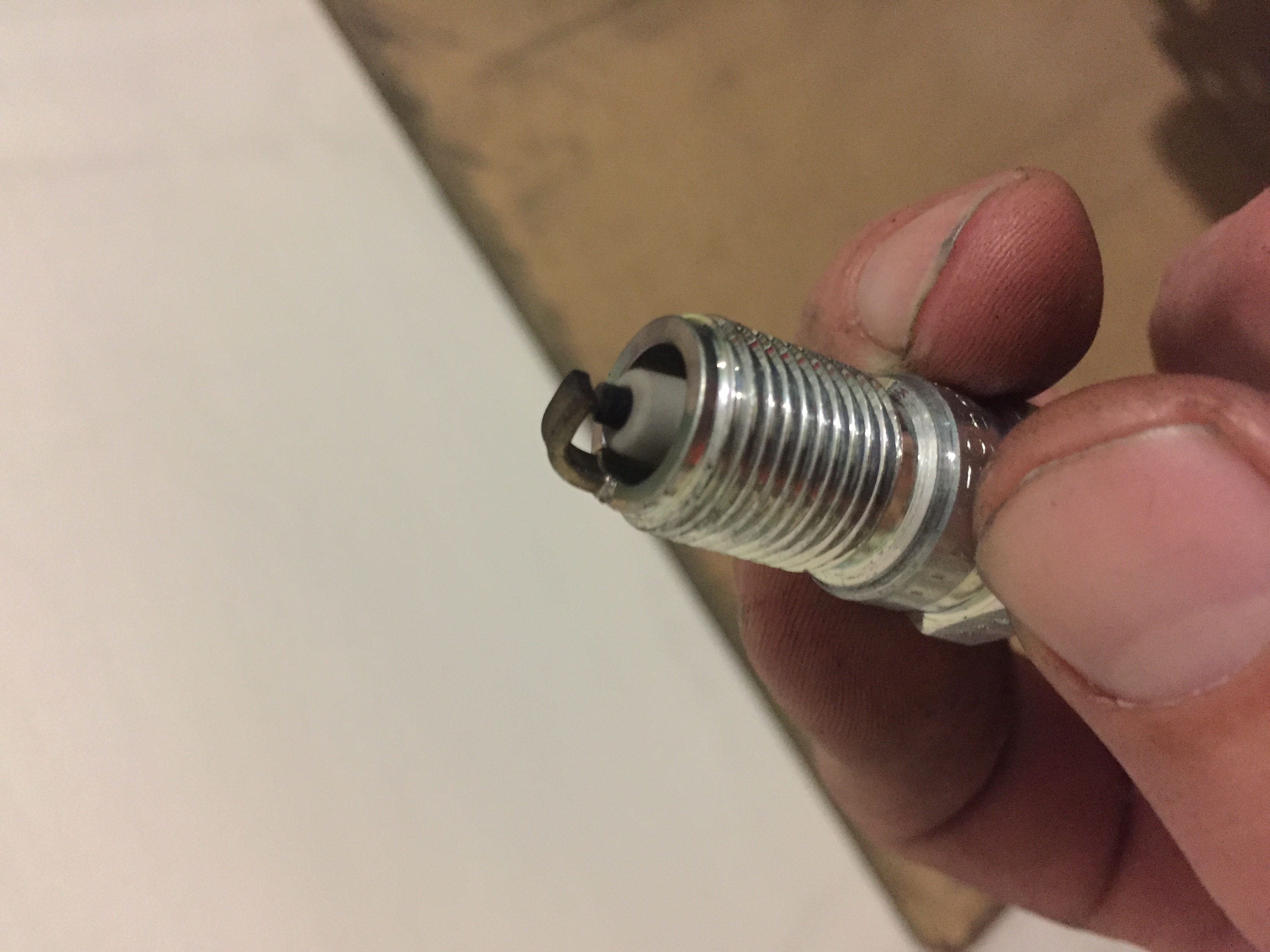

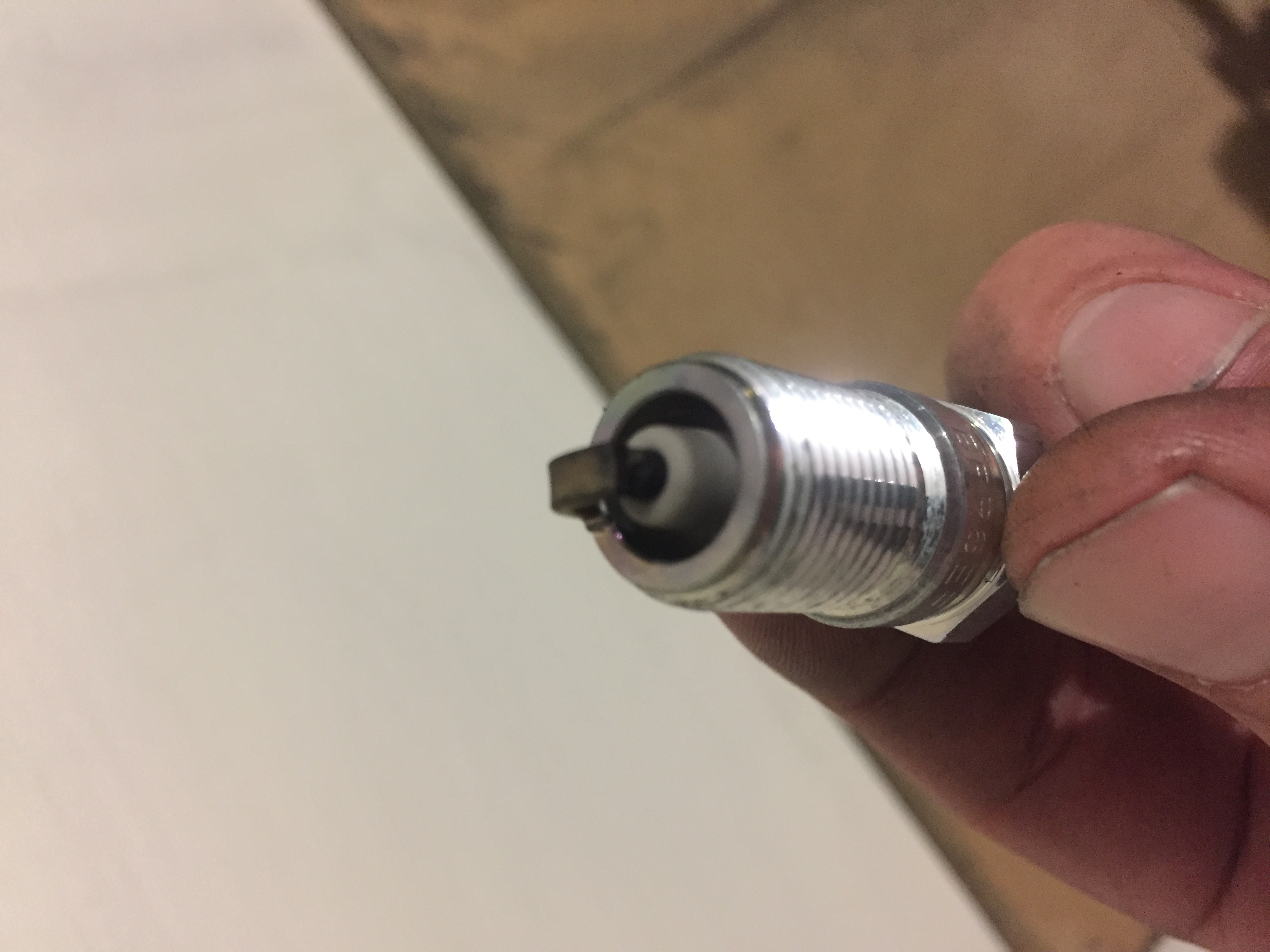

Post by Wade »
This is one of the new plugs after starting, logging and letting it run for a bit.
Posts: 3364
cars: VR Commodore V8
Re: vr v8 turbo base tune
Post by Dylan »
Yeah to lean. Always good to see a plug as a bit of reassurance.
