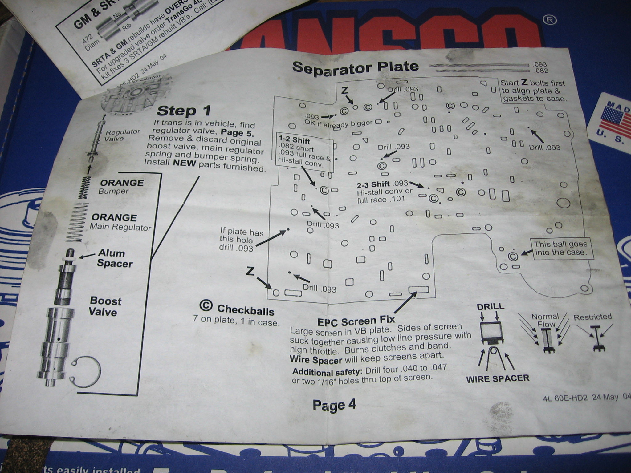

so have found out why my trans makes the front of the car dip on the 2-3 change bloody old transgo instructions with my kit dont have instructions for 1 hole which happens to be the 2nd gear band release hole so its in 2nd and 3rd at once on the change. this will be the one hole i dont just do huge like the rest ill start at 0.110" drill instead of 0.157" and if it still does it go slightly bigger dont want to go huge and have it flare between changes .will be great when it stops slowing down on the change might fully slam 3rd with it fixed

Post by Dec_head »
I have transgo stage 2 instructions here somewhere if you need any info
i remember it did mention something about checking certain servo piston numbers as well

couldnt scan and post page 6 seperator plate drilling its hole g that isnt explained properly confuses people

Re: DELCOS NEW RIDE
Post by Dec_head »
mine had the seperator plate on page 4 not sure if it was the same was 4l60E

Re: DELCOS NEW RIDE
nah 4l60e is different and only has instructions for one type of valvebody in the one set of instructions .the t700 version has 2 intermingled between each other for 2 different valvebodys

Re: DELCOS NEW RIDE
my powerglide one had the pages printed in the wrong order :P
