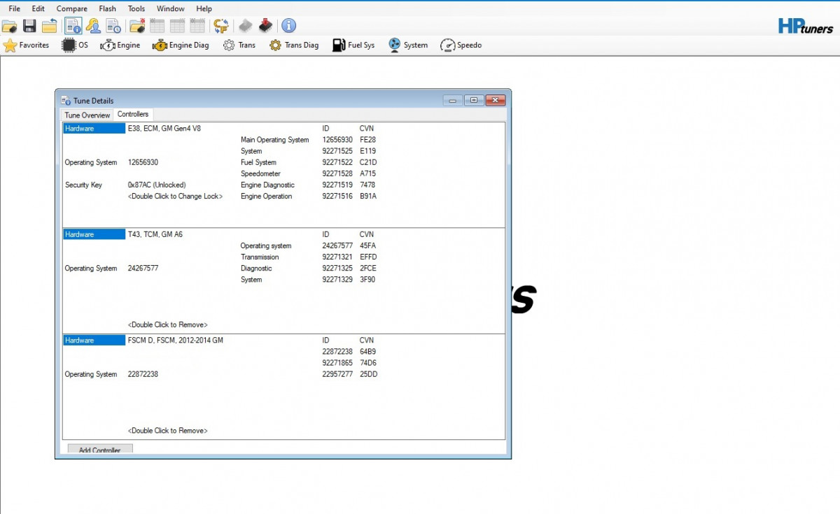

The screenshot attached shows all the versions I'm running.
It's pretty much there now. Just this pesky SVS alert, I changed the A/C pressure switch to be SES only, then with a CAN logger hooked up, plugged in/unplugged the A/C pressure switch which triggered the 'Service Vehicle Soon' on and off on the cluster so now the message can hopefully be singled out and translated from VF SES to VZ SES.
Interested to see how yours goes, good luck!
