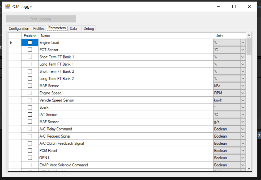

None of this actually works yet, but you can see where it's going...

bubba2533 wrote:Pumped for this! It might give me the motivation to do more work!
It's ready for testing: viewtopic.php?uid=5483&f=42&t=7053&start=0

It's in the Windows Store:
https://www.microsoft.com/en-us/p/pcm-l ... verviewtab
There's at least one big bug: If I try to log just 2-3 parameters, it logs them every 3 seconds or so. After I get a few parameters it logs them at 100ms intervals. This is using an AllPro or an ObdLink SX. I think the PCM might respond before the interface is ready to read the response, but I am not sure of that.
Oddly enough, the SX seems to be slightly faster than the AllPro for data logging.

Post by NSFW »
I have both, yes. I switched computers and don't have the LX working yet (or anything bluetooth) but if you want me to try something I am sure I can get it going again.
