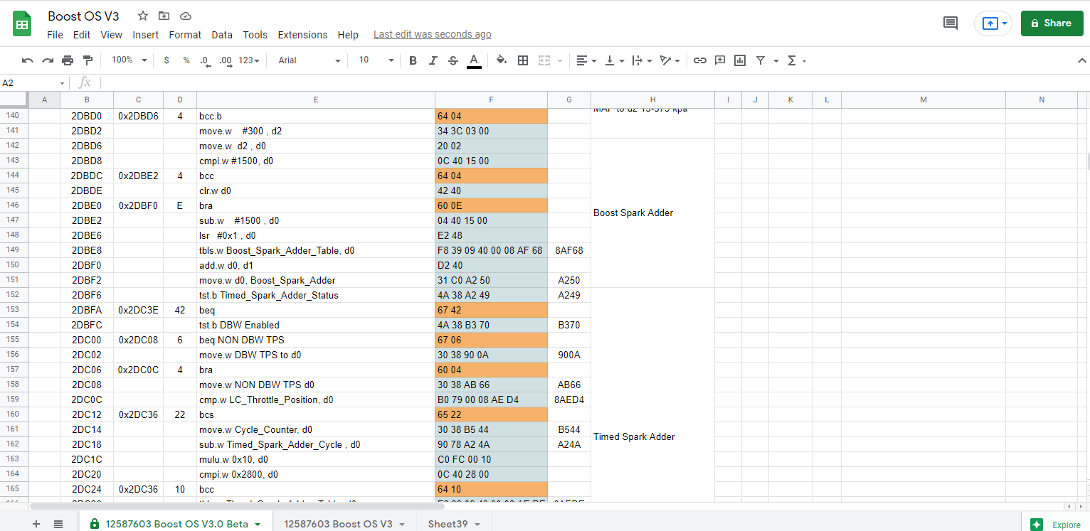

I think I will still at some point want to write a function or two in C because it will allow me a very easy way to change code and retest.
It's going to take me some time to get everything ported out of google sheets and into a true ASM syntax, but even then it should be easier to make changes vs. what I was doing before.

Ok, gotta ask ...
How are you doing this in a spread sheet ??
Re: C development and patching for P01/P59
It's terrible....
I've been too embarrassed to show it previously, but now I hope I'll never have to use it again.
It is mostly just text in a lot of the cells, but I have some calculations to try and make it easier. Most instructions are very simple and it was mostly copy and pasting the correct hex values. The hard part is the branches because if I changed any code between the branches I had to find the new branch location and value. I made a few mistakes, but for the most part it worked. It just took so much time I should have forced myself to do this before, but I just didn't know enough at the time and I wanted to get it done.

Absolutely amazing ... I'm impressed!

That is definitely not the way to do it... but.. I too salute your eagerness to learn and your will to do it while you come up to speed. also your persistance to be up to v3 beta with code entirely assembled by hand. You've probably learnt a lot of lessons this way and got a solid understanding of how it works to move forward with! Well done!
