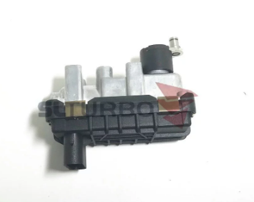

After a whole lot of googlin' I purchased a couple of these Electronic Wastegate Actuators. Doing it electronically I can guarantee exhaust restriction and VE across the RPM and MAP cells so the VE will be known and AFR's should stay under control. It'll also give me full boost control at all points in the map.
Google says they're either PWM or CAN controlled, the Hella versions support both so fingers crossed these do too otherwise I'll need to do some bruteforcing CAN bus addresses to command the vane position.

A little more googlin' shows these are dumb units, just direct motor control with a 0-5v feedback on actuator position. Removes the guesswork I guess!

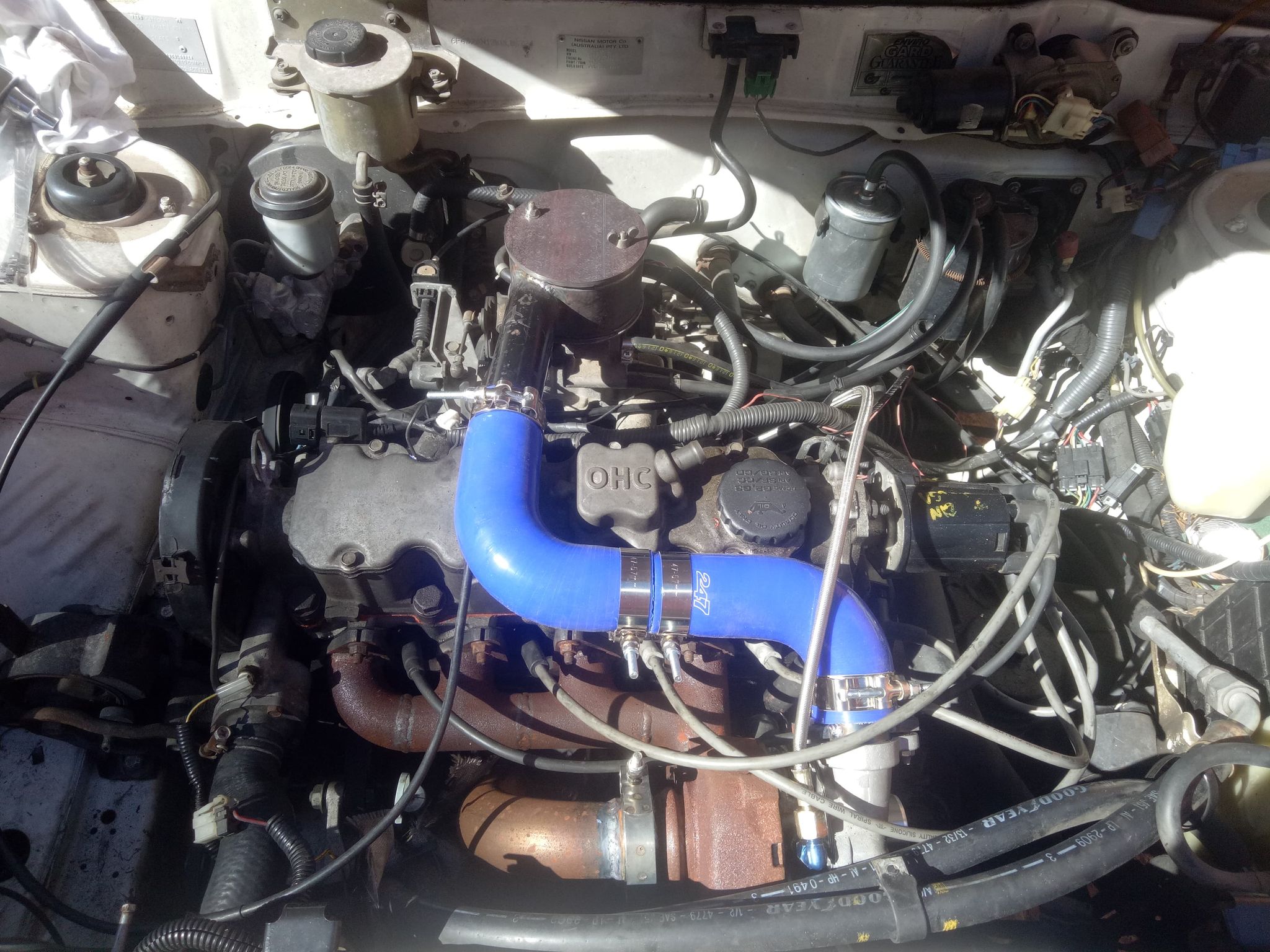

The silicone elbows, clamps, turbo beanie, exhaust wrap and o-rings arrived! Still no sign of my o2 bung drill bit, and still a week until I get my wastegate actuator. I'll wait to wrap it all until the bung is in and plumb the blow-off in when the actuator arrives.
I'll install the 2bar map sensor after lunch and see if its making any boost with the nozzle fully open. I'll also get a chance to see what the IAT's are doing at WOT.
The Wastegate controller code is good enough to manage the boost. It monitors manifold pressure and if under 80kpa it keeps the nozzle fully open for best effeciency off boost and once over 80kpa it'll begin controlling the nozzle position to maintain the demanded boost per RPM cell and keeping within the nozzle % limit per RPM cell. I think this will make tuning fairly simple as WOT at target boost will have a repeatable VE. Maybe.

Looking good! Im quite excited about this build

Thanks antus!
A Couple of questions - Will the brake booster be ok seeing a few PSI or will I need a stronger one-way valve? How about the charcol cannister or is it best to just blank the canister ports off?
- Posts: 10111
Re: Low RPM + High boost = Bent rods?
I would put check valves on them both, or at least the brake booster and remove the canister. Not sure if its completely mandatory though.
- Posts: 5714
Looks like the booster allready has a check valve weve fed over 20psi into a plastic commodore one with no issues
- Posts: 2332
If you're boosting, how does it pull vacuum to operate the vacuum operated elements or do you rely on stored off boost vacuum to run them ??
