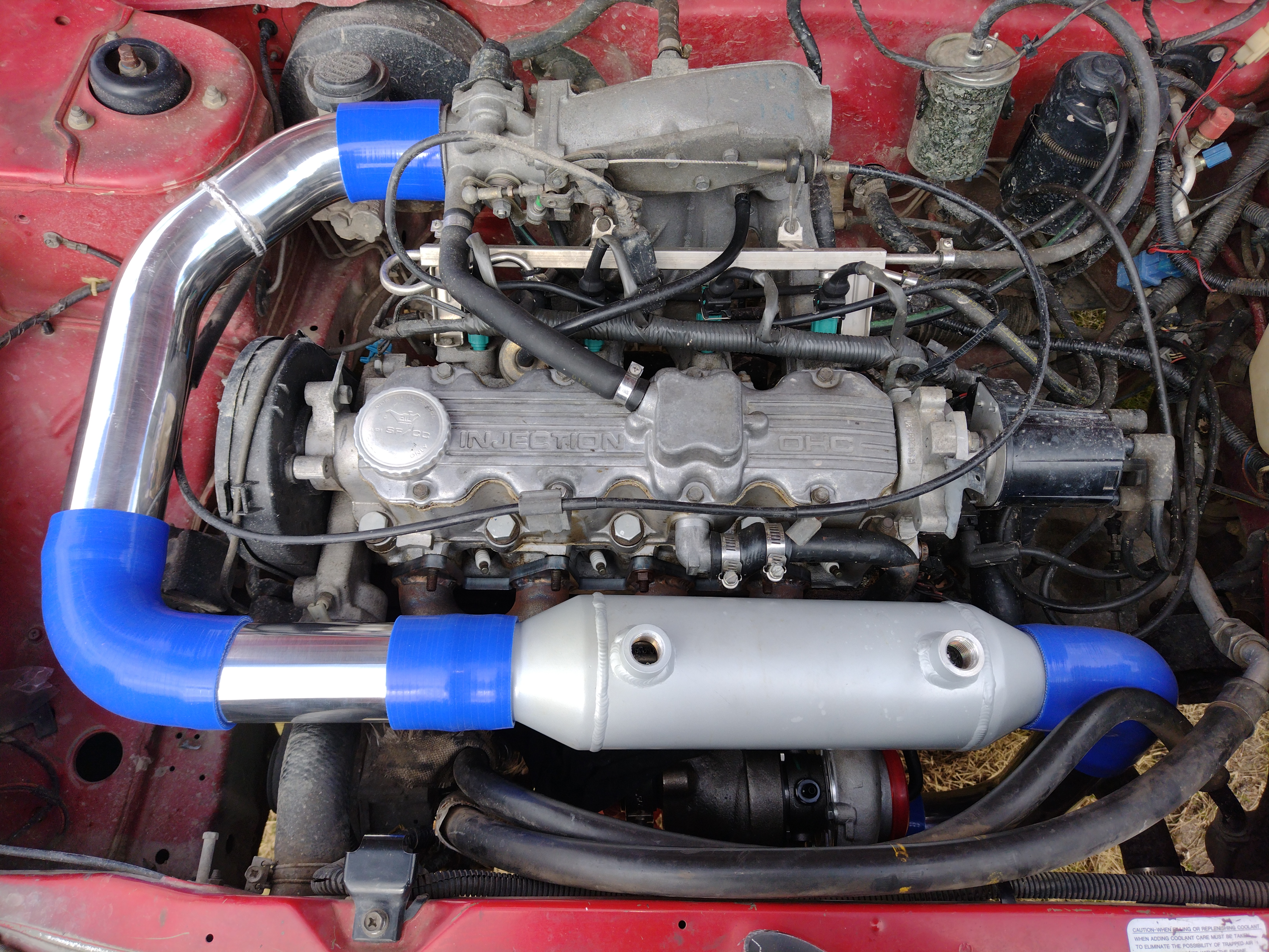

A small update on the build, intercooler piping cut, welded and everything fits nicely. Almost ready for tuning!

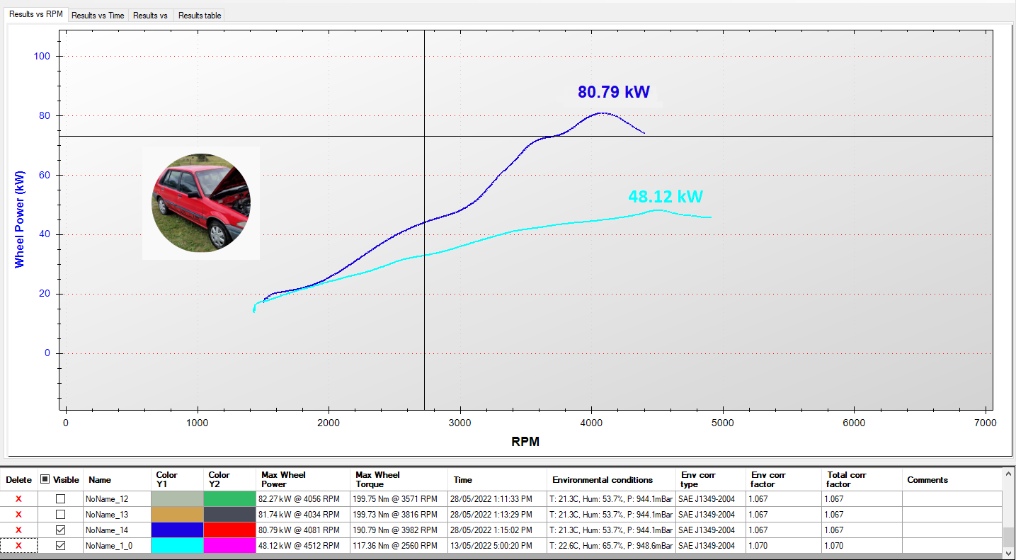

N13 18LE+T dyno day!
Stock: 48kW. Turbocharged: 83kW (at the wheels)
10psi, 85% injector duty (11:1 afr)
Not quite the numbers I was expecting, a healthy boost in torque from around 2000rpm up until 4000rpm where torque begins to take a dive and with it, so does HP. At this torque, if it held steady until 5500rpm, we'd be seeing ~100kW at the wheels.
I know this Saab GT17 can flow 200HP so that's not the bottleneck. Possibly valve float?
I'll pop it back on the dyno today to try find out why the dip. There is a small RPM spike in the ecu log that isn't on the roller log. Maybe clutch slip, maybe it climbed off the back rollers.

Very likely valve springs. They loose tension with age and Ks. Also the general rule for boost is at a min to increase the spring pressure by the same amount in boost psi x the intake valve area in square inches. So for eg. 10psi boost x 1.5"2 = 15 lb stiffer springs over stock.

The workshop manual says 300N (67lb) spring force when the valve is closed. I'm not so sure it's valve related now though, before gapping the spark plug the torque dropped off sharply around 3300rpm. After gapping them down to about .8mm it's moved to 4000rpm.
Is there any information on how to adjust the dwell settings in 12p?
What was interesting is with the larger gap at 3000rpm, AFR's never went lean which I assumed misfiring would cause? Likewise at 4k now, ARF still on point.
