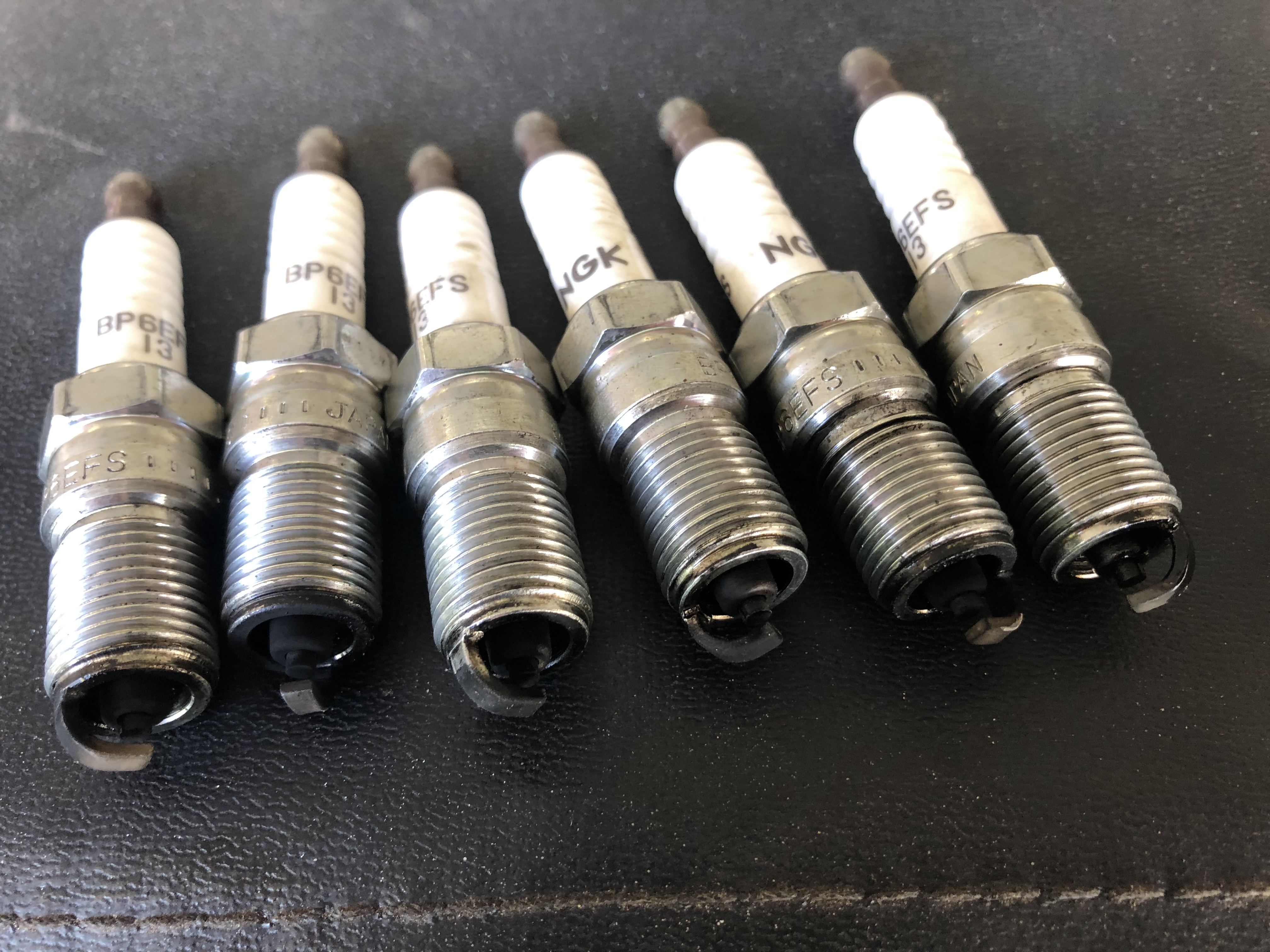

Re: Help needed! converting 202 to delco
Alrighty, well good and bad news. I got it started but it runs like dog crap. I’ve uploaded the straight 6 tune onto it. It took a push start to actually get it running has it can’t start off of the starter.
With the Straight 6 tune did you,
Under Scalar, set EST params - Spark reference angle too 10deg?
Yep, sure didMechcano wrote:With the Straight 6 tune did you,
I’ve attached a photo of the spark plugs. Mind you, these are brand new prior to starting
Turns out you were on the money! I did set it beforehand but since I reuploaded the unchanged one again (to double check it was the right tune) I forgot to set the initial timing!Mechcano wrote:With the Straight 6 tune did you,
