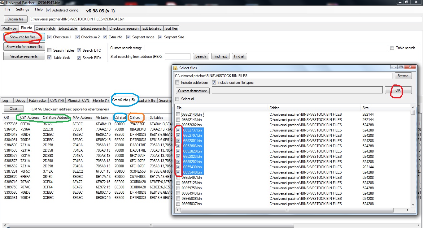

Here is some basic instructions how to get info from various p04 files with universal patcher.
Open program and goto utilities->patcher.
OS crc column is the checksum of main code. If that matches between stock bin files with different OS number, than they can be considered identical in terms of crossflashing and tuning definitions. Only calibration differs. Much more like ls1 files, but here we don`t have p/n defined to different segments we have only p/n to calibration area. So we can define a new OS p/n using the OS crc and some custom labeling like p04-case1->list all cal p/n
Cs1 address and OS store address columns are needed for checksum calculation when changes are made to bin file. These 2 dwords are excluded from checksum and the checksum is stored at CS1 address[4 bytes long word sum]
3d tables column, list most of the 3d tables found in the bin and the size of rows[:13=13 rows 3d table].

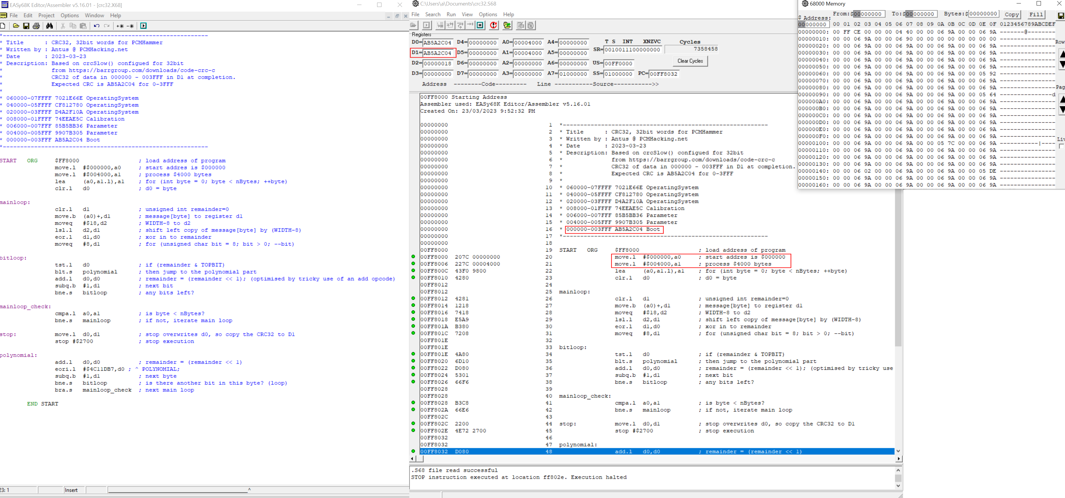

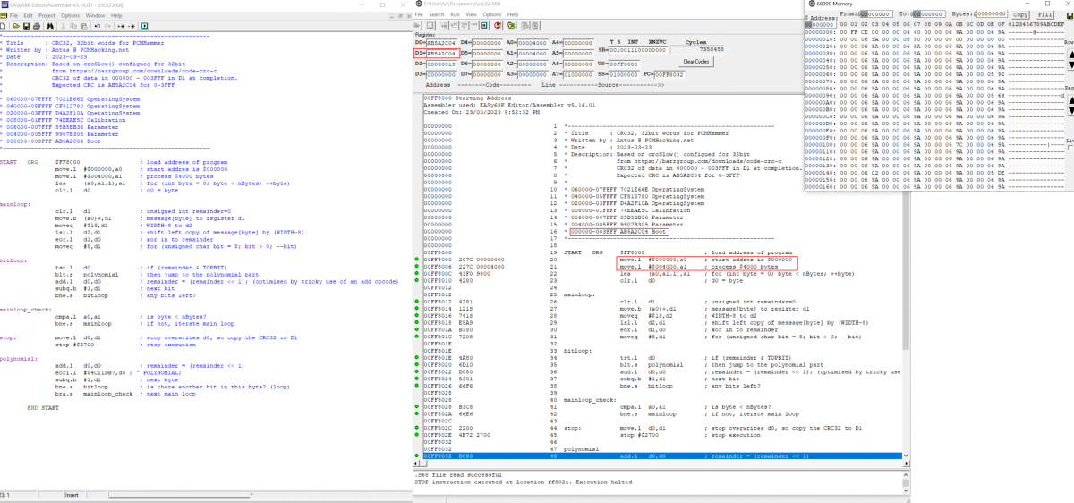

Here is the same code, with the optimisation and setup for Easy68k. This can be loaded and assembled, then in easy sim load the test bin memory image, and hit the play button. Emulator should run the crc function, break and show the calculated CRC in D1, which should match the expected.
So if we remove the code that sets the start address, and length, and assume the function is called with that data in the registers already, and we remove the 2 opcodes at stop: which is only for easy68k the crc32 function is down to only 44 bytes of code, and no memory as its registers only.
edit: I probably didnt need to copy the CRC to D1, but there was some stability issues in Easy68k when I was getting it running. It looks like overwriting D1 was a bug I was triggering in the emulator, as now its working fine, D0 seems to be fine every time. So by default a .S68 memory image of the same name as the executable is loaded, and by default ram is empty. So if you put the bin.s68 file named the same as the code it loads and is overwriten/truncated to about 1kb. This might be the bug, because then you need to go and load another copy of the bin, and things get strange after that. This is why I named the .s68 file differently to the one containing the code.
