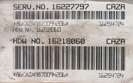

Post by Gatecrasher »
I won't have time to mess with it until later tonight.
I pulled software for a module similar to the one Antus posted earlier. I didn't buy it. I just picked the auction because it had VIN and a legible end item part number on the label.
https://www.ebay.com/itm/254362473299
It's 512k. It'll be up to you guys to decide if this qualifies as a P04 family module or not.
Utility, OS, VIN info and software info included.

Gatecrasher wrote:I won't have time to mess with it until later tonight.
Looks to have the same DLC and Flash registers as the P04, as well as COP's ... Not sure on the load address.
It is older then the typical 512k (P01 look alike) P04, obviously it looks completely different other then the twin 80 pin connectors, even has CLEAR on one.
That adds another alphabet to the mix ...
-Enjoy
