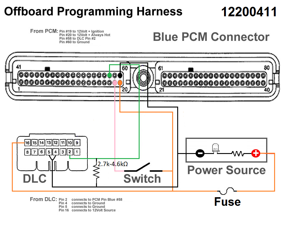

1) P04 ECUs are a heap of shit in terms of how there DLC (VPW) is handled internally. Not only does the OS affect how stable the comms are (Even when running a kernel), but they do not apply a strong load on the bus line which can result in them dropping frames if the bus line is not loaded significantly during read/write at 4x speed. Pete and I discovered this after monitoring the VPW pulses, and adding a resistor between VPW line to ground (2.7-4.6k was ideal) to help the DLC clean up its signal.
This issue did affect when using GM MDI when performing a flash update, where the DLC dropped to 1x mode when it detected too many errors on the line (Which also affected the OBDX VT in the same manner), keep this comment in mind. The GM MDI also logged this, and continued flashing at 1x since its internal DLC dropped to 1x also.
If this is the issue, then shouldn't I splice in a resistor into my bench harness and check?
Yes, you could test this and see if it helps at all for you.

I pulled a couple resistors out of my electronics bag to try this but they had no continuity so I don’t know if I have any working resistors. I have about 10 left so I’ll check them.
Which pins exactly should I splice into? Don’t want to muck anything up by not asking simple questions.
zack4200
Posts: 116
Joined: Fri Jun 24, 2022 3:35 pm
cars: 1982 Chevy Chevette 3400 LA1 swapped
1986 Chevy Chevette
1998 Chevy s10
Re: New PCM, is it dead?
Post by zack4200 »
DLC pin 2 to DLC pins 4/5, or PCM blue 58 to PCM blue 60
I also modified the diagram Gampy shared a few pages back

zack4200 wrote:DLC pin 2 to DLC pins 4/5, or PCM blue 58 to PCM blue 60
Perfect. I’ll see if I can find some working resistors. RadioShack went out of business 15 years ago so I don’t know of a local place to buy any if I don’t. I’ll be at the mercy of Amazon.

ProfessWRX wrote:I pulled a couple resistors out of my electronics bag to try this but they had no continuity so I don’t know if I have any working resistors. I have about 10 left so I’ll check them.
Check for resistance, not continuity ;)
