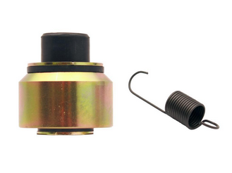

Do you have headers? Often with a larger cam, the headers have a clicky tractor like noise due to the much stronger exhaust pressure/rarefaction waves. This is often mistaken for lifter noise.
As for the cable damper, they are pretty simple.
Rare spares sell them.

The clutch damper is pretty much what I have, but I have no idea where that spring connects up to. I know it goes over the cable to hold it off the exhaust, but no idea exactly where it goes and what it connects into.

As for the spring on the cable, I have no idea, but on some FB there were one or two people that insisted it was attached to the brake line on the inner guard and claimed that VN to VS came like that from factory, even though I have seen zero evidence for this, so I speculate the spring might be a thing they did on the really old model well before VL for example since that damper kit covers all models that used the damper.
I never saw any pics or mention of this spring in my Gregory's workshop manual for VR commodore. Most of the pics in there are of brand new cars at the time, so they should have nothing missing. I will double check my manual is case I have missed it, but I am sure I have covered everything a million times in that manual.
On some cars I had to do nothing to secure the cable, sits well away naturally, on my daily I cable tied it to the mentioned brake lines. No issue with the headers, it's actually broke one of my ignition leads at the plug once and that is what the cable often wants to rest on, the ends of the lead sockets.
