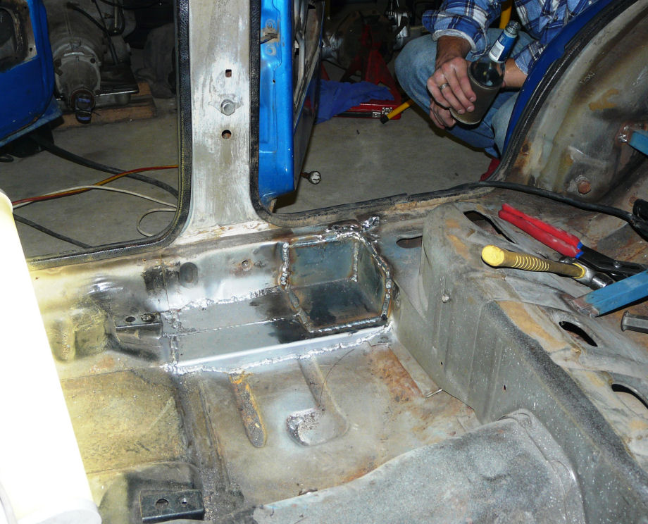

well both base plates are in now, so next is the main hoop :punk:
been slow progress, but i had to weld a plate in on the passenger side before i could weld the base plate in over the top of it so that took up a bit of time.

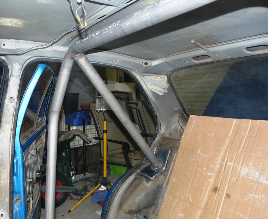

well dispite only having a few hours which i thought would fly by i actually got a fair bit done!! very happy!
got the main hoop in
and one back stay!

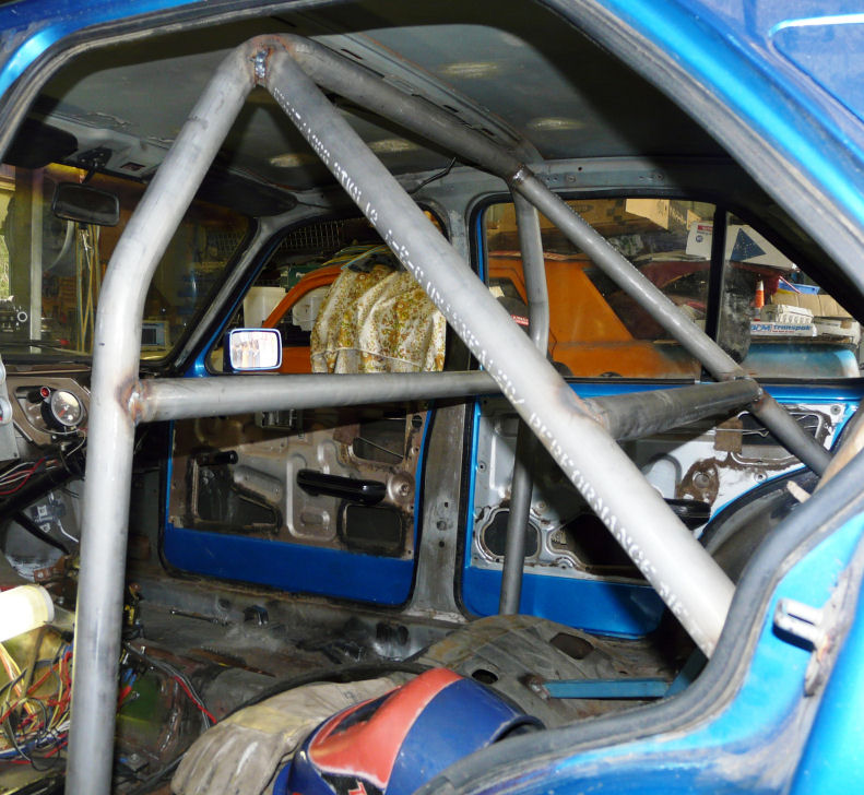

well got a good days work in today :punk:

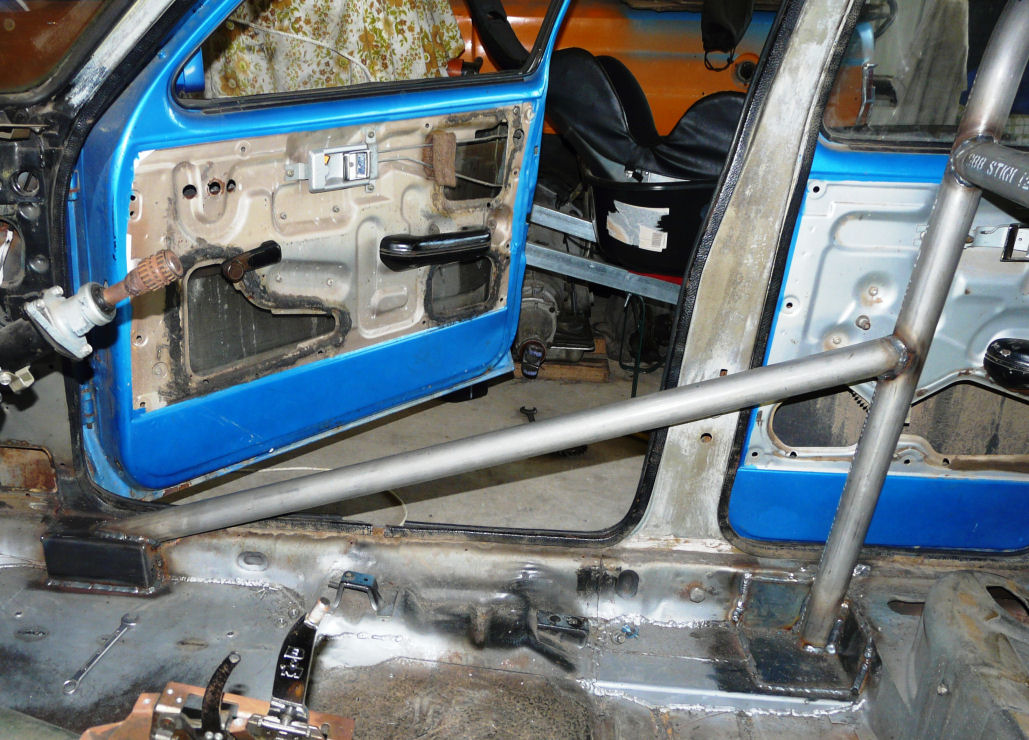

in the above pic you can see the taxi bar installed, also i have installed another horizontal bar on the rear part of the back stays, this is for the old harness to attach to.

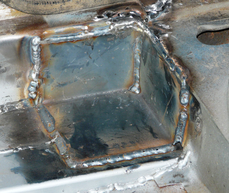

driver side intrusion bar is in and done, took me a while to make the box to attach it to near the front of the door, but i'm very happy with the result, and i reckon she'll be strong as!
you might be wondering why there is so much pad infront of the pipe left over .... well this is for when i decide to go full cage i have the mounting point already to go for it.
still got to do the passenger side mounting pad and intrusion bar, but thats for another day, im stuffed!

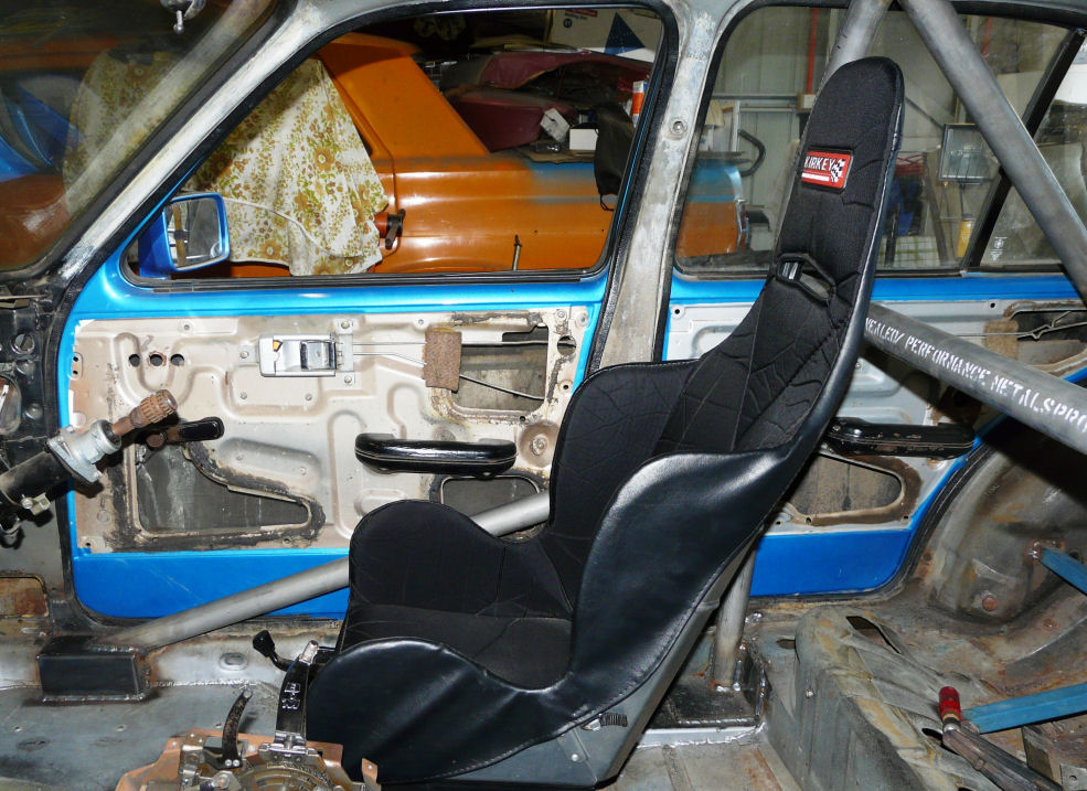

also plans are to make a mounting point off the taxi bar to attach the seat to the taxi bar, this is for some support of the upper part of the seat.
