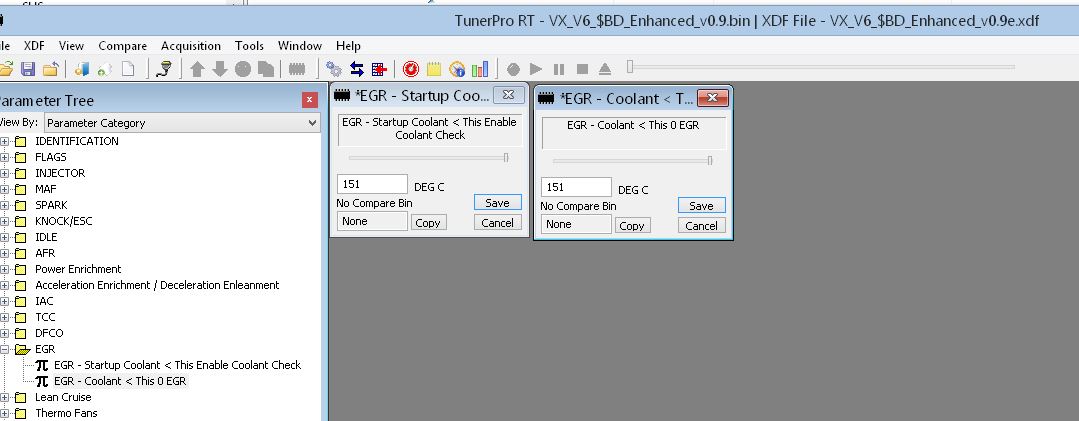

what settings have you got, the below should work.
- Posts: 5714
Re: The1's Enhanced Factory Bins
I never changed the one labelled coolant check I'll reflash today and see what happens 100% egr going up hill at 80kmh sucks lol
- Posts: 4853
yeh factory ones at 5c so wont enable the coolant check.
ahh yeah that would do it!
- Posts: 5714
Ok startup coolant check temp has sorted it she doesn't activate now thanks
