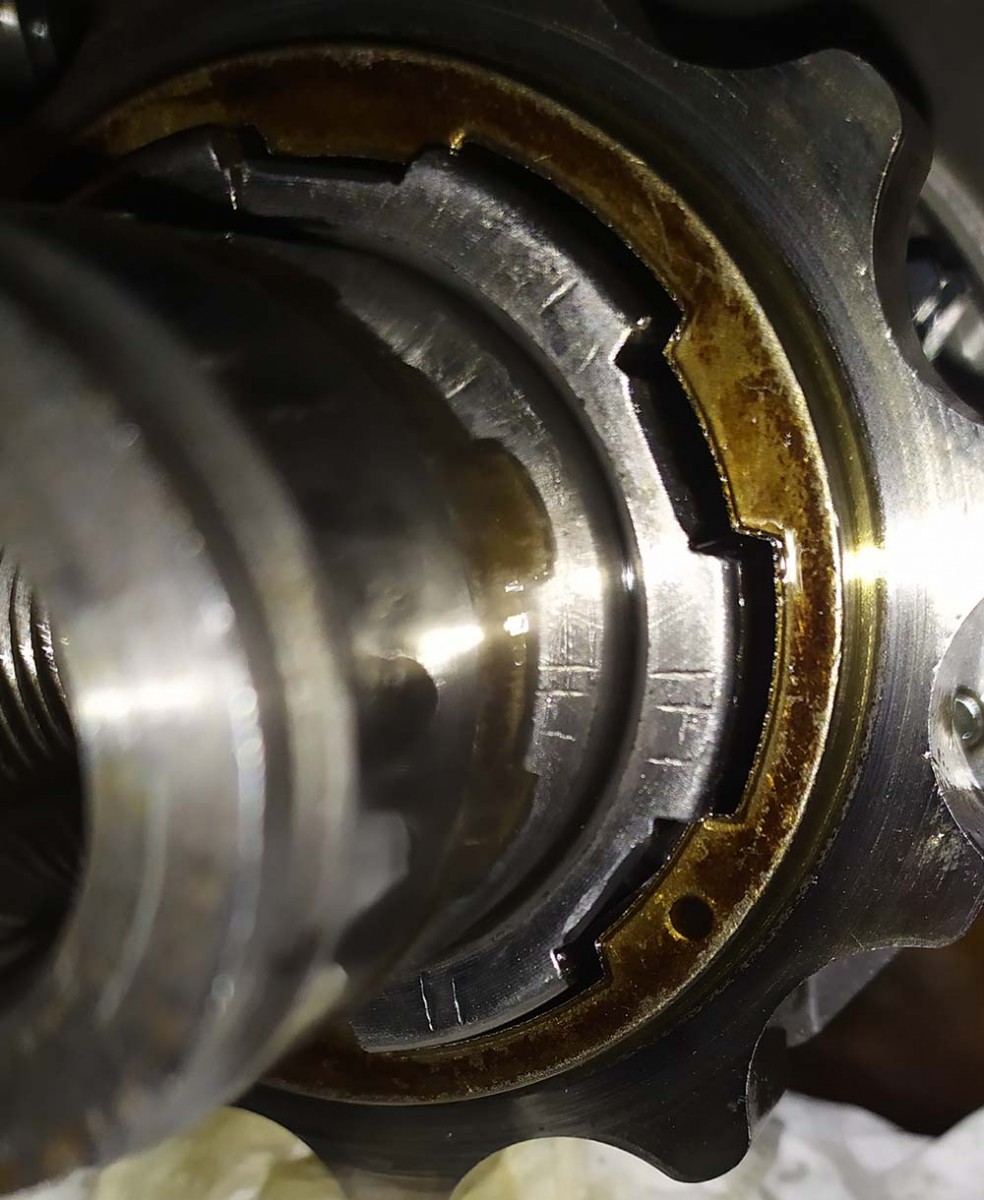

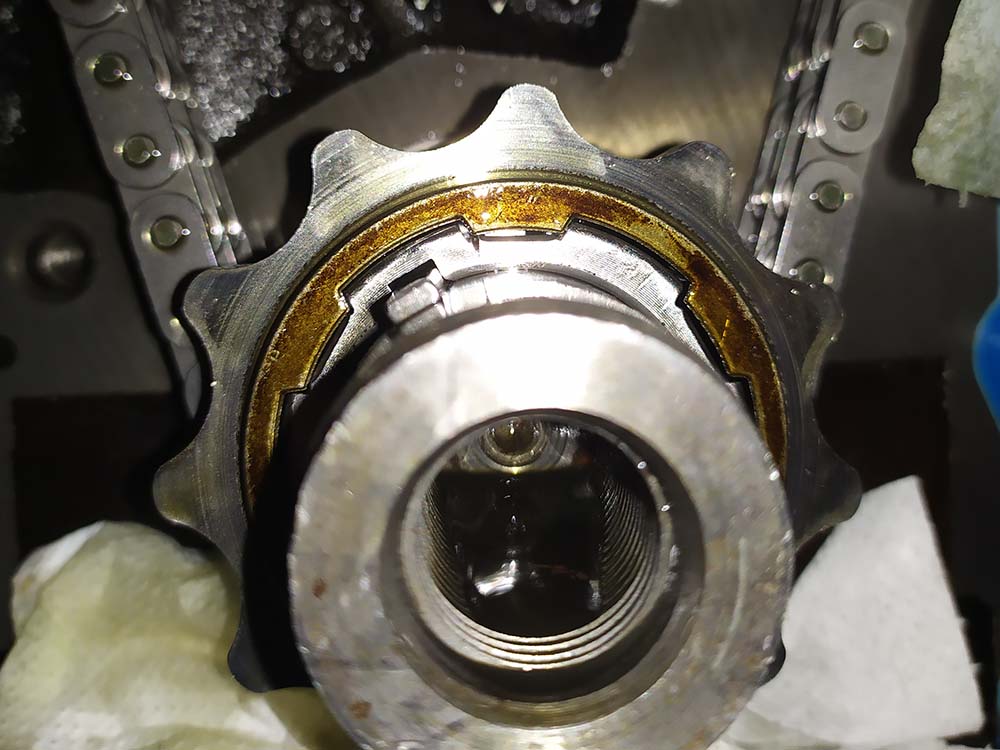

Well pulled the front cover off today, found the oil pump worn quite a bit, it was 90% good when i fitted it originally, engines done 2000km's now with not alot of work. I checked crank end play best i could looks around 0.16mm, Looks like there's alot of movement on the oil pump cog to the rollmaster crank cog is there normally this much movement back and forth? It allows movement side to side if you get what i mean, which wouldn't help with even wear or rotation of the oil pump gears. You can see the oval wear marks on the oil pump cog, The oil pump cog on stock crank cog is tight as. The rollmaster crank cog has a fair gap, really it's only just grabbing by just under less than half the teeth depth.
I have the Mace sold RLM601 Rollmaster Double Row Chain kit which has CS6150 written on the box.
Are these the best ones still? I searched for CS6150 online and some listing say this wont fit Holden L67 but will fit the US ones?

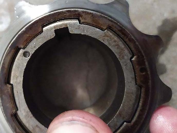

Stock Rollmaster Crank pulley wear.

That is very odd. I also used the mace 601 for my VP motor and it was nice and tight, also my 6 spline drive was a nice forged piece that was uniform and smooth with slightly rounded edges, yours looks rough as guts. Mine did not have sharp inner corners nor those lines on the face. Maybe they have cheaped out on the manufacture of them?

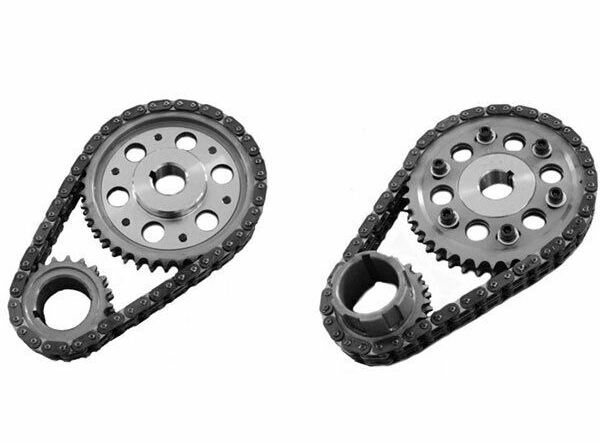

So what confused me for a long time is the Mace and ZZP ones are half the price most other places list them at and I think I have worked out why.
Turns out there is a vernier type as well which explains why it would cost so much (around $300)
See on their website.
https://www.norndaautomotive.com.au/rol ... 20VR,VS,VT
- Posts: 8600
Re: The1's Daily
I bought mine about the same time, looking at some old photos I got mine late 2015 from Mace.
Also I found a pic of the more expensive vernier type, PN CS6240. It's also nitrited on both sprockets. The 7 keyway red series one like you and I have are only heat treated? nitrited? on the crank sprocket.

They are billet but simple multi keyway and no nitrited cam sprocket. The vernier one has a 2 piece cam sprocket and what looks like a one piece crack one and fully nitrited. That accounts for the cost difference, this vernier one would be considered "gold series"
