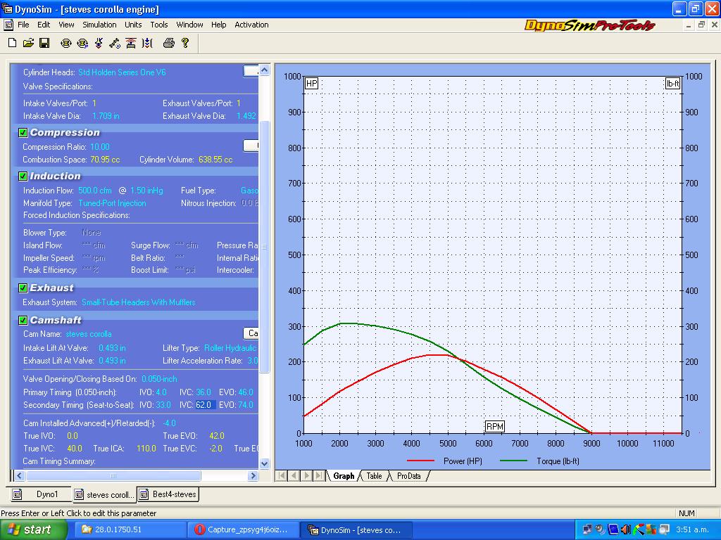

allways fun having a play on dynosim looks like shes had a good update from my old version few goodies in that new one just looking at the screen.heres my mates v6 street cam simmed on stock s1 head flow figures just 10:1 with cam small tube headers with mufflers all that v6 torquey goodness :D

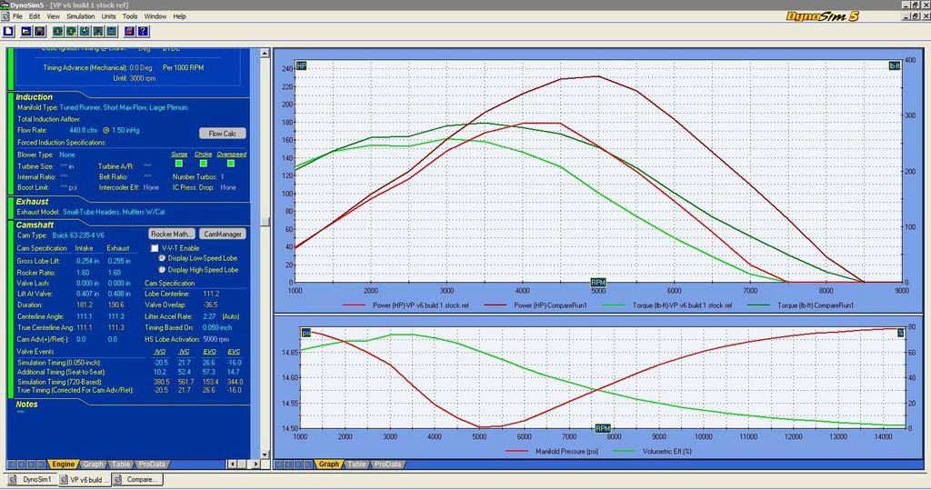

I see you used the tuned port injection. I found with that selected my stock engine made peak power less than 4k rpm and peak torque was over 300 ft lb and the curve didn't look like my dyno run.
I selected the sports compact (short runner, large plenum) manifold and simulation suddenly became almost spot on, rear wheel torque and power figures matched with in few hp and lined up with the dyno. Also very similar to factory flywheel specs too.
even shows the twin torque peaks at same rpms as the dyno. So I used that for my basis
I also managed to get much smaller cam than yours by the looks with similar power. I used the iterator running 10s of 1000s tests to optimize my basic cam that I started with to improve torque and power while reducing the size of the cam at the same time, some hand tweaking as well.
