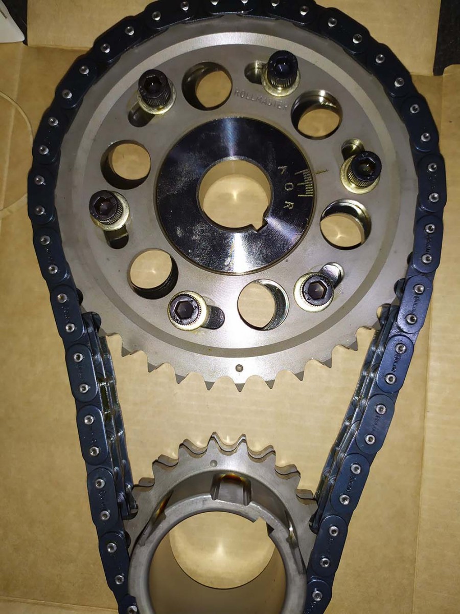

I'm interested in getting the vernier ones for my next build. Should be much easier to dial the cam in spot on and better quality by the looks. The sprockets are a darker metal from the nitriting and I noticed the cap head screws have serrated washers which is well thought out.
I'm and guessing these are used in speedway a lot.

That's the one I was looking at. I noticed it has degree Advance and Retard scale engraved in the center hub too.

new rollmaster kit arrived today, much better fit for pump gear, the crank gear is also one piece.
- Posts: 2332
Re: The1's Daily
Wow, nice sprockets ... cheap chain.
