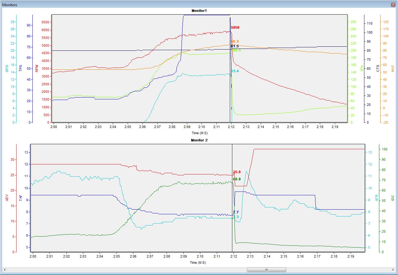

so heres the data log, you can see we get it to about 3500rpm, he locks the dyno at that revs, then I put my foot down, and pretty much just as I got to full throttle he lets it go for the ramp run.
and yeah I believe there is too much slip at the top end, that's revving similar to what I do across the finish line but its 96mph instead of 123mph I had before with the slipping trans.
- Posts: 5714
Re: My Delcoed Rides
run it down the strip before getting it restalled and see what rpm you go over the line at.if you work it out driveshaft rpm vs engine rpm you couild calculate the slip % you want no more than around 20% on the topend

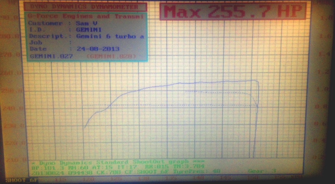

finally got around to editing the dyno graph, was a pretty shit phone pic! I have brightened and enhanced it as best I can so you can see the line!
you'll note the fuel line goes up and left at the end, this is after I lifted the foot.
so you might be wondering why this thing last time made 327hp or whatever .... firstly that was on 18psi and this was only 13psi (I thought it was 15psi so not sure what's going on there) but the wastegate is on whatever I had it on when I ran my 11.29 at the drags, so that's the best its ever gone regardless of boost! ....
also I am running it on E85 instead of methanol, although I wouldn't think that would drop HP as im really not on the limits of the E85 anyways let alone methanol.
