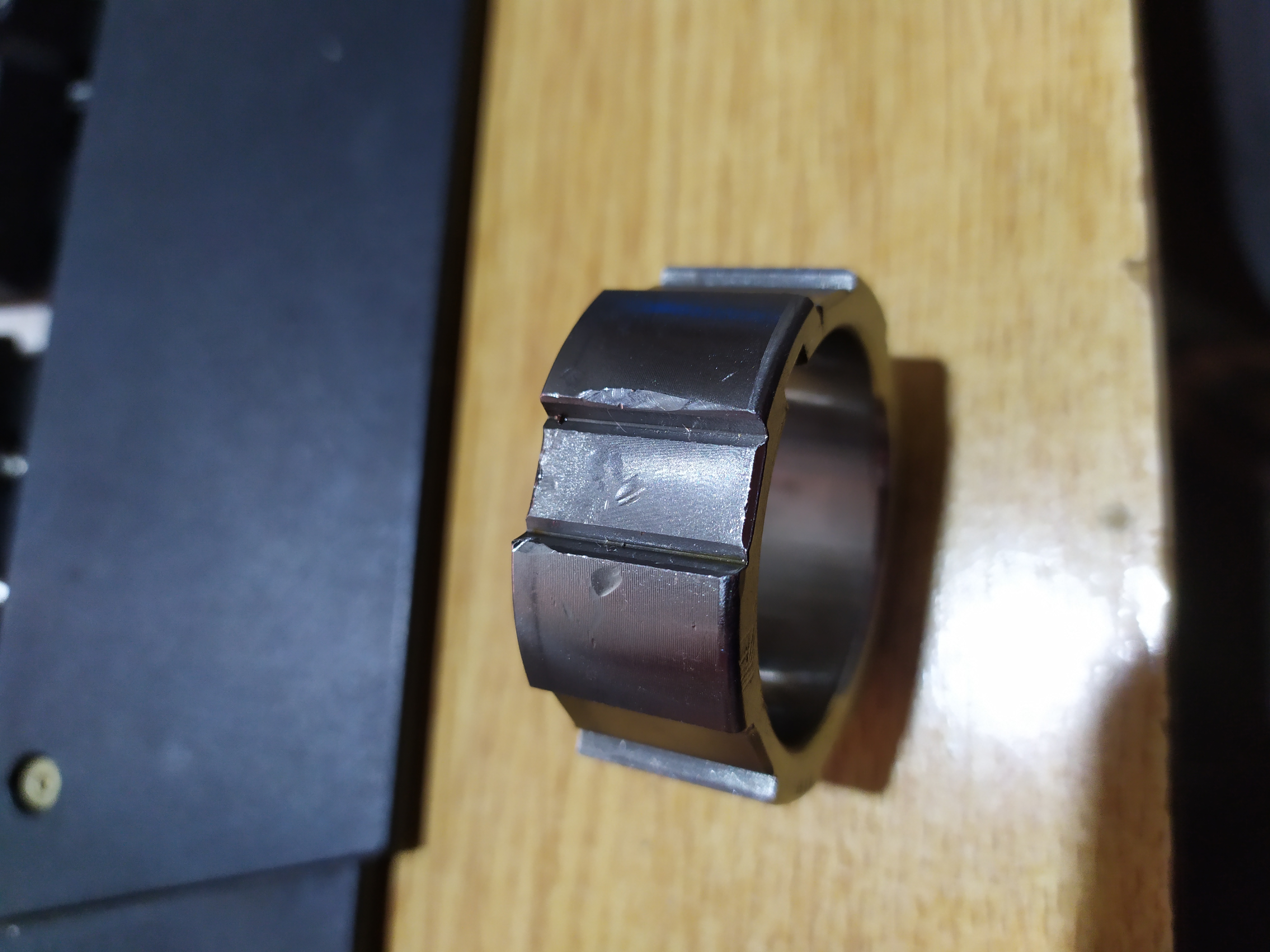

The new crank sprockets are the same as in the RED kit, no markings on them just a dot, the RED kit had the timing markings on it, i think rollmaster will save any money and time they can if they dont have to put timing marks on cause it's on the cam sprocket then why bother, not like they have any competition.

Only the one edge was worn. Def fitted up originally ok and put front cover on ok without force. So not sure why it did that.

yeh there all the same only difference between RED and GOLD is the cam sprocket

Interesting how the better one piece one had a shitter chain. while the better chain one has a shitter sprocket.

Re: The1's Daily
I think there manufacturing is random lol, just make sure the upgraded cam sprocket gets in the gold box, rest they CBF with trying.
