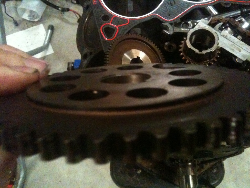

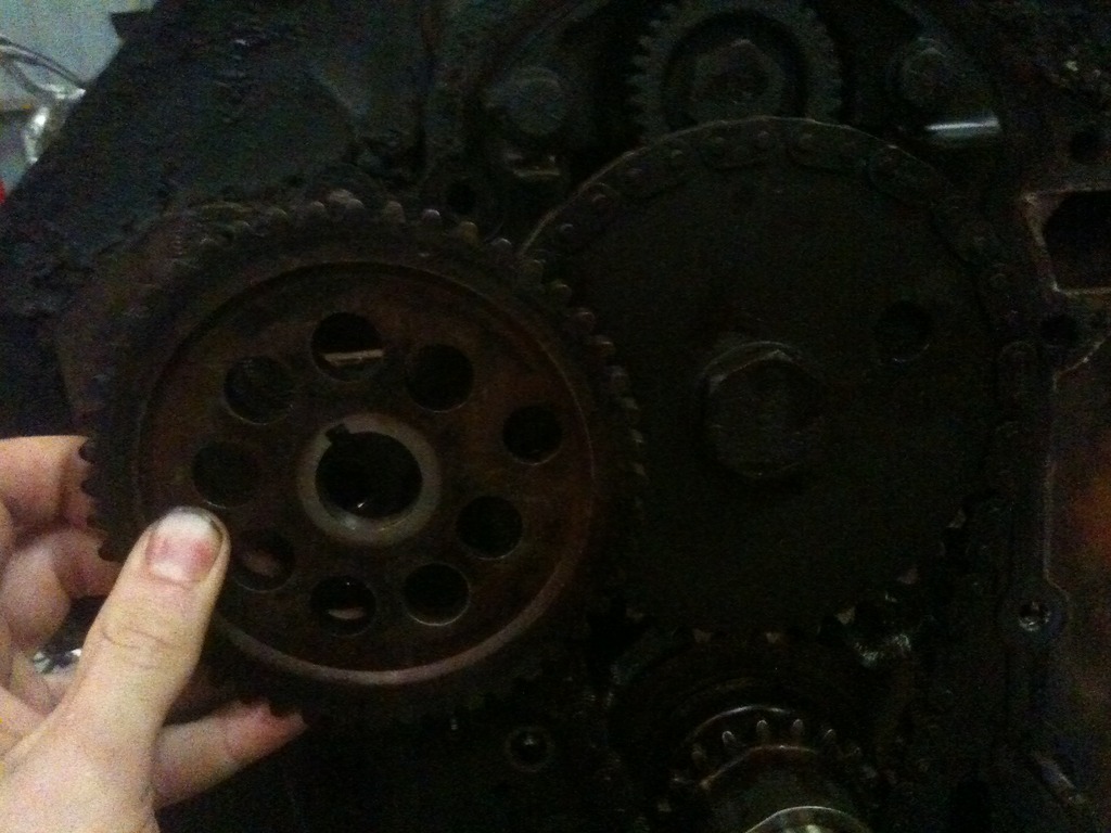

VR cam sprocket vs the VP one on the engine.
The VP one is just flat, VR one is weight reduced and offset teeth.
The drive gear for the balance shaft as well as the trust face for the cam integral of this gear is offset differently to accommodate the VR sprocket.

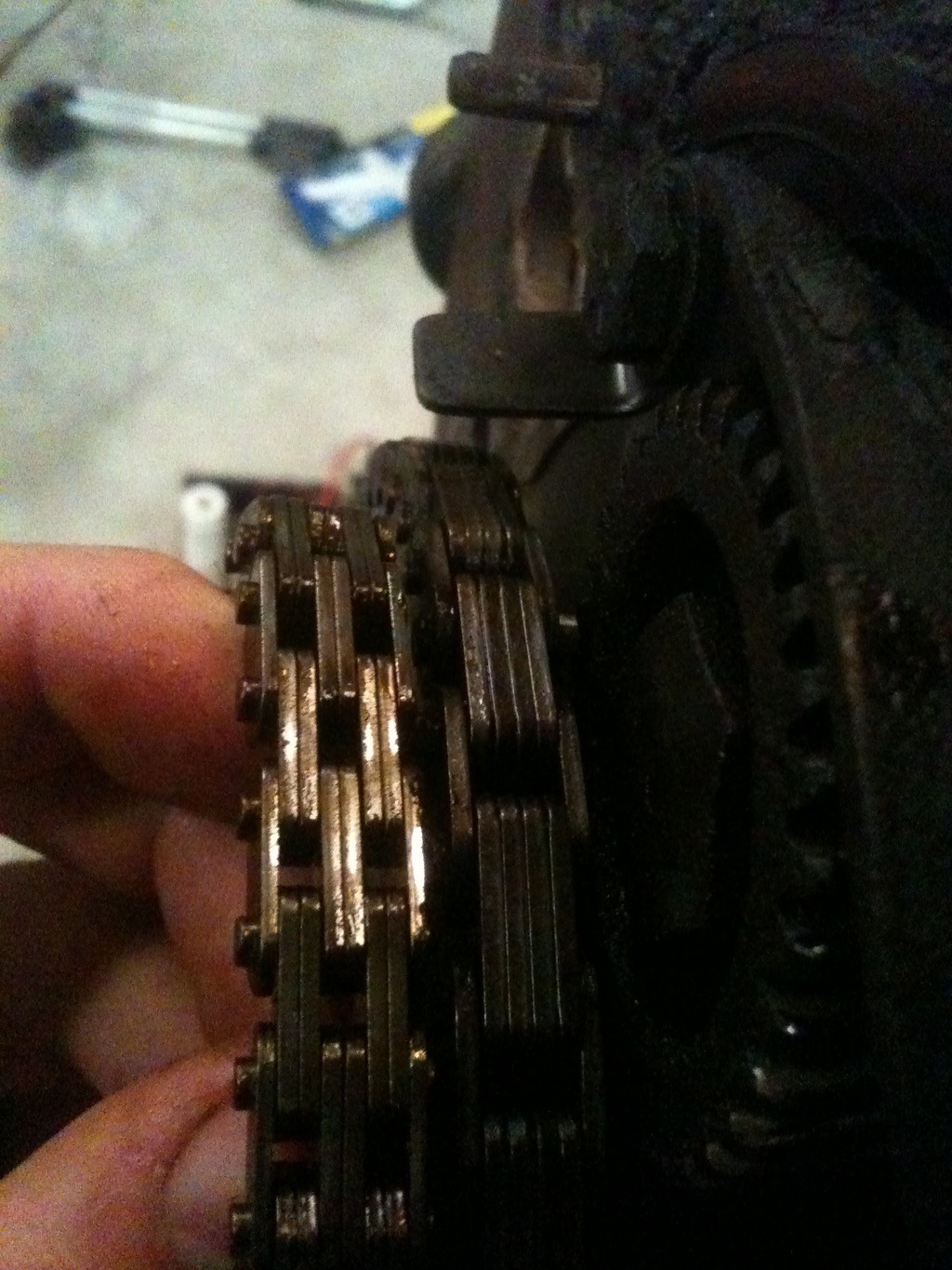

well the chain is wider and stronger and smoother setup on the VRs, same setup as used in ecotec. VR was a crossover in some of the parts used in ecotec.

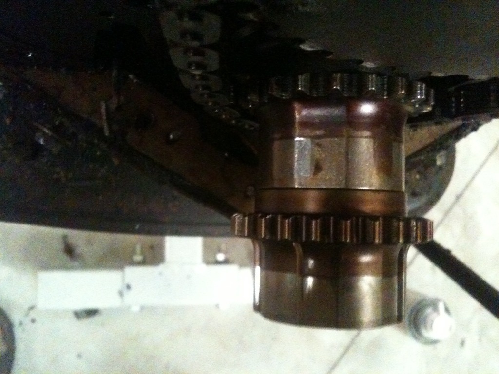

oil pump drive vs VP one, the VP has 2 flats and the VR onward are 6 spline and have wider teeth for the wider chain. The 6 spine drive eliminate chatter and fretting seen of the 2 flat drive.
My VPs current engine makes a horrific "aaawooogggggaaaaaaa" sound ( like those old 20s car horns) on start up from the oil pump inner gear likely chattering on the drive until oil pressure builds to hold it in place.
You can actually see the fretting on the VP one, VR one on the shaft for comparison.

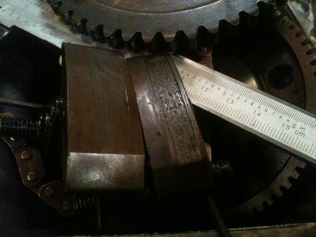

Also the tentioners are different, VR one is wider for the wider chain and also has a heavier spring for more tension.
