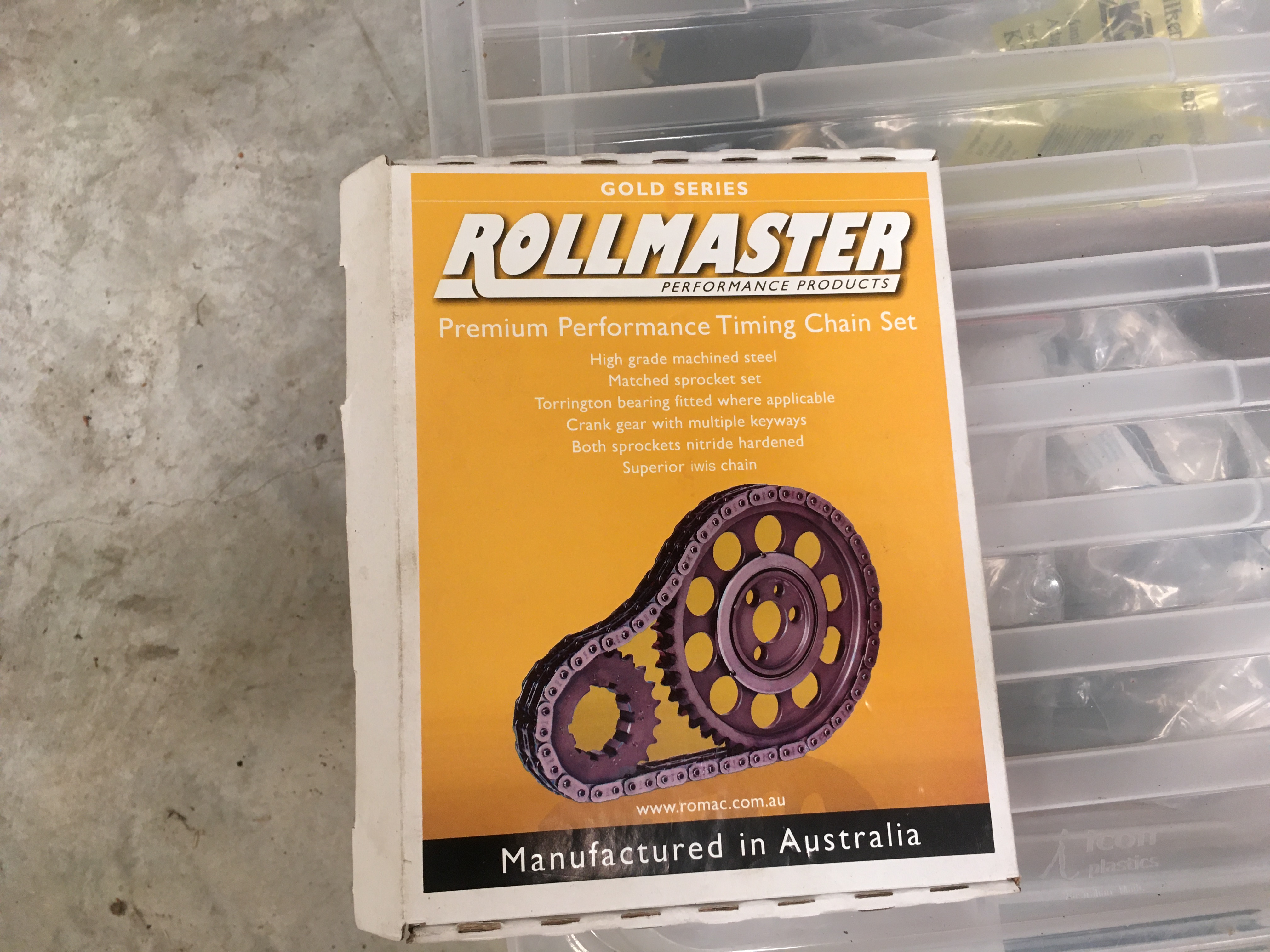

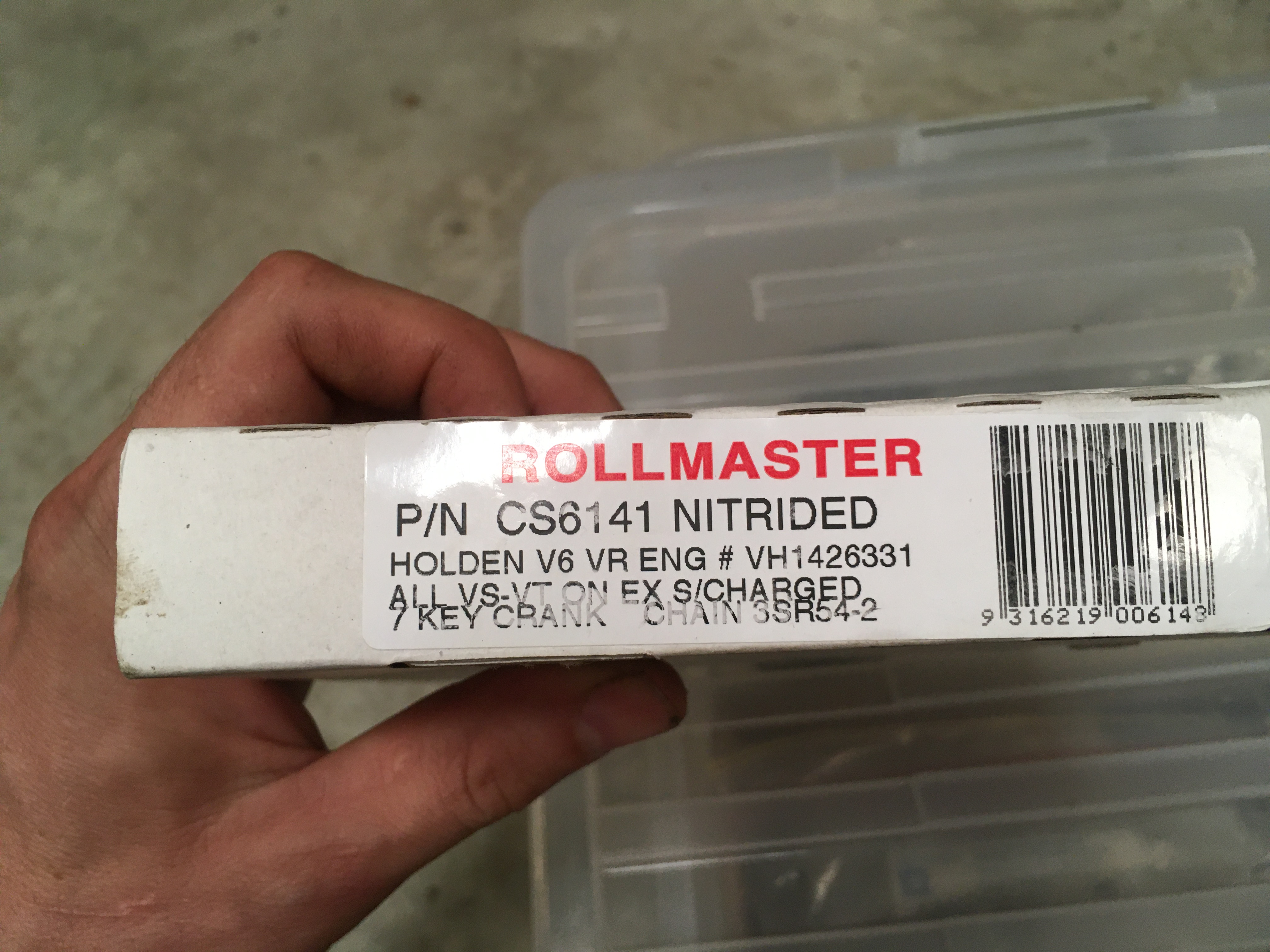

While looking for door handles and central locking actuators in the shed I found this, no idea I had this or where I got it from.
Didn't know they made gold series single row chains. Machining quality looks good on this one, worth keeping for the splined part for when I get the vernier type for the other car.
- Posts: 4852
Re: The1's Daily
So i can't find this info anywhere on the website, but basicly your stuck with RED kit if you want to keep using the magnet.
Hi Nigel,
The CS6240 vernier set is not designed to use a cam magnet.
The CS6150 is made to use the magnet.
Kind Regards
Heather
