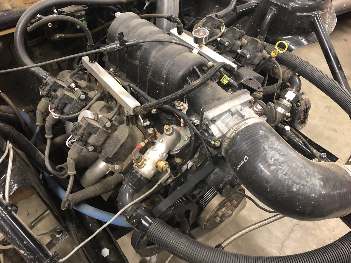

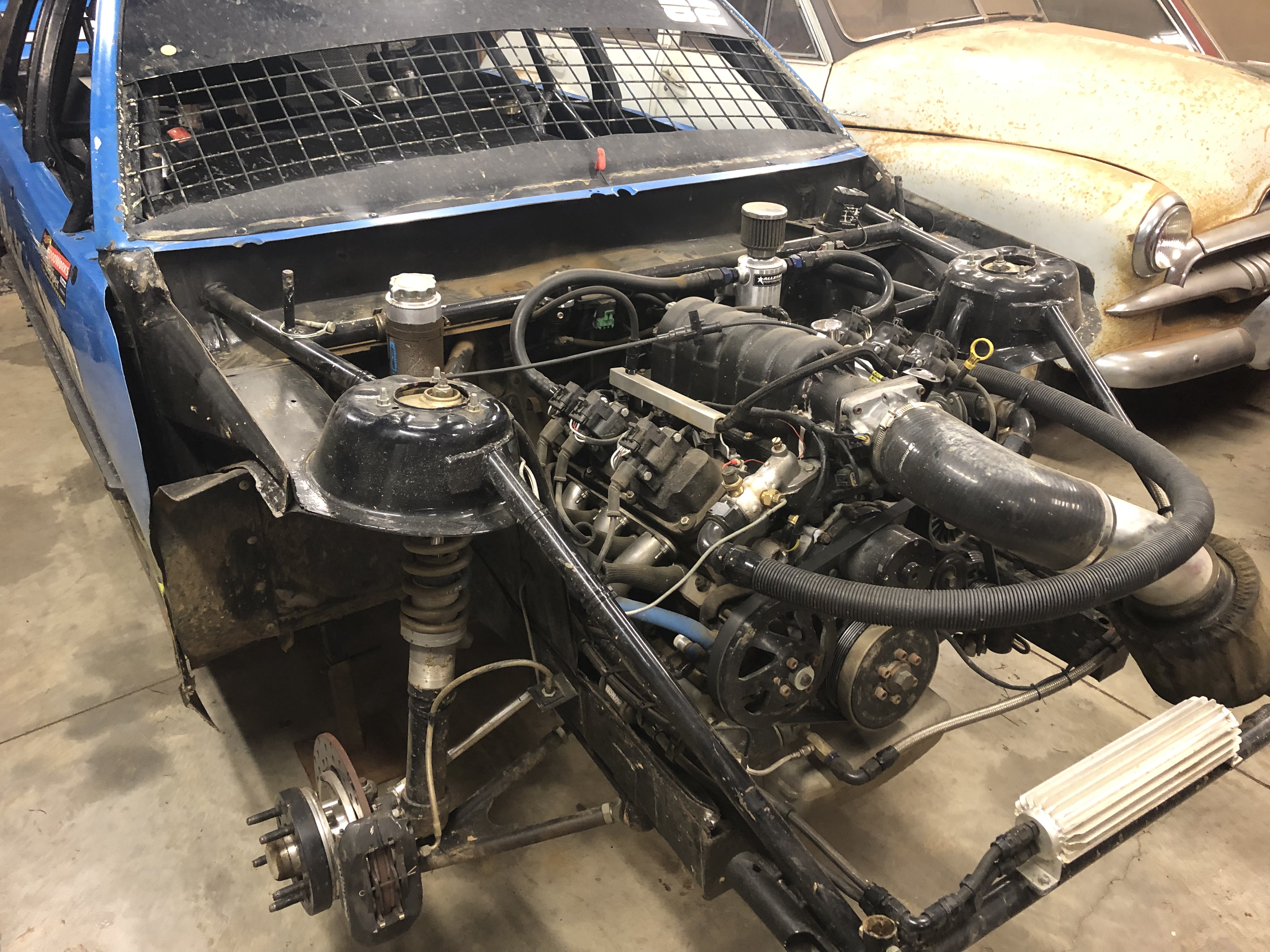

Been a long time since last update so I thought I should share these...
- Posts: 3364
- cars: VR Commodore V8
Re: How to loose 200kgs?....
This thing amazes me every time
- Posts: 8548
need some videos of it screaming, its truly something else
yep definitely need vids!
