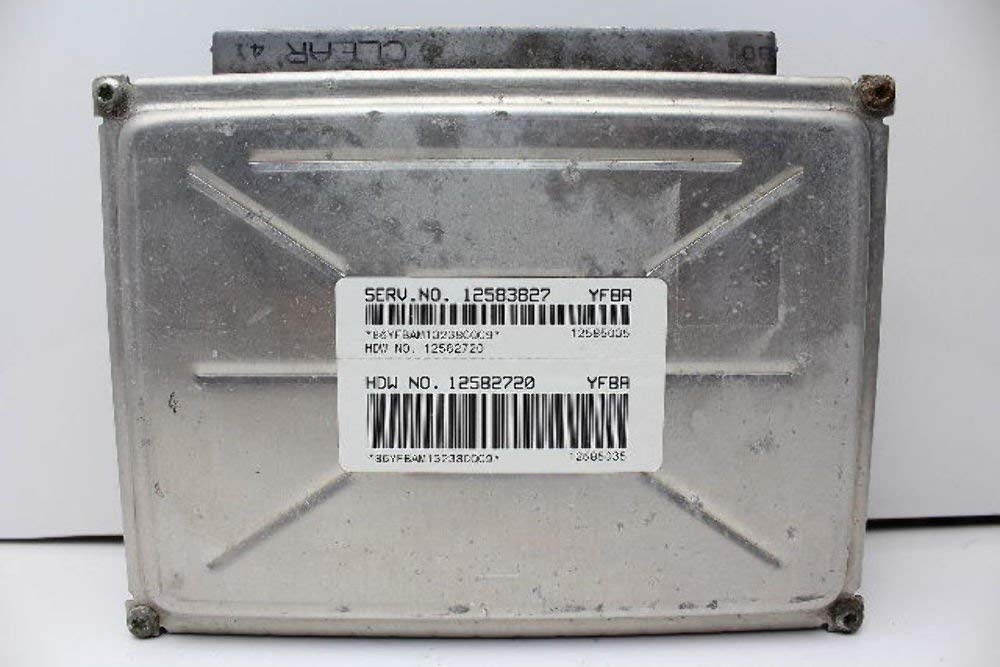

Hi all,
Gampy, here is a picture that shows the "clear" connector label: As Vampyre stated, most any GM front-wheel drive care from 1998 to 2005 used the 3100 or 3400 motor.

Re: PCM Hammer - new ls1 flash tool
Clear as the word ...
Thank you all for clearing it up for me.
just tell them 2000 pontiac prand prix gt, no matter what pcm you get its a P04 because Grand prix only uses that one, other cars use either P04 for for v6 or P10 for 4cyl.
