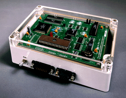

I just picked up one of these AVT-716 that does VPW and PWM, more toys

I forget that the AVT dev has made alot of devices over the years. It literally looks like one of the EECV ECUs or old Holden VT ecus opened up.In-Tech wrote:Shoot, you guys are lucky. Out here in California our local yards wayyyyy overprice stuff.

If that's what I get, it sure is pretty, lol. Looking forward to testing it with the Y cable and his logger

My AVT-716 showed today. Sadly, I may not be able to play right away. If I can get it working, let me know if there is anything you would like me to try.Tazzi wrote:Already done more than enough! Have saved me probably a couple weeks of reverse engineeringIn-Tech wrote:let me know if I can help
- Posts: 10015
It looks like an early AVT prototype, it might need its own thread though so we stop polluting Tazzi's OBDX Pro thread.
