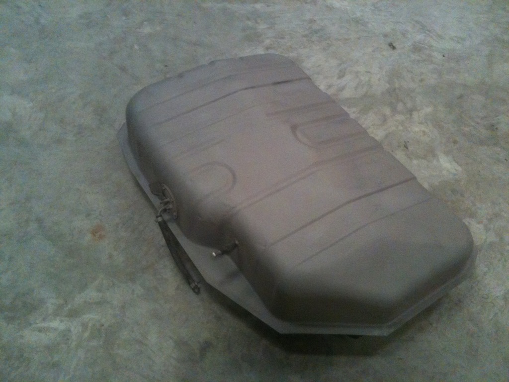

got my a fuel tank blasted the other day. Will get the rust bullet paint like the VR did.

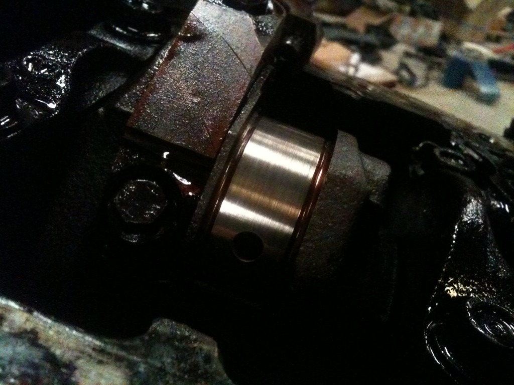

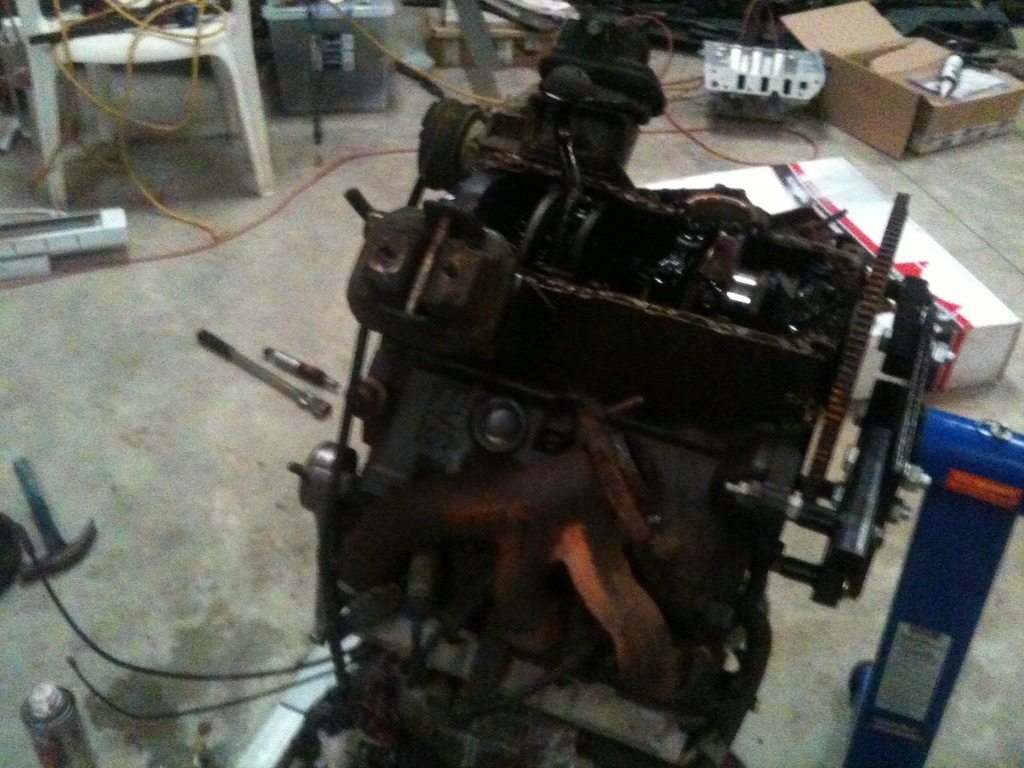

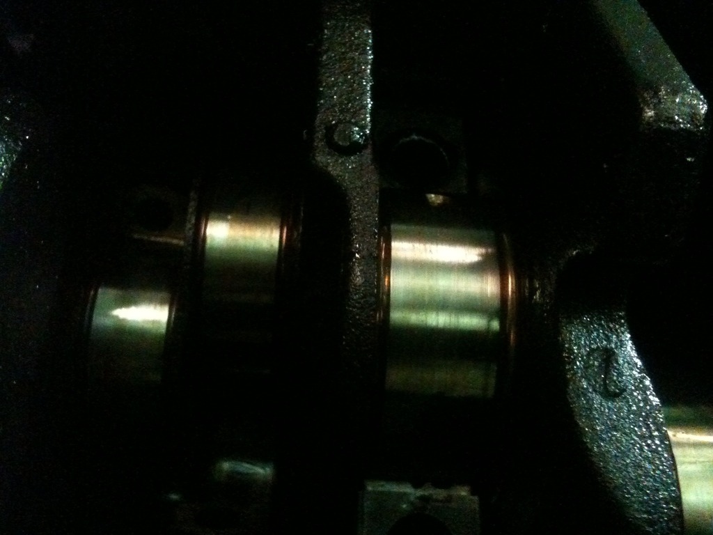

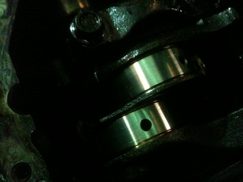

Was raining most of the day. first time sort of real rain in many months! So was a good excuse for ripping the other spare engine open to look at the crank. I was not disappointed

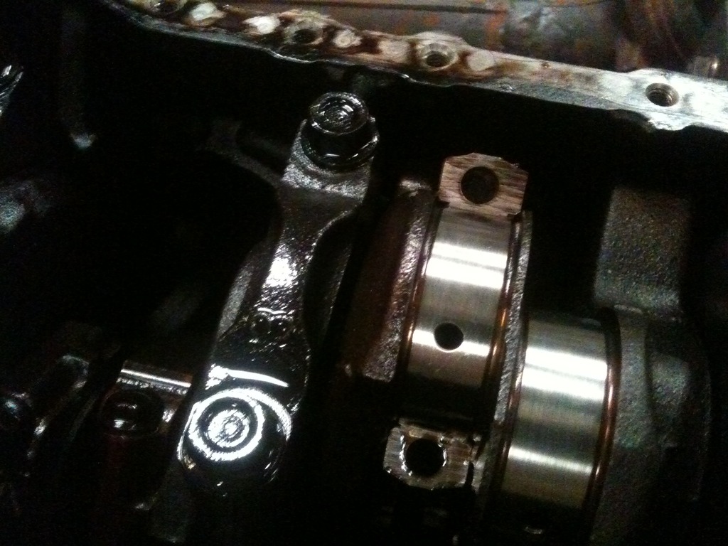

first cap off this unknown Ks engine.
heap better!

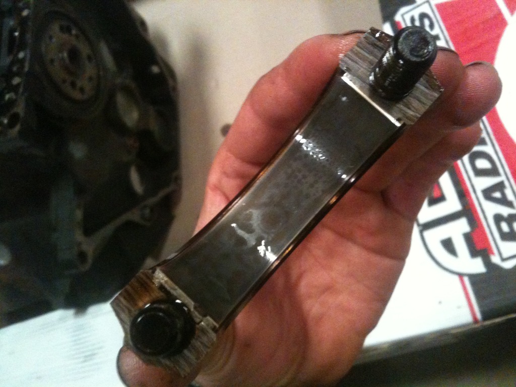

bearings are much better worn on this engine.
front ones.
No. 3 main.
who needs special tools?

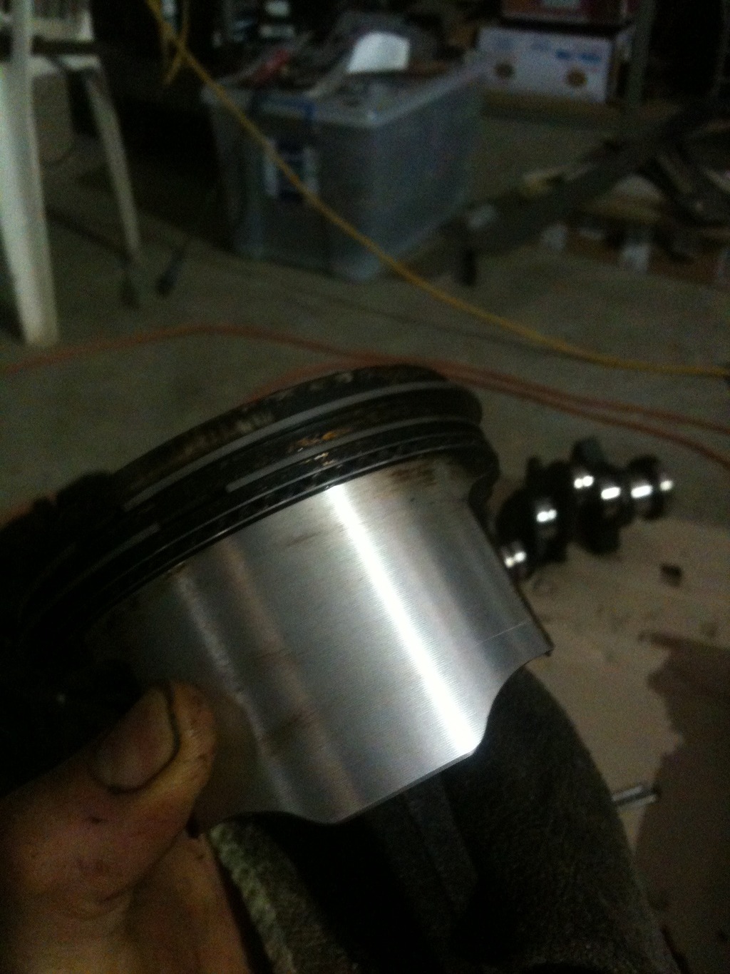

pulled a piston out, pretty good, but no use to me. The bores were bellow average. think water was getting in via the intake gaskets.

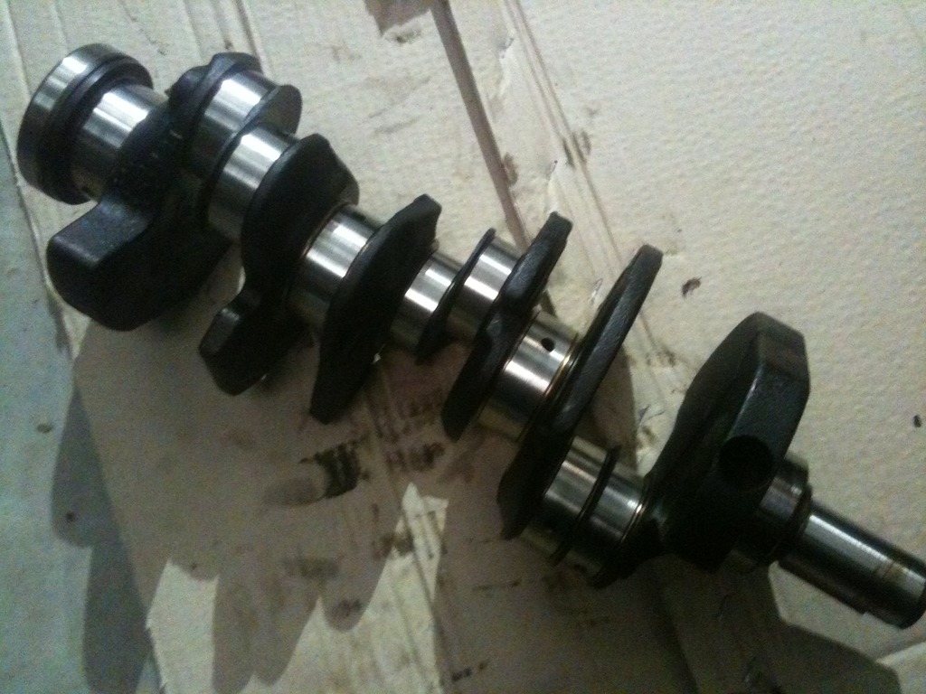

how I have a good crank to work with
The big ends only looks like a polish is needed, mains might get away but probably would want 0.010" grind, only becasue the No. 1 has some light but smooth grooves in it, far less than the other crank anyway so its win win.

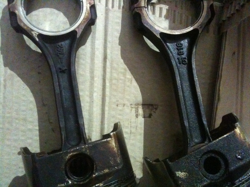

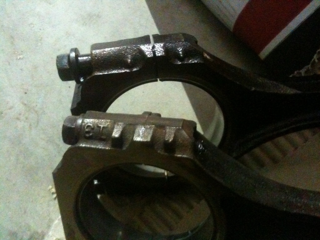

And some differences in the rods, late one left, early right. The late is a better looking casting and slightly beefier in some spots.
early top, late bottom.
heap better!
front ones.
No. 3 main.
